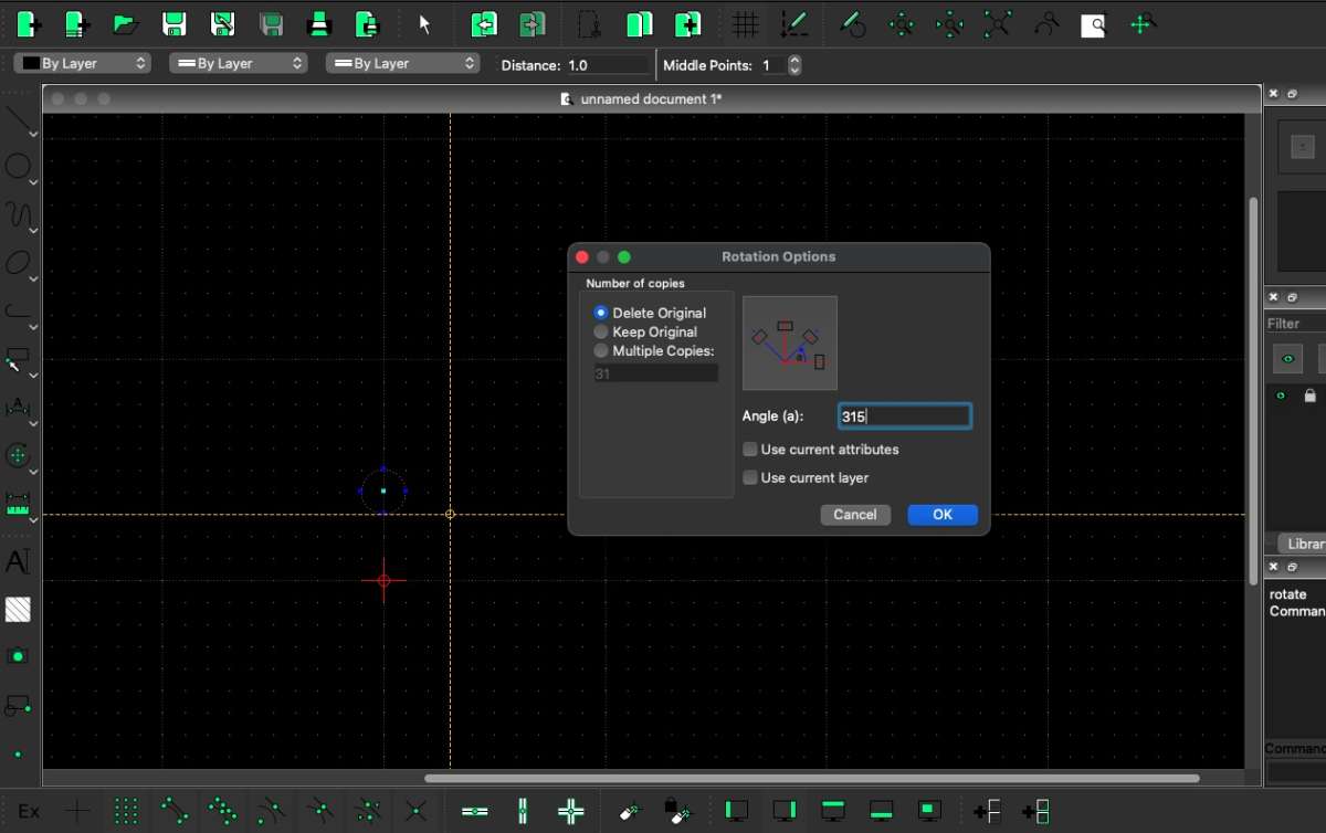

      I want to use the LibreCAD software to draw a ring of objects (just reference points). When I had access to Turbocad there was a drawing method that did this called Array. Using Fit Radial Copy gave the ring of objects. The best description is that it looks a bit like a clock face.
      So far I haven’t managed to figure out how to do this so any suggestions would be most helpful.
      #831499
      Dave S
        @daves59043
        I think the Rotate command will do what you ask.
        type rotate, select the thing, select the centre point, then the dialog will pop up.
        select the multiple copies option, fill in the number of copies, and in the angle box type the angle between them.

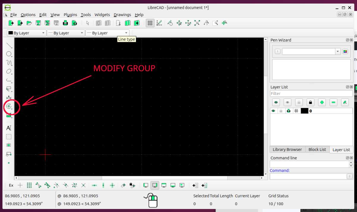

            Dave, having difficulty finding Rotate.
            My version iv 2.2.0.2, wonder if you are using the same.
            Perhaps it is just the way my programme is set up.

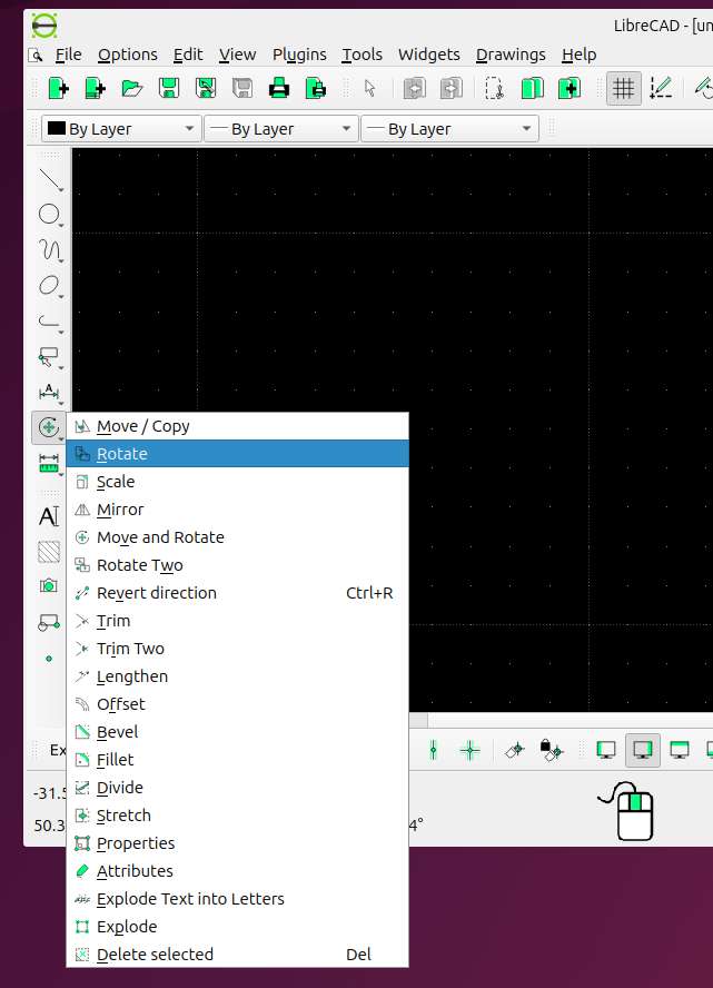

            #831657
              Rotate is in the Modify sub-menu:
              Screenshot From 2026-01-07 16-41-25
              Clicking on the Modify button should list all the modify commands, on my machine ROTATE is near the top:
              Screenshot From 2026-01-07 16-42-08

                I just type rotate into the command line on the right hand side.
                Actually I just type rotate and it appears there
