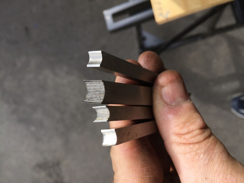

      I have been sorting through a mass of lathe tools and discovered these. Can anyone shed any light on what these might have been used for.
      They have these annotations on them.
      #18599

          they look like what sits for making do dah's that attach to the thingamy jigs
          seriously though I'm interested myself

            Could they be form tools that would produce a partial serrated ball end on a screw for example? the plain ones would make the radius and the serrated ones the serration?

              Form tools for either shoulder rounding or ball roughing.

                I cannot offer a better suggestion than form tools but if they are, how were they produced in the firts place.
                I can see how one could grind a plain concave radius, but how would the groove cutter be created?
                A grinding wheel dressed to the correct profile would surely not last long, but constant redressing does not seem to be sensible manufacturing method.

                  I think it might be a milling cutter which cut the grooves onto it. It's machined rather than ground.
                  There are grooved grinding wheels that they use in the cutlery manufacture for making the grooves onto butter knives. So I could be wrong.

                    May be shaper tools for making the grooves on thumb latches for tools or guns.
                    If from 1940's-1970's probably made on a profile grinder.
                    If from later than 1970's could be profile ground or wire edm'd. JD

                              Definitely form tools, and they will only make sense if you know what the shape they form was used for.
                              They make some sense in the context of being with those specialised WD tools.

                                How about the tools to put serrations onto the end of round bar. Used in a shaper or slotter ?

                                    They are form tools for turning YGIAGAM’s (your guess is as good as mine) and are ground on kit like this:>>
                                    **LINK**>>
                                    Of all the jobs that I did while in the tool room I found grinding this type of tool the most challenging. Imaging trying to turn a complex profile on a lathe by hand and eye using just the cross feed and the saddle traverse instead of using a profile guide pattern and you will get the idea! – nightmare! >>
