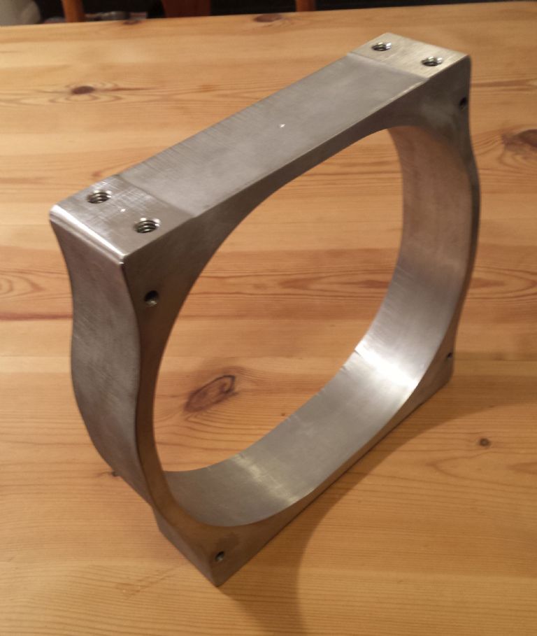

              I have just picked up a part cut from 2" thick 6082T6 and the taper was less than 1 degree. Over the 2" the taper size difference was about 0.5mm. It being anodised now otherwise would measure it.

                This is the part I had waterjet cut before I sent it for anodising. I cleaned up the bore with a flap wheel (cylindrical type) but apart where I have machined the mounting surfaces its more or less as I received it.
                The ovoid shaped bore is about 220mm wide

                  That´s way better than mine was, it has almost 1mm of taper on a 15mm thick part!
