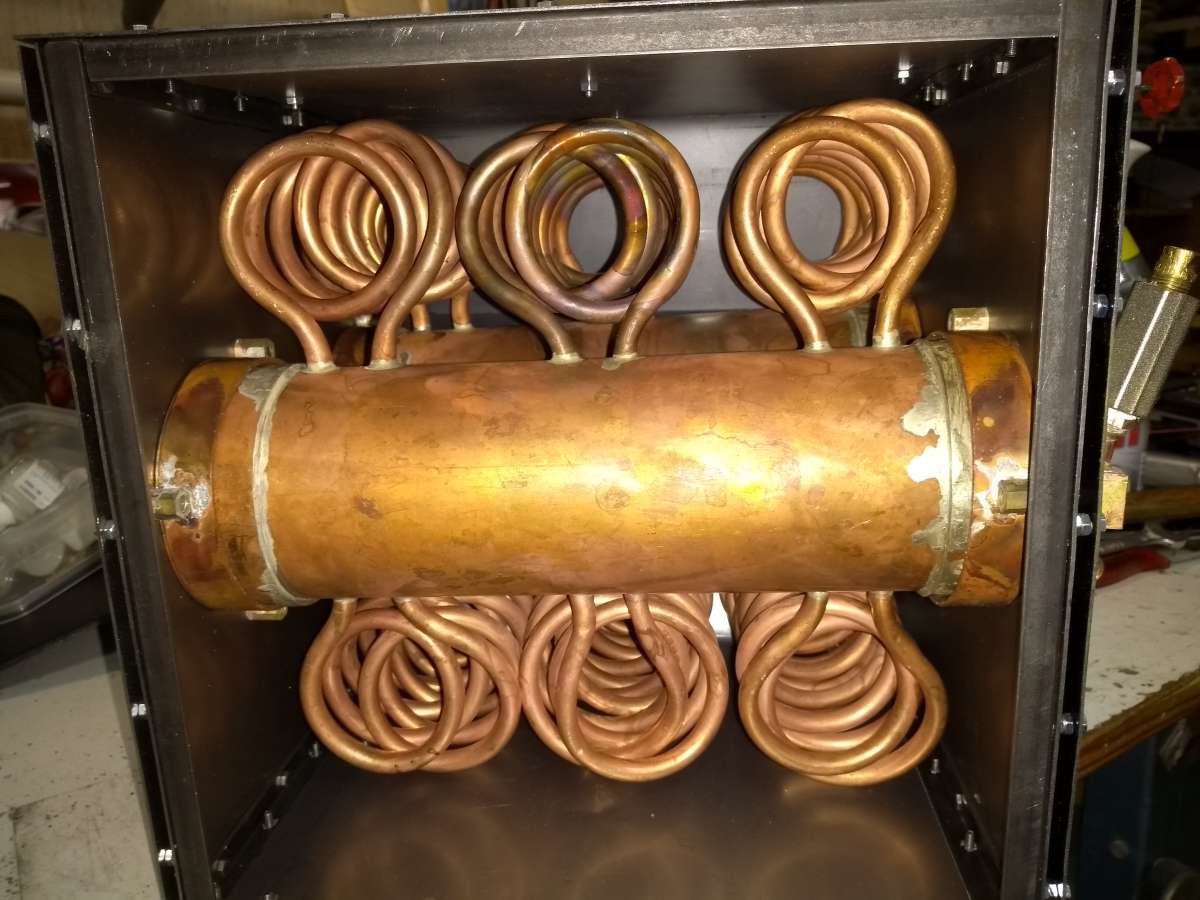

                    my boiler is a dual drum boiler
                    IMG_20230809_170108077

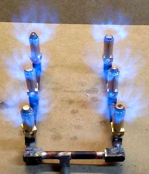

                    This view is from the downside of the boiler housing and under each coil is a homemade low gas pressure burner located. They look like this
                    6 Brenner_cr

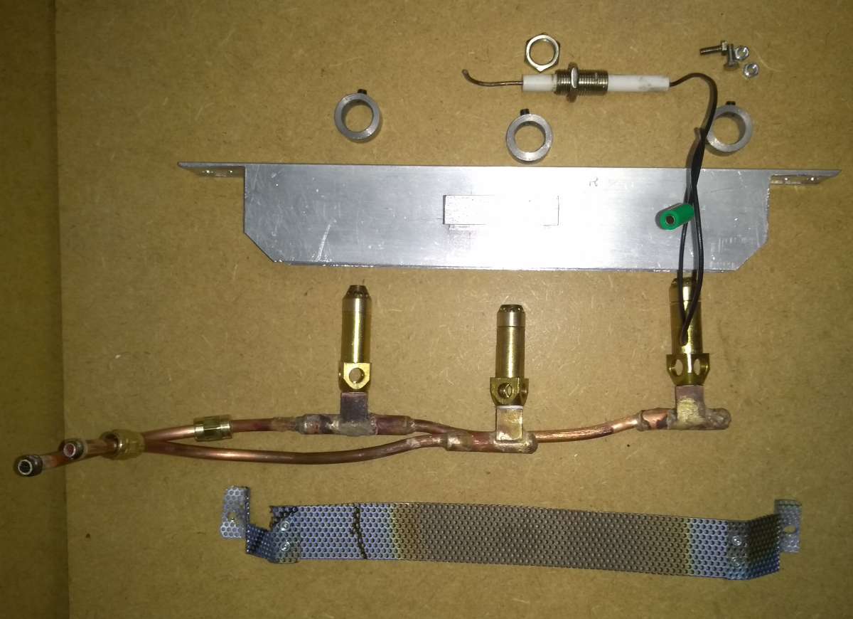

                    This is a picture of the first try, but they were sensitive to wind and not comfortable to install. So they  were changed to this easier to install and changed to an exact distance from the ignition electrode to the burner so all it can be checked before installing in the car. The layout in total is now 2 burner with ignition electrode to start and 4 additional burner for to drive. They are located direct to the coils. There are in total 12 coils with each one meter of lenght by 8 mm outside diameter.
                    IMG_20240311_154505101_cr
                    The  U type aluminum holder, for the burner, shields them from wind and the stripe with the holes, from an old loudspeaker, shields them perfect from wind effects. The burner are for 50 to 100 mbar gas pressure constructed.
                    The last setup is for driving faster uphill an addition of 4 burners. They are more located to the mid drum and are only burning if I push a button. So I have a power modulation of 2 , 6 and 10 burner and this is controlled by an arduino with automatic ignition and gas valves for burner and power control and an electronic pressure transducer to sense the boiler pressure. The fan is controlled in addition. With latest software never the saftey valves are in action the burner control cuts the power before they came.

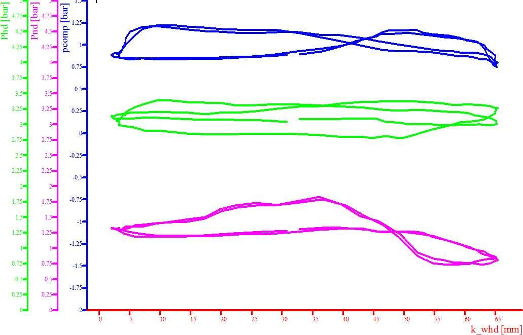

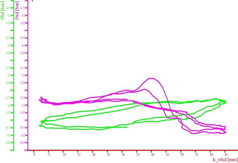

                          While driving up the flood barriers, I got the impression that the steam engine was running a bit smoother under full load a some time ago. By then, it had 493 km on the odometer. I suspected that the valve timing wasn’t optimal. This effect is most noticeable under full load and less so at high speeds.
                          So I decided to install my pressure and displacement measurement system on the steam engine. Piston stroke is measured using a potentiometer with a cable pull. The sensor is homemade. An identification card JoJo provided the return spring, and the potentiometer drum was wound with steel wire from a tethered glider. The sensor measures with surprising accuracy, though that isn’t strictly necessary for this application. Cylinder and compound vessel pressures were measured using pressure sensors from the Chinamann. the data is collected by an arduino with bluetooth transmitting to a laptop. On both computers are running my self written software. It turned out, as I had subjectively observed, that the valve timing had shifted. Here are a few impressions of the measurement process. It’s quite an adventure to drive the vehicle like this, hold the laptop, and still get something on camera—all while doing it solo. And important looking to the traffic on the road!
                          https://youtu.be/WSl6-BMeWLY
                          Please switch on the subtitles while watching
                          The diagrams are, the first one is both cylinders in full power mode with high pressure on both cylinder. In y direction is the pressure and in x the piston displacement to see. Green is the high pressure cylinder and pink is the low pressure cylinder switched to high pressure mode.

                          The second diagram is the compound mode. The blue curve is the receiver pressure, the green one is the high pressure cylinder and the pink one is the low pressure cylinder. It is noticeable that the pink curve is not optimal , because the valve close to early and open too late.
                          xy verbund
                          After the drive, the cylinder heads were opened, and the valve clearances showed a correlation with the measurements.
                          I made then a test ride and I was astonished how long it last that the engine runs good again. I cleaned the oil in the valve box to see the valve timming clear and after setting the valves new I looked that there is enough movement of the D valve for condens water to let it out. It seems to be that there is after that there have to be some new run in. After 3 kilometers driving with spending the oil reservoir of the pump it runs then better as before.
