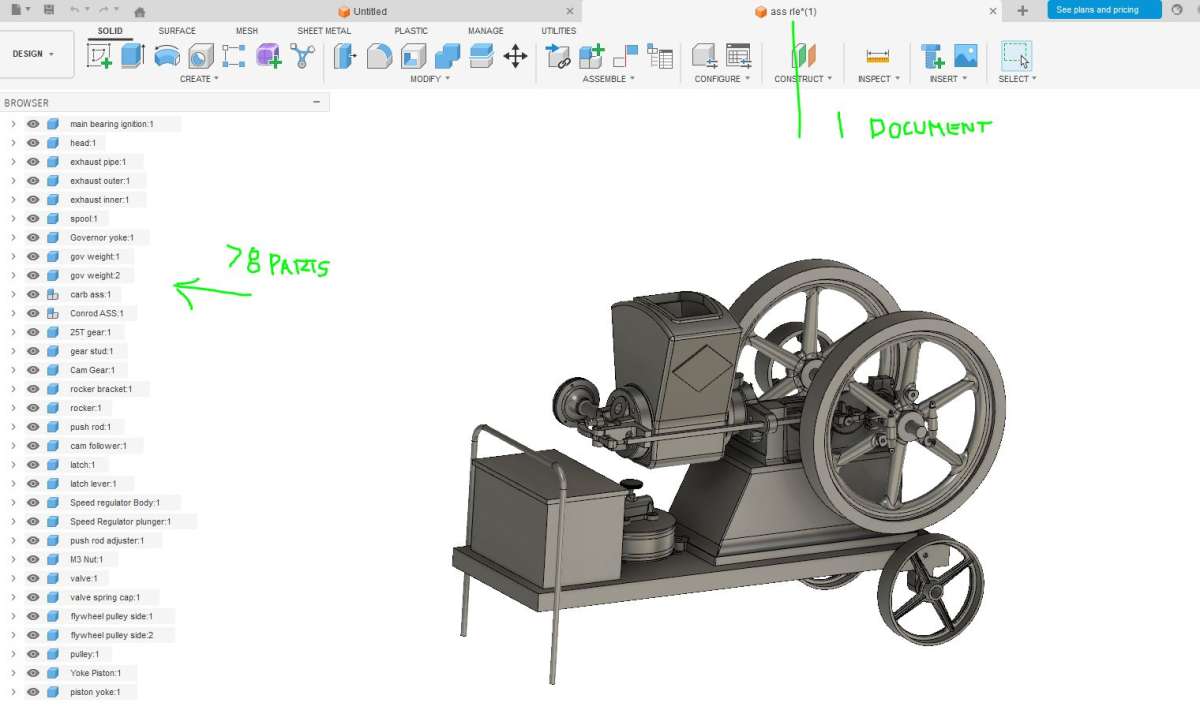

            As I said Dave any file are “document” can have as many individual parts as you want and all are actively editable without doing anything. You could quite happily have 1000s of parts in each document so plenty to do what the OP wants which is model 00 gauge locos. He could have 10 complete locos active and as many more as he wants just a click or two away from becoming active.
            Example here of a small hit & Miss engine, it is just one file/documnet but there are 78 “parts” to it. So you could have ten enigma type documents all instantly accessible and active at the same time.
            78

                  Dave, you’re misreading the details about the F360 10 limit. It’s ten editable files at any time, not parts, and you can alter which ten are editable.
                  This is only a ‘problem’ if you create each individual part as a separate file instead of the whole job(like the chassis I’ve shown several times) as one file made of individual components within it. Doing it as separate files would be like your word processor wanting each paragraph of a novel to be separate, which is clearly ridiculous!
