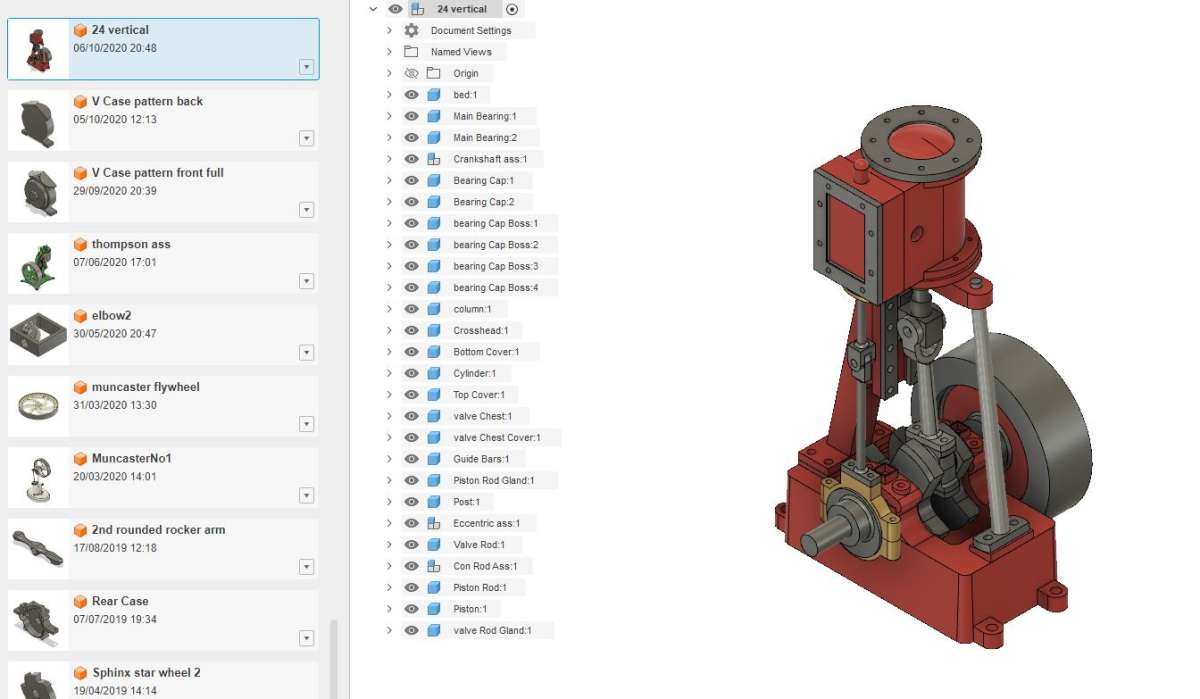

                                        On SillyOldDuffer Said
                                        SE is harder to learn than Fusion360, but F360’s community edition has a 10 part limit that’s too low for me.  Freebie F360 is great for small projects, but not if you exceed the limits.
                                        This is not Correct.
                                        You have a limit of 10 actively editable files. You can have loads more files and those files can be individual parts or contain many parts. So quite possible to model every item in a loco of OO scale or larger.
                                        It is quite easy to close an editable file and open another so it can be edited should the need arise so really there is no limit just a bit of an inconvinience that is unlikely to be a problem for a hobby user.
                                        Here is a screen shot of my non commercial (free) Fusion F360 screen. Down the left are 74 different items. Quite a few of which are complete assembled engines like the one shown on the main screen listing all it’s parts and sub assemblies down the side. I can work on any one of those if I wanted.
                                        many

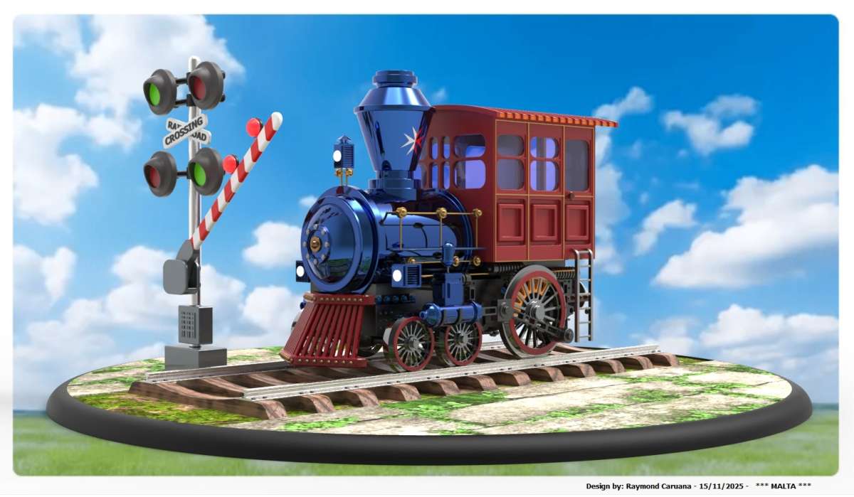

                                              As that probable contributor on here, I feel I should correct David slightly by pointing out that MoI is very much intended for mechanical design. 😉
                                              It’s a powerfull NURBS Direct Modeller with fairly substantial surfacing capabilites which aren’t typically available in its price range, but what it doesn’t have is assembly and constraint capabilities. However, by use of its excellent snap system and along with its transformation tools it’s pretty easy and effective to move and reposition parts to check for interference and mobility.
                                              One of the developer’s goals is to keep the interface as easy as possible to interact with by making each tool usable with curves, solids, surfaces and edges, so no swapping tools when moving from one thing to another – you also won’t find any ‘road block’ error messages.
                                              I think MoI of as a ‘manual’ rather than an ‘automatic’ vehicle which takes you to your destination, but just needs a bit more input from the driver.
                                              Never the less, Moi is well capable of solid modelling a locomotive.
                                              This isn’t my model, it’s simply the first locomotive I came across in the MoI gallery.
                                              RC Maltese Train 1a
                                              Martin.
