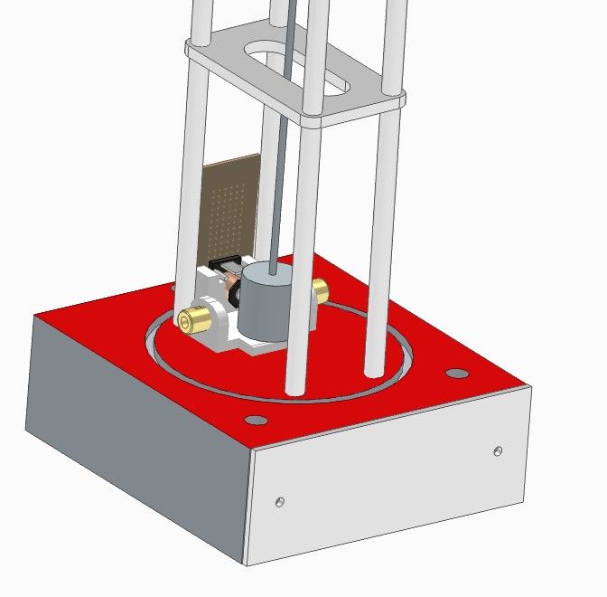

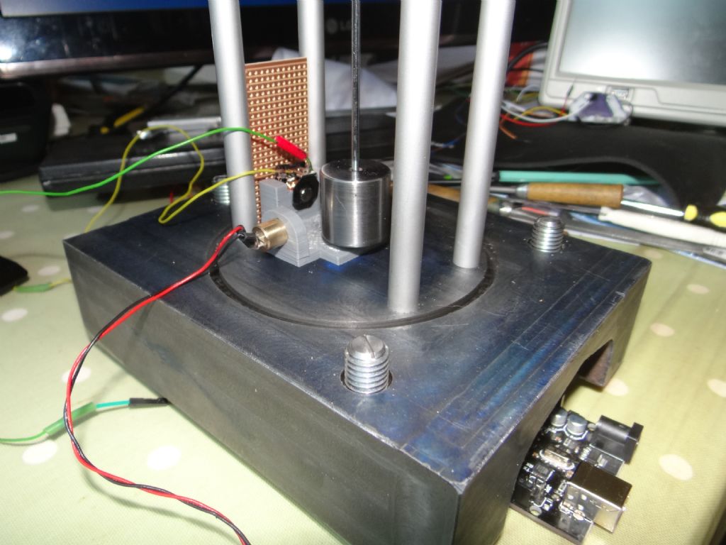

      It's not clear to me whether the above board includes a focussing lens. I think you'd have to arrange for the pendulum rod to fill the field of view all the time, otherwise it would be sensing the temperature of the background (containment tube when it's fitted, rest of the word when not). It could probably be sorted, but the proxy rod is more straightforward
      Most unlikely to be able to add a focussing lens … [they are expensive at the relevant wavelengths]
      I had assumed that filling the field of view with the pendulum bob would be quite simple … although I don’t recall what arc of swing Dave proposes to use.
      Although using a 4" soil pipe as the vacuum tube creates more space, it's still cramped inside:
      The pendulum is intended to swing up to 5 degrees, so the bob can never be more than 40mm from a sensor. The obvious place to put the IR thermometer module is between the pillars opposite the electromagnet. Could be done, though it means another wire has to penetrate the vacuum seal.
      Space for a dummy pendulum looks tight as well, maybe the easy answer is an Invar rod…

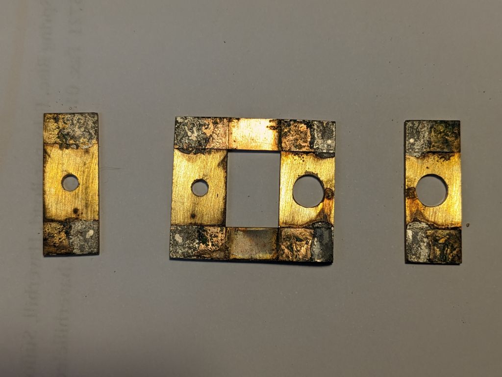

        This is why I need to improve my soldering!  Having made a new single-spring design which promptly fell apart and needed re-soldering, without much prompting the old one did too!  The idea is to get the small gap between the chops completely filled with solder so the length of the spring is completely defined by the edges of the chops.  The problem is if you get too much solder between the cheeks it tends to bulge out on to the spring at the edge.  In this case the springs have hardly "wetted".  So I need to be able to put enough solder paste on to the job when assembling into the soldering jig and also apply resist on the spring to stop it spreading.  I have a plan…
        Edited By John Haine on 20/04/2023 09:21:59

          I was too cowardly to solder mine so the spring is clamped with M2.5 nuts and bolts. The rod top weighs 9g, the rod 8g, and the bob 95gm, total 112g. As the pendulum will swing about 40,000,000 times a year, I'm hoping clamp pressure is enough to stop the spring from moving!

              Solder paste is not a good option as it contains too much 'other stuff'. Since all mating surfaces should be jolly flat tin them and while hot wipe off the solder (dampish cotton cloth). Then hold bits in alignment with a jig / clamp and heat the whole lot up making sure the clamp pushes the joint together firmly.

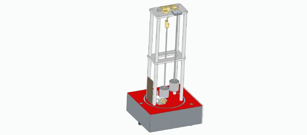

                  Joy of CAD shows there is room for a dummy pendulum, so both methods are do-able. There's enough space for the fake bob to fit between the swinging real bob and the pipe. Just a simple mock-up:

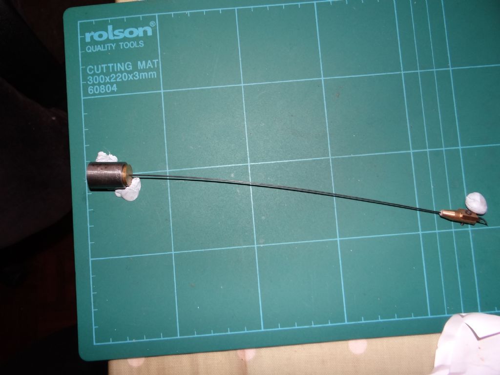

                      Going back a couple of years, my original idea was to use a thin carbon-fibre as a spring – no suspension at all. Not satisfactory because:
                      • Carbon fibre rod is humidity sensitive, because (I think), it affects the springiness of the plastic matrix.
                      • When a conventional spring is inserted, the fibre-rod twangs, which I think explains some of the variation in my pendulum's period.
                      The fibre is bendy!
                      So I've switched to steel, assuming that the existing software temperature compensation would cope with it. In true time-nut fashion, that led to the realisation that it's the temperature of the rod that matters, and how to measure it. Plus the rod is well-insulated and will lag behind ambient by some time because it's heated by a circuitous route.
                      I don't intend to tackle the problem until running the clock in a vacuum shows this to be worth fixing. It's possible the clock and pendulum have so many other faults that this one will be undetectable! An Invar or much thicker fibre rod is also on the cards. It's all experimental!

                                          Based on what I found with a single rod, there's a tendency to twist when the bob is impulsed, perhaps because the magnetic field isn't quite aligned with the bob's flight path. Although better engineering might fix this, in a two string swing there's very little to stop oscillation around the Z-axis. Gut feel is strings have more degrees of freedom than a stuff rod and that a flat suspension spring at the top is better at resisting and correcting Z rotation. No numbers backing me up though!
                                          Tradition doesn't help. Most pendulum clocks have rod supported bobs, but maybe that's because they're usually impulsed at the top, and top impulsing a string hung bob wouldn't work. As I'm impulsing the bob at the bottom, maybe a child-swing type pendulum would be OK. Got to be worth trying – more work!
