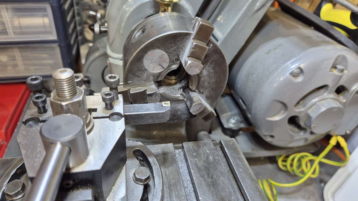

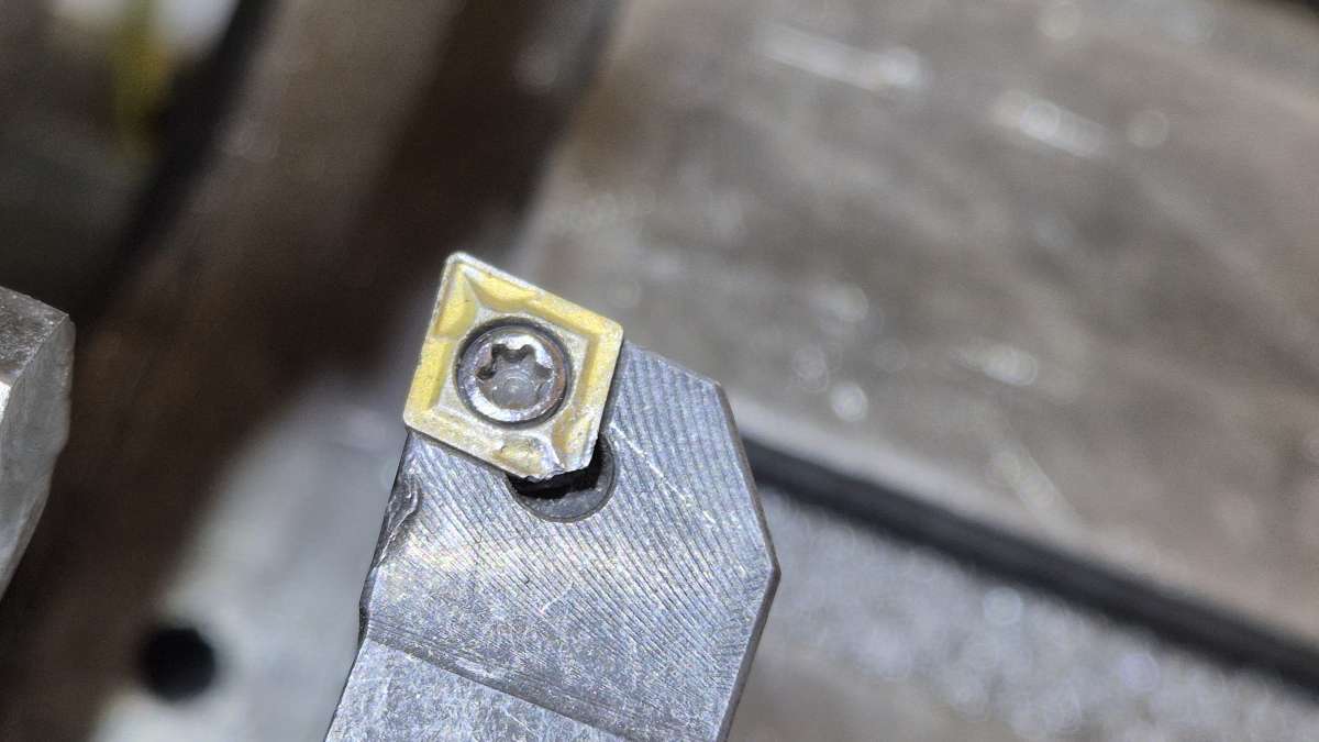

      I have a Myford ML7 which I bare metal stripped and re-furbished a few years back, As most of the original cutters had seen better dys I fitted it with a Chronos quick change tool post and a set of these tools
      Even turning a soft aluminium bilet I have found the tips break or shatter within a few seconds and no, I am not being rough with them
      Am I doing something wrong or are the tool tips just rubbish ?
      The tools seem quite popular so I am guessing they are OK

        Holders should be Ok. But if that is what you bought 12mm is likely too tall for a Myford Supplied tips maybe less so but even cheapies should be lasting longer.
        Check the tip of the insert is dead on centre height.
        Invest in a few **GT inserts which are better for non ferrous, buy from the likes of APT but sort out why yoi are damaging them first. Post some photos or a video of your setup so we can see what may be wrong

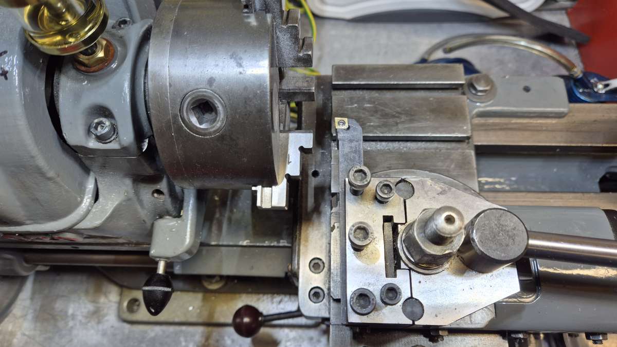

          I have set the tool tip to be a fraction of hares breadth below centre –  turning to the middle leaves the thinnest hair of a spike which can be snapped off with a finger so that all seems OK

                  Be sure cutting edge is definitely not below centre line at contact point. Carbide must not be subject to any tension (pull) component of force.  Check for absence of even slight downward tool deflection from applied cutting forces, which could put tip into tension. Rigidity is vital! In the end, though, poor quality carbide fails much more easily than that from premium makers. See if you can find suitable (eg Sandvik) inserts on the Internet.

                    The tool looks to be standing out a fairly long way, so might be vibrating.
                    Also a QCTP is little less rigid than a four way (More overhang from the clamping point)
                    Reduced rigidity is likely to allow the tool to move which may account for your shipped tips.
                    Try again with minimum tool protrusion and see if things improve.
                    Carbide tips were developed in industry to maximise the rate of metal removal, so the limitation on your ML will the maximum speed that the plain headstock bearings can tolerate (But I always felt that my ML7 was not sufficiently rigid) It seems unlikely that 7 Series machine will have the power and rigidity to stand the speeds and feeds employed in industry, so tend towards caution than turning off clock springs!
                    A carbide tip will function quite happily with small D O C and fine feeds.
                    I use carbide tips in a larger lathe for roughing, boring and radius turning without chipping, other than when I am careless, so maybe fine tuning procedures might improve matters.

                      pretty certain they are aligned properly….like I said they leave literally a hares breadth of spike at the centre, no more
                      I would prefer either the indexible tools (like I have) or the brazed tip ones that I used to use
                      Dont know about the downward deflection….like I said they are cutting soft aluminium so I wouldnt have thought there would be much resistance or drag

                          Initially, I had problems with chatter because of excess overhang. so keeping the tip as close as possible to the toolpost cured that.
                          I always set any tool to centre height, to avoid problems (Which is why I suggest newbies making a Centre Height Gauge as an early project)

                            I guess the issue is caused by the soft pure or low-alloy aluminium forming a built-up edge on the top of the carbide insert. You appear to be using coated inserts. You should be using highly-polished uncoated inserts for aluminium. Chatter or small depth of cut can make matters worse.

                              The first job I did after recommisioning my machines after being in storage during the workshop build in 2016- absolutely essential, but never bothered with one before in 55 years in engineering !!
                              The next important mantra to remember is –
                              Overhang!! Overhang!! Overhang!!
                              Of tools from the toolpost and workpiece from the chuck jaws, mimimum practically possible is eesential.

                                  Absolutely nothing wrong with using replacable carbide tip tooling on an ML7. I use them a lot on my Myford without any trouble.
                                  I suspect that you have a lathe problem. Saddle gib strips being loose, worn head stock bearings etc. You should not be using coated tips on aluminium, causes build up of aluminium on the tips then poor cutting and danger of digging in. You have far too much tool protruding from the toolpost. This causes chatter and breakage. ALWAYS use the minimum projection, especially with a well worn lathe.
                                  Somewhat bothered that you do not want to use top speed on your ML7. Nothing wrong with using any speed the lathe is capable of. I suspect that your lathe is badly worn in some areas. A bare metal repaint will not solve these problems!

                                        I tweaked the tool height so there are no centre spikes now…..i had always been under the impression it should be set slightly below centre….
                                        I also pulled the holder back into the post (why make them that long???)  and the result is much better……tried several test pieces of aluminium and mild steel and no chipping, point taken regarding the type of bits – having previously only used the brazed carbide tools “for everything” I assumed a single carbide bit would do likewise but apparently not
                                        I also tried at max spindle speed and again noted improvement, I dont have a problem with doing that just never really saw the need
                                        During the stripdown I did also adjust all the bearing clearances etc. and am happy they are good

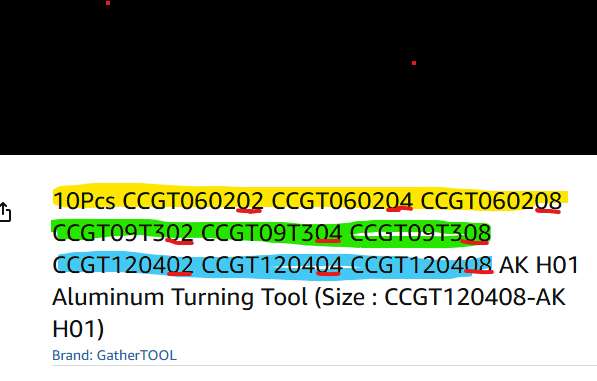

                                          I  found these which state they are for aluminium
                                          https://www.amazon.co.uk/CCGT060202-CCGT060204-CCGT060208-CCGT09T302-CCGT09T304/dp/B0CH1G7D7H/ref=sr_1_1?sr=8-1
                                          but am very confused at their sizing……can anyone decipher please

                                            There could be many or even a combination of reasons. And I can only offer some general tips about using carbide. But I’d definitely agree that the amount of tool extension is far too much. There may be rare times due to work piece features and extending the tool might be required simply because there’s no other choice. Turning an offset crank shaft throw would be one example. Your tool looks to be extended at least a full inch more than it needs to be. Due to how brittle it is, carbide in general doesn’t tolerate any chatter and vibration well. Although today there’s specific grades for interrupted cutting conditions. I’d reposition that tool shank with the bare minimum of extension outside the tool holder and run it dead on center. Tool and work piece rigidity is everything when machining metal. When boring, I might run the tool tip height a few thousandths above center. But I’ve never purposely run any cutting tool below center because there’s no positive reasons to do so.
                                            You say slower speeds, how slow? Turning aluminum dry can create what’s called a Built Up Edge (BUE) on the tip of the carbide. It’s friction welding the aluminum to the tip. When that breaks or is forced off, it usually removes a section of the carbide tip along with it. Although not anywhere as severe as your last picture shows. That to me looks like a complete fracture of the cutting tip. For us, the easiest cutting fluid to use for aluminum might be WD-40. But Carbide is also intolerant of what’s called thermal shock between high cutting tip temperatures and sudden cooling. So any application of cutting fluid needs to be fairly steady. Simple brush application seems to work well enough from my experience. Also never stop the lathe while the cutting tool is touching the work surface, back the tool away and then stop the lathe if you don’t already know that. Most times that will partially chip the carbide cutting tip more than enough to matter on any material. But you still wouldn’t remove the whole tip like your last picture.
                                            84p per insert isn’t much when you consider everything involved in creating a replaceable carbide tip. For anyone using carbide tips, well worth the 6:20 of time to watch. https://www.youtube.com/watch?v=0QrynzJ_lZ4 It’s amazing to me we can even buy quality carbide tips at what seems high prices considering what is involved in their production. No one can be certain if your tip quality may be the real cause or not. But trying a few recognizable brand name tips might give you an answer. Years ago and fwiw, I bought a set of braised carbide tools because they were very cheap. They also had extremely poor durability, due I suspect now to the manufacturer cutting corners on the carbide quality, the metallic binder or sintering process since they were so fragile. I’d actually describe the carbide as ‘crumbly’. All of them were a complete waste of money. The industrial quality and short braised carbide boring bars I bought later for my boring head were quite expensive, and in my opinion definitely worth what they cost.
                                            You haven’t shown the work piece shape you were cutting. Any lack of tail stock support for the free end of the work piece can be another cause of edge failure if your getting high amounts of chatter? But again it shouldn’t be the whole tip. The rough rule of thumb is any work piece length more than about 3 times it’s diameter outside the chuck jaws is going to require tail stock support. Sometimes up to 5 times diameter might be barely possible when for various reasons it’s unavoidable, but the cutting tools need to be extremely sharp and only tiny depths of cut are possible. For the best results with aluminum, I’d also agree with others here, the highly finished and lapped specialty carbide tips for aluminum might be the better choice. But with adequate oil flow, your ML7 should still be fine at up to 900-1,000 rpm. If your concerned about it, run the lathe for a bit and check the bearing caps with your finger tips for any excessive heat.
                                            Listening to how the cut is progressing is a big part of it. When everything is correct, there should never be any sounds of high pitched squealing or vibration. Or signs of it on the work piece finish. The work piece shape, the cutting tools and even parts of the lathe all have a frequency of vibration. Learning that cost me an unnecessary set of lathe spindle bearings. The real solution was increasing the feed rate instead. That was a lesson I’ve never forgotten. With decent quality carbide tips, I’ve only had possibly a very few unexplained issues. Almost always any cutting tip failures were due to my own dumb mistakes while learning. If chatter or that squealing is present, then the rule of thumb is to either lower the rpm, increase the feed rate, or both. So far I’ve never had an instance where increasing the rpm has worked. None of the above should really create a tip failure like your picture shows though. Unless the carbide is defective, about the only time I’ve seen a failure like that is due to a massive shock load such as crashing the tool tip into the chuck jaws.
                                            In comparison to the honed edges on a high speed steel cutting tool,the non ground and lapped carbide tips are by anyone’s definition quite dull. There’s at least one old video on YouTube I couldn’t seem to re-find, but it showed a high magnification slow speed video of how carbide cuts. Part of it is the high heat generated at the point the material is being cut. That heat helps to somewhat plasticize the material so it’s removed and flows off the work piece and cutting tip easier. Carbide can still cut at lower rpm, but it’s then not operating at it’s most optimum design conditions, the cutting loads will be much higher, and usually with a poorer surface finish. For your ML7 and lower available rpm concerns, high speed steel cutting tools might be the more logical choice since that’s what it was really designed to use.

                                                  The highlights show three different overall sizes, 06, 09 and 12 basically if you drew a circle that touched all 4 edges that would be it’d diameter.
                                                  In those three size groups you have different tip radii as marked in red. 0.2mm, 0.4mm and 0.8mm. Middle of the road to satrt off with would be the 0.4mm
