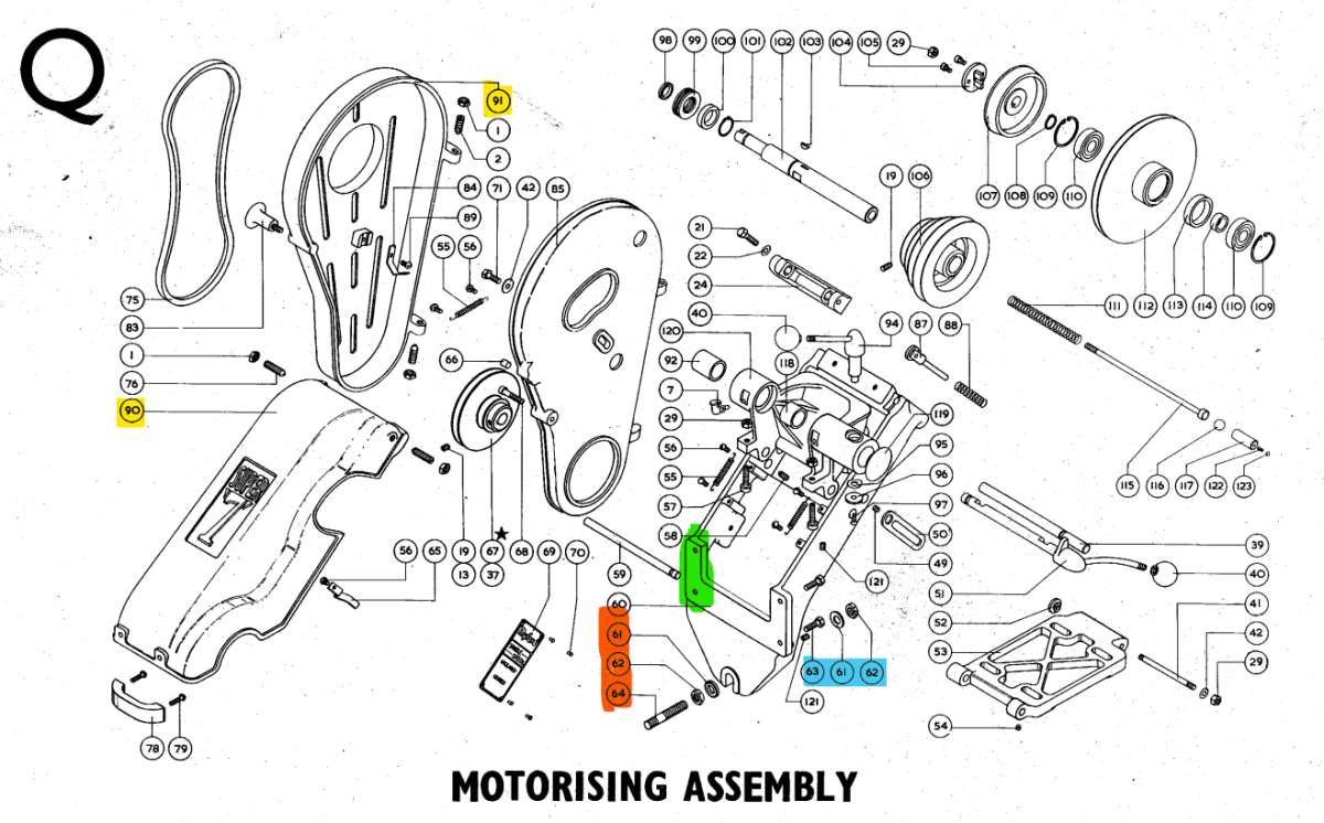

                  peak4
                    @peak4
                    As per my previous post, provided the drive belt is a link type, you can remove the whole of the motorising assembly as a single unit.
                    Remove belt guards 90 & 91
                    The unit is then only attached by some screws, 63, and a stud 64, which is helpfully located in a slot rather than a hole.
                    As I recall, the left hand vertical pair, through the green holes, are fiddly to access, needing a long ¼” drive.
                    Hex Allen screw replacements might be easier.

                    Andrew Tinsley
                      @andrewtinsley63637
                      Hello  Peak 4,
                      If the belt isn’t pf the link type, what else needs to be done to remove the motor unit?
                      Regards,
                      Andrew.
                      P.S. I have heard lots of conflicting advise on what link belts to fit. Seems there are quite a few makes available with one or two being excellent and others being worse than useless.

                      peak4
                        @peak4
                        That’s a new one, on submitting my previous reply, I was logged out of the forum and all the reply text and links vanished.
                        Andrew, as far as I recall, just unbolt the motor, and strap it to the cabinet, if you don’t want to re-wire it.
                        Just make sure to note and label the wiring.
                        You will also need to remove the motor drive pulley, but take case as it’s easy to crack off a section of the outer.
                        Re Link belts, I can’t see much reason to replace a good continuous belt, but mine was knackered.
                        From my own experience, the plastic black or white link belts slip too easily.
                        Brammer and NutLink, both with metal fixings, sit too high in the V pulley and are difficult to get onto the largest pulley as they foul on the casting. That’s particularly the case with the latter, though I use it on other machines.
                        Fenner Powertwist comes recommended, though I’ve not used it myself.
                        Personally I use Megadyne Accu-Link on both my Super 7 & its Warco720 clone; it fits and works fine, just be sure to follow the installation instructions, rather than making assumptions.
