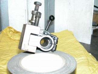

              Clive Foster
                @clivefoster55965
                I’m not a lover of running Coventry die heads off the tailstock quill. Its hard to get a nice constant feed and, if the die doesn’t want start cleanly there is a risk of it twisting out of the taper.
                I run mine from a tool post mount. Its easy to keep a nice constant feed using the longitudinal feed hand wheel whilst watching the die head bob back and forth on its positioning spring. A bed stop reliably sets the threading length. The pull forward distance to release the die once feeding has stopped is very repeatable.
                On Lathe
                Back
                My carrier was a simple weld up job. Fix a tube to bar to fit the QC post, weld bolting stubs on the side drilled to clamp bolt threading size, split the tube, tap the bottom parts of the stubs, drill the top plan generous clearance and clean up the bore in site with a between centres bar. Job done. I made an MT taper setting stub to fit the bore for rapid alignment using the stub in the tailstock.
                If you don’t have a QC system a suitably bored block with similar clamping arrangements will work just fine.

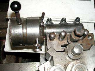

                  John MC
                    @johnmc39344
                    I’m with Clive F. on this one.  I think it a lot to ask of a small Morse taper.  This will, no doubt, be dependant of the size of die head and MT.  Better to mount on the saddle in the toolpost.
                    I have found occaisional difficulty in starting a thread with the die head so I set the gearbox to the correct pitch/TPI, let the leadscrew drive the head onto the workpiece, when a few turns have been established, release the leadscrew, the die head will then carry on until the saddle stop, the die head opens and is withdrawn.
                    I’m intrigued by Bernard T’s mention of an “internal stop”.  Is that the way the die head opens or something else?
                    The photo shows my toolpost mounting arrangement, 1″CHS die head on a Colchester Triumph.

                                These dieheads do not have a built in “stop”.  What they have is a an automatic trip/opener.  This is activated by the stops on the machine its mounted on, typically a bed or capstan slide stop.
                                Semantics?  Possibly, no harm in trying to get the meanings/use correct.
                                Incidentally, I’ve just realised my photo of the head mounted in a centre lathe is a DX with the external trip, although I rarely use that feature, relying on the internal trip.
                                This head was initially used on a “Herbert Auto Robot”, a plug board controlled capstan lathe.  I was tasked with getting this (new) machine up and running.  A waste of time, soon superseded by NC the CNC, that and a change in the work that the workshop undertook.
