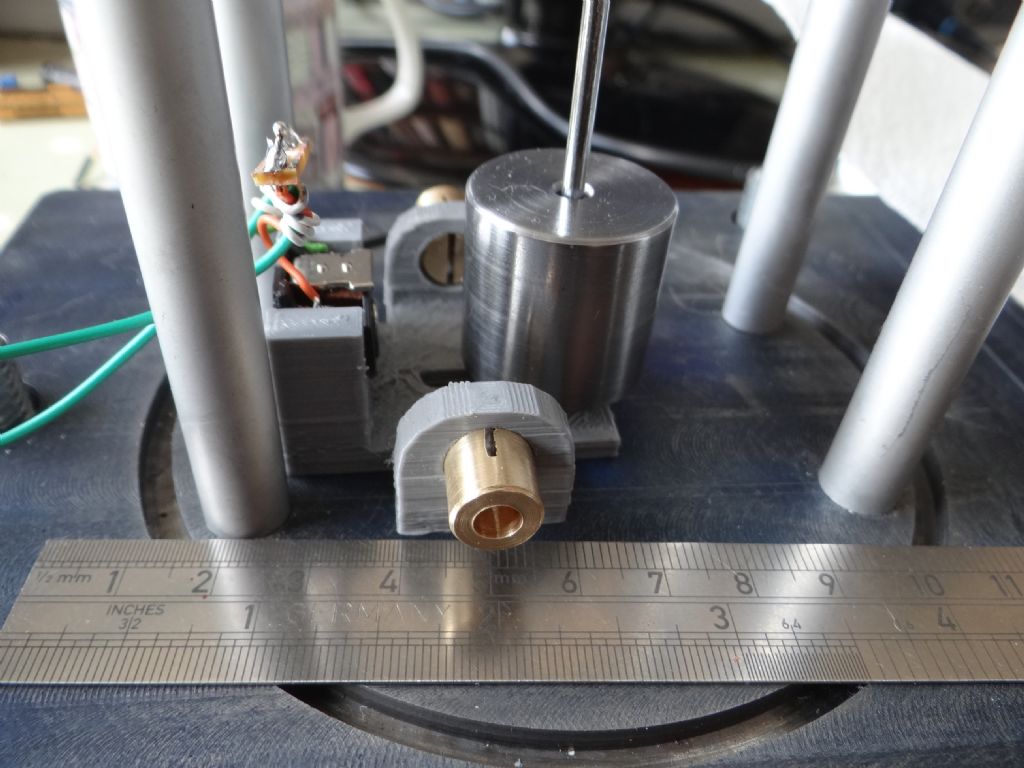

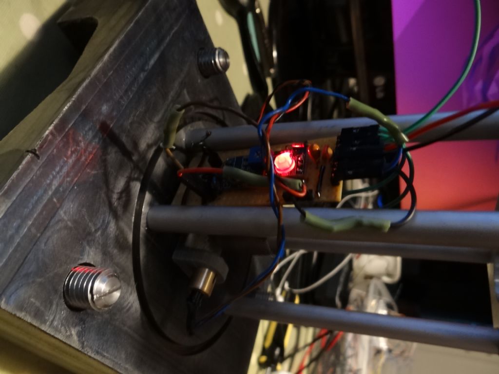

                    #642266
                      Thought I'd made significant progress today until I made the mistake of testing it!
                      Wiring needs a tidy up but the slotted beam breaker works well.
                      Bad news is the electromagnet isn't powerful enough to self-start the pendulum, which is essential after the works are sealed inside the vacuum. Can't think of a simple answer and will have to sleep on it.
                      Pesky details…
                      sad
                      Edited By SillyOldDuffer on 22/04/2023 20:39:17

                            Posted by SillyOldDuffer on 22/04/2023 20:39:01:
                            Post a photo of the mechanical layout of E-Magnet and bob positions and give some indication of distance tween the two. Also some mechanical details of the E-Magnet – size, core size,No of turns, resistance, and your drive cct ( just the drive part, not the cpu etc…

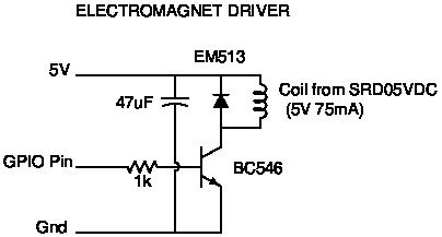

                                  #642329
                                    Posted by Joseph Noci 1 on 23/04/2023 07:20:46:
                                    Well, this is a side mounted electromagnet intended to impulse a 95g steel bob on a 240mm rod suspended inside a vacuum chamber made from a 4" diameter PVC soil pipe (103mm):
                                    The electromagnet and beam break tubes are held in a 3D-printed 'chariot'. The present design is scaled up from the earlier build, and puts the magnet about 15mm away from the stopped bob. This is a mistake, because it moves the magnet further away from the bob, which is also nearly 5x heavier than the original.
                                    The electromagnet is the coil and core removed from a small 5V relay common as muck in Arduino modules, type SRD05VDC. The coll draws 75mA and my driver circuit is basic using junk box components:
                                    Results from a few experiments this morning:
                                    • Duncan's idea, tilting the whole clock, is in line with my first reaction last night, which was to hit it with a big hammer.
                                    • Blowlamp's idea works – a permanent magnet from an oven magnetron is just powerful enough to grab the bob from outside the case. Unfortunately the action on release is horribly violent; the bob smashes hard into the internal electromagnet.
                                    • John Haine's idea, pulsing at resonant frequency, could be made to work, but it takes forever to build up, and much depends on whether the bob is stopped or already moving out of phase.
                                    • Simply moving the electromagnet closer looks promising. It grabs the bob when about 5 or 6mm distant, which I think leaves enough space for a swing of about 5°.
                                    Not too difficult to try, so I will. Fair amount of work had I milled the chariot from metal, but it's 3D printed from an easily changed CAD model. Be a delay – I'm out this afternoon.
                                    #642330

                                        #642341
                                        Joseph Noci 1
                                          @josephnoci1
                                          How close to the E-magnet would the bob be in 'normal' operation before the bob turns around?
                                          #642350

                                                Posted by Joseph Noci 1 on 23/04/2023 15:07:09:
                                                I'm aiming for an amplitude of up to 5°, which will take the bob to within about 1mm in the new configuration. I can adjust the impulse so the bob doesn't quite hit the electromagnet.
