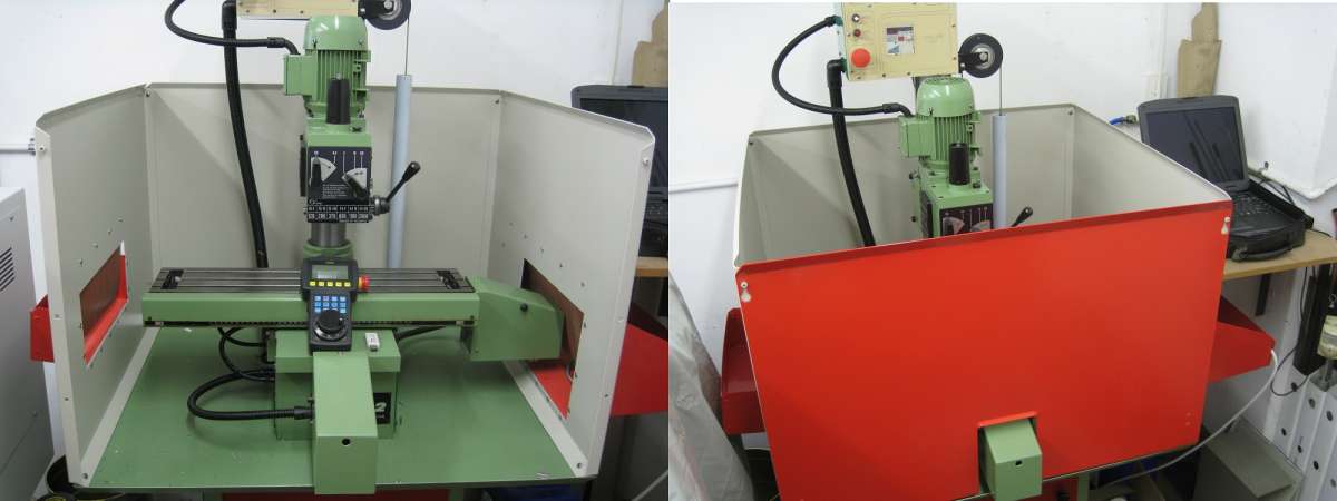

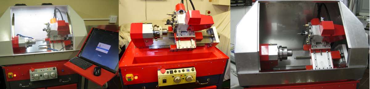

            Wish I could find something that can my DIY lathe with a C axis and auto-tool changer with center Live tool…I use LinuxCNC ( after a year of jumping through hoops  and much pain) and it works well, but the user interface is so clunky and yesterday…The inverse Kinematics for live tool milling with the C axis were just a nightmare on LinuxCNC – found a few bug with the master build, but eventually it works.. I just am no fan of Linux at all, so a single board embedded setup would be so nice. Unfortunately uCNC does not do anything like that..
            CNC_Lathe_JoNo
            For the CNC Mill, routers and engravers I moved from MACH2 with various board oddments to the UCCNC products – the AXBBE on the Router/Egraver and the UC300ETH on the CNC Mill. They work very well and the software is good. I find the trajectory planner much better than MACH2 and the steppers are much smoother, with a much better acceleration algorithm.  Mills
