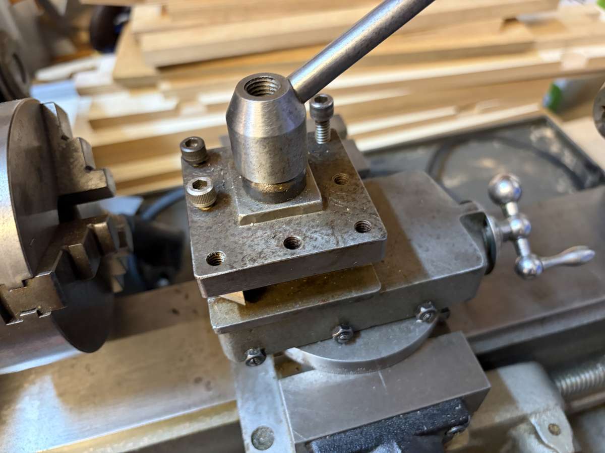

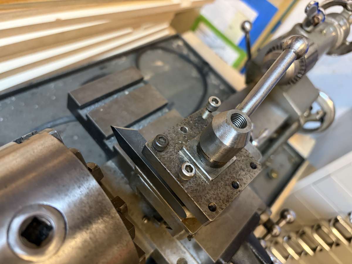

      Good Evening,

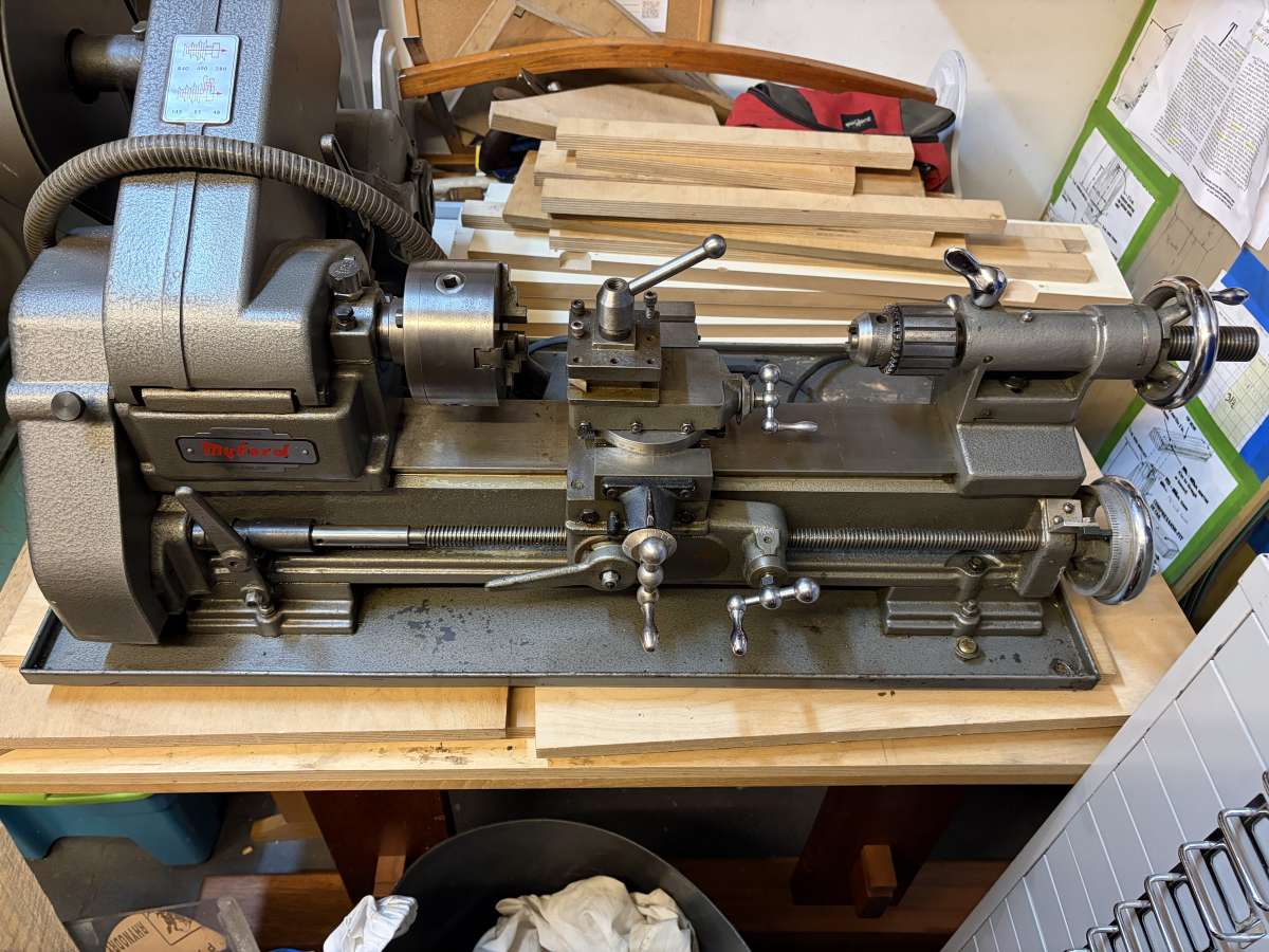

      New to me is this Myford ML10:
      IMG_7715
      I’ve cleared a small space in my shed/workshop.
      Now I have to build a bench; and clean the lathe up.
      It’s my first metal lathe. So whilst I’m mechanically minded and could of course clean it up and oil it, I’d be grateful if members could share their suggestions, such as which degreasers, oils, cleaning and lubrication methods will help going forward for maintenance as well as the present need to recommission. Thank you in advance.
      IMG_7713IMG_7712IMG_7704IMG_7709

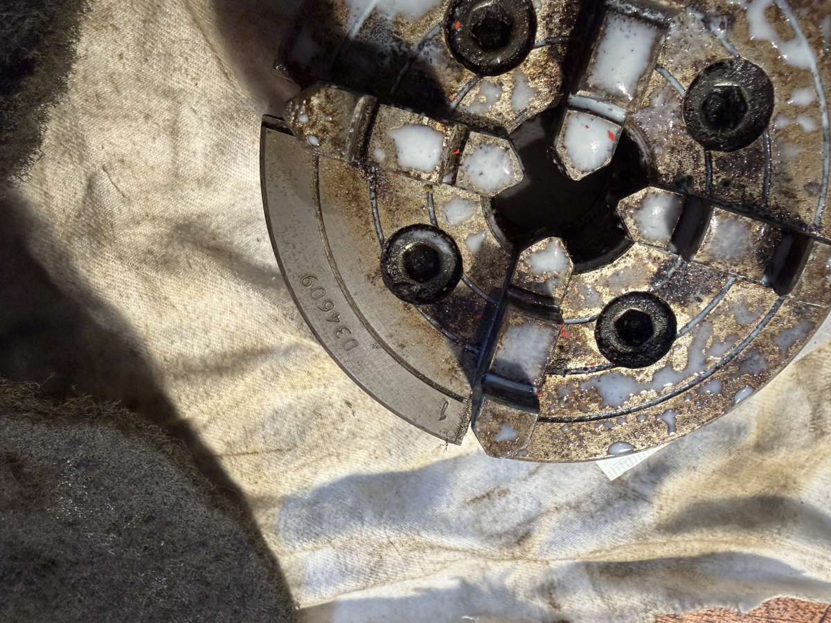

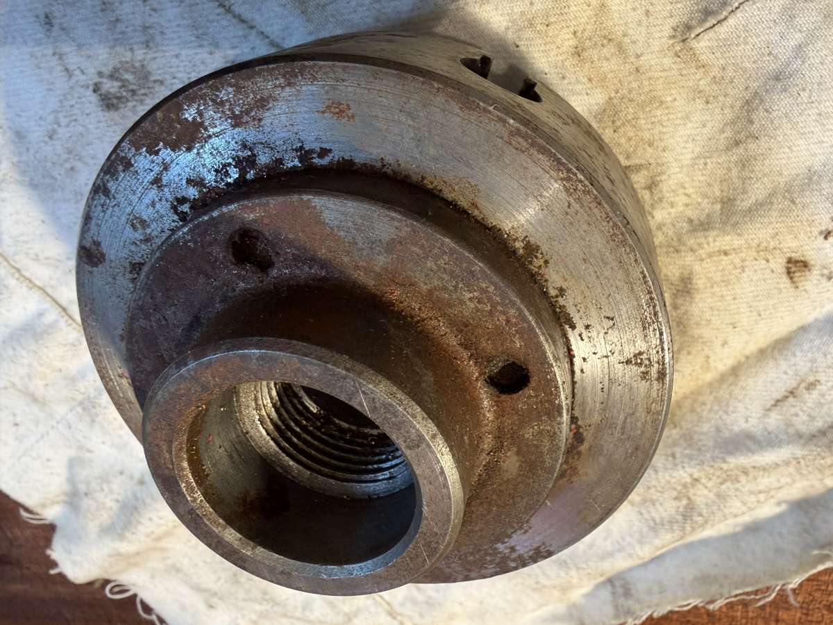

      Lastly I have a 4” chuck which I will probably not get around to cleaning up for a week or so, is it a decent one? Other than stripping, cleaning oiling are there any other checks or actions that I’d be sensible to take to maintain this chuck please?
      With thanks and best regards, Starjump.

        Now that you are into metalwork you will have bits of metal eager to rust. Get some clear Waxoyl car underbody wax. Dilute a little with white spirit and paint it on all non moving metal.
        It evaportes to leave a thin wax feeling like the glue on post-it labels and is much nicer to handle than oil, and stays in place.
        Moving metal can make do with car oil, especially change gears, not grease which traps and holds swarf. No need to get fussy about oil for the moment. Forget WD40 and 3in1.
        Check your local churches for 7-day St Patrick’s candles sometimes burning in front of statues of saints and ask the churchwarden if you can have some old ones. They are a plastic tube containing a soft wax unlike the hard wax of normal candles and there is always a little left. This is good for protecting handles and knobs that you will touch. (also good for your wood saws and chisels). If not available use beeswax furniture polish but NEVER allow silicone polish into the workshop.
        Cover your lathe with an old cotton sheet (charity shop) not plastic which sweats.
        The 4jaw is probably a generic Chinese/Indian one which are now ubiquitous. Perfectly ok for a 4 Jaw as it is only for a 3 jaw that you might want to get fussy if you want it concentric.

            Clean with white spirit only. It is the universal cleaner. Never use petrol (obvious) or paraffin which is likely to contain water. Looking at your pictures the lathe should be easy but the chucks could be quite greasy. When cleaning, the chuck should not be removed from its backplate. Powerful degreasers should not be necessary.

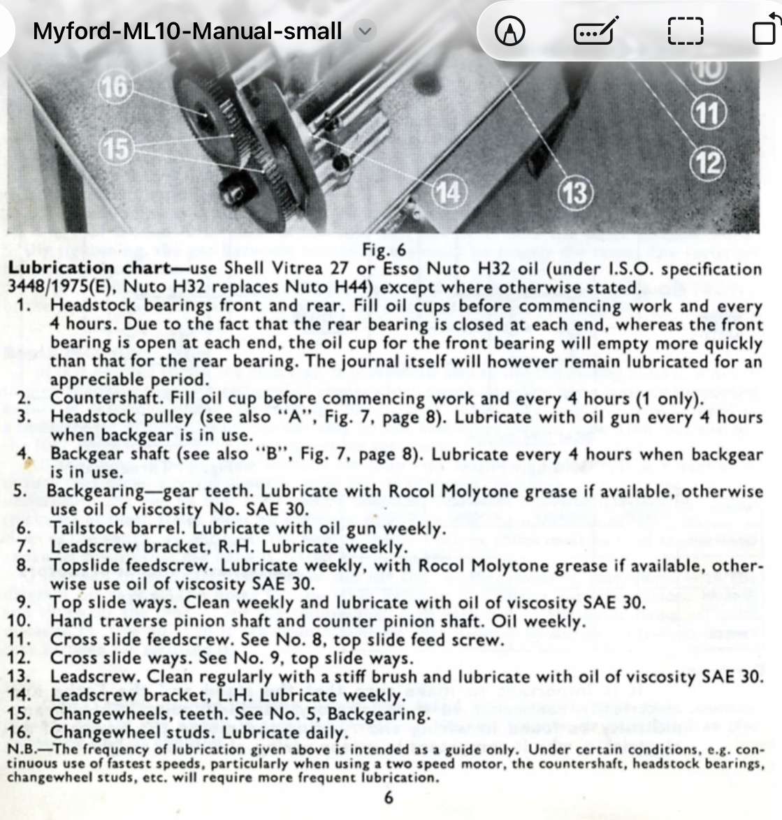

            Lubricate with hydraulic oil not car engine oil. Modern engine oils are quite strange and very additive rich. Also they are expensive. Old engine oil also contains dirt and water. The recommended oils are (SAE & ISO numbers are quite different)
            • ISO 68 slideway oil – This is slightly sticky and used on the slide ways, gears, lead screws and any bare metal.
            • ISO 32 oil – Much less viscous than above and used on bearing, bushes and tailstock. Myford fitted oil nipples for this oil, THEY ARE NOT FOR GREASE. You need an oil gun. A good grease gun should work with oil. Myford may be able to supply you with a very expensive Swiss made gun.
            Obviously the availability of these oils is less than car oils. Lubricant suppliers generally use 25 Litre containers although some still sell 5 Litre. It is worth shopping around. It the past I have used Morris Lubricants who offer a delivery service. Myford and other model engineering dealers sell such oils in small amounts and, I feel, at great cost. However the small containers are useful. Once lubricated do not wipe any excess oil off the lathe and when not in use cover it for protection from the nasty outside world.
            The chucks should be greased with a Lithium based or Molybdenum Disulphide based grease (available at all car bits shops). This can be a bit messy.

            • Do you have an instruction booklet for the lathe? The old Myford company would have issued one with a lathe. I don’t think the present company would have any copies. It could be worth contacting Mr Griffiths at lathes.co.uk.
            • Before using your lathe make a good fitting wooden bridge to protect the bed way when changing chucks.
            Have fun.
            JA
            #870190
            Andrew Tinsley
              @andrewtinsley63637
              All the Myford manuals are still available from RDG / Myford.
              Andrew.

                      The three jaw chuck can be completely dismantled for cleaning, but it is best to not try to remove the screws from the four jaw one, but clean them in situ
