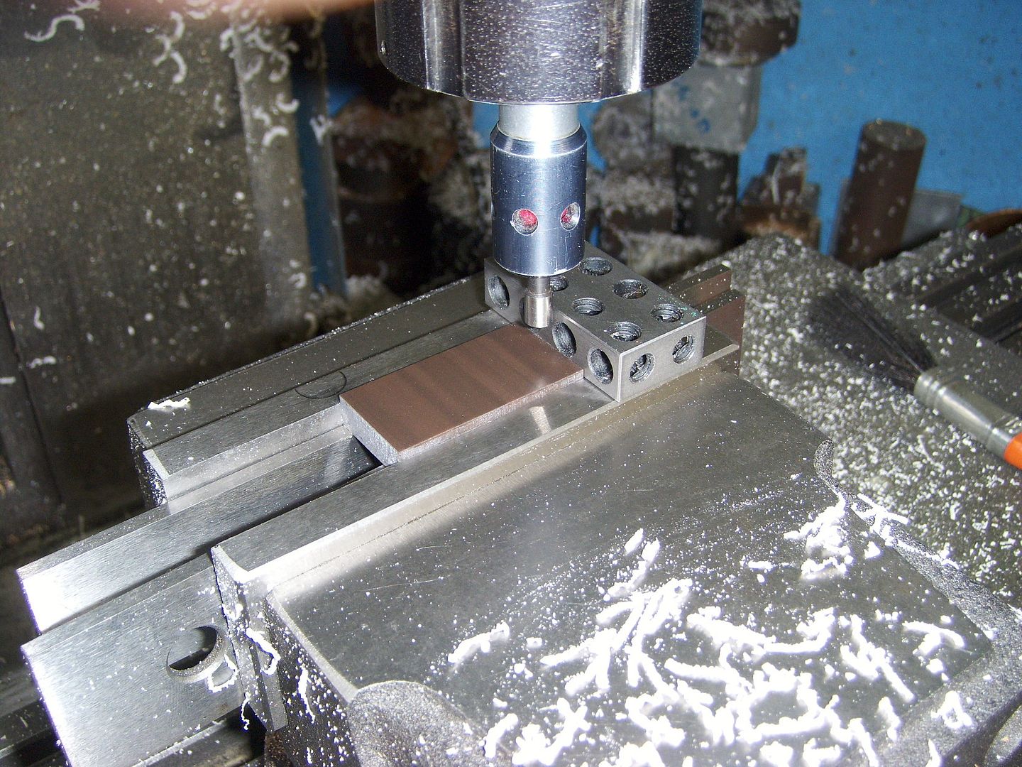

              I just hold a metal block of known size against plastic and that works fine so long as part of the block is touching teh vice jaws, etc.
