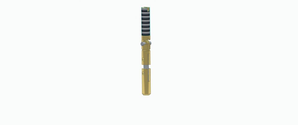

      • A revised suspension:
        • More accurately made
        • Screw adjustable for height and able to adjust the angle of suspension spring with the electromagnet
        • Improved clamps using shims
      • Revised sensor and magnet holder, adjustable relative to bob
      • Tubes and slit to narrow the Infra-red beam.

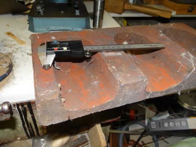

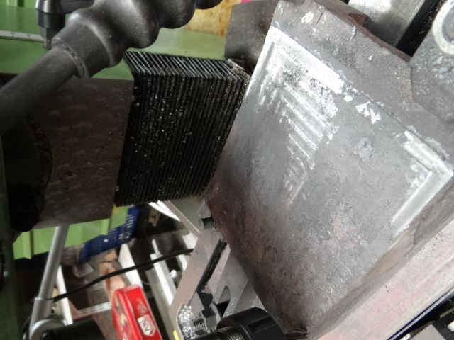

      Plan A was to buy a section of cast-iron round from Noggins End:
      but I realised I already own a block of cast-iron with a handy cave underneath that can be used to hide the microcontroller:

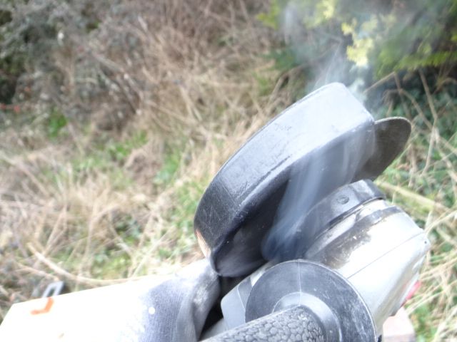

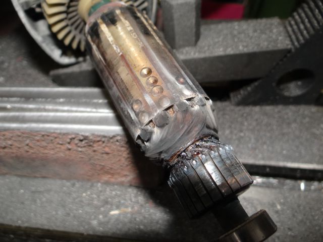

      Saves money too, all I had to do was cut it. Alas my dear old angle-grinder wasn't up to the job. Belched smoke much more than in this photo, and it is now a late grinder, pushing up the daisies, kicked the bucket etc.
      First expense: replacement grinder with a bigger motor, £70, roughly twice what I would have paid Noggin's end for a blank.

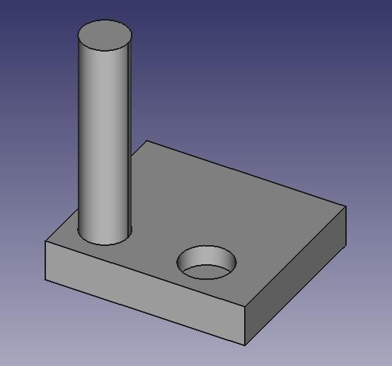

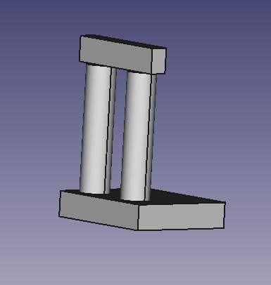

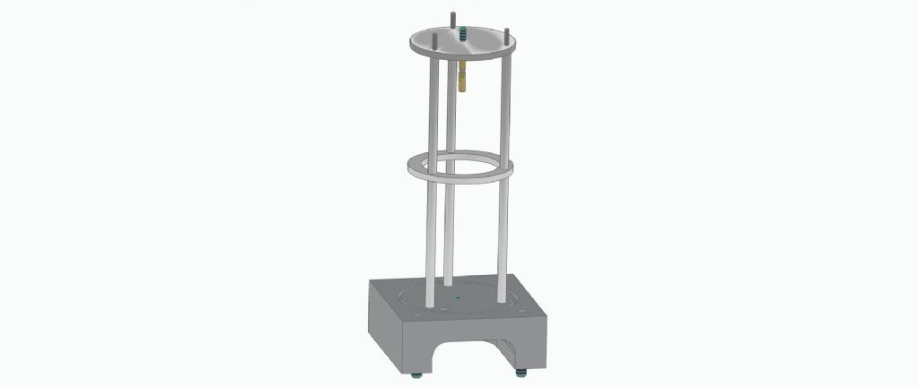

      Anyway, the initial design:

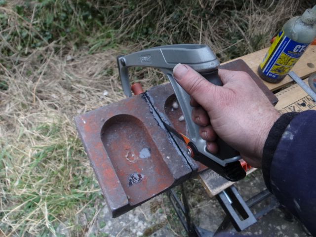

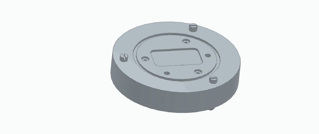

      Cutting the base was hard work because a 115mm angle grinder doesn't cut deep enough, and I had to finish with a hacksaw, also on the small size. After what seemed like an hour's sawing I had to stop for tea; I'd actually lasted less than 13 minutes. Not as fit as I used to be!

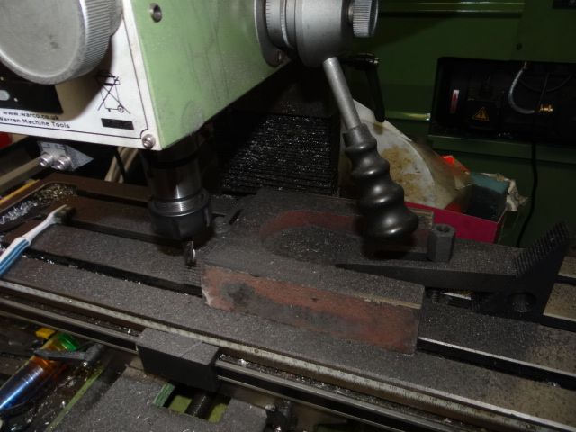

      Had just enough time to plonk the block on my mill and skim the lower side. Horrible job, nasty hard skin and black dust everywhere. (Halfway through I realised I'd forgotten to put down paper.)
      Out bashing relatives tomorrow but I may have an hour to make a start on the new suspension:
      Now I'm filthy, exhausted and bankrupt. I can only hope the effort is worth it!

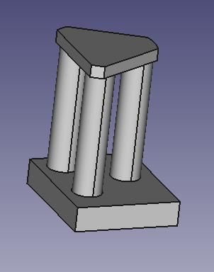

            I'd be tempted to use 4 uprights rather than 3,the side load exerted by the pendulum on the top plate will tend to produce a rotation (I think). When I get time I'll do some sums. 2 A frames would be even better, stiffer.

                  Posted by duncan webster on 04/03/2023 21:57:35:
                  The jury is still out. John Haine made the same point, but Michael G raised the merits of kinematic design in which 'mechanisms can be defined as assembly of rigid members connected to each other through joints'. It observes that objects have 6 degrees of freedom, and that total rigidity is provided by locking all of them and no more. It suggests the designer shouldn't add structure unless it locks a degree of freedom that's still free. Adding structure that doesn't reduce a degree of freedom is just more weight and complexity, that might reduce a structure's rigidity and strength.
                  Looking at a single column as an example, resting it on a flat base only constrains one degree of freedom – it can't be pushed through the base! But it can be slid sideways or lifted off, ie unconstrained in 5 of 6 directions. Fitting the column into a pocket cut into the base is a considerable improvement. Once located inside the hole, the column can't be moved sideways, it can only be lifted up. All six degrees of freedom are constrained if the column is bolted into the pocket.
                  Or are they? If enough force is applied to the top of the column, it will bend. This can be constrained somewhat, in one direction only, by bolting a crosspiece to a second column:
                  The structure is still weak if the beam is pushed backwards, hence good to add at least one more column and connect all three, forming a tripod, all joints being rigidly fixed together:
                  I don't believe four columns are any more rigid than three. Four columns are advantageous for reasons I don't need: they open up a rectangular space inside, and – potentially important – four columns can take more weight than three. But my lightweight bob doesn't put much force on the structure.
                  Diagonals would stiffen the structure by preventing the top from rotating relative to the base. This is desirable, but are difficult to build and reduce access to the interior, which is needed to hang the pendulum and adjust the innards. I hope to get away without diagonals.
                  Although my tripod is plenty strong enough, I am worried that it might sway at a resonant frequency. Really bad if my wonderful new design vibrated like the Tacoma Bridge or a bass guitar. I've no idea how to establish the resonant frequency of a tripod, or any other structure. Anyone know?
                  Twanging the end of a steel rule flat with one end held flat on a table shows resonance can be a serious problem in strong structures; I reckon the breaking strain of a steel rule is about 2 tons, yet a gentle push vibrates it enthusiastically.

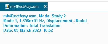

                              I should be doing urgent housework before eating but I couldn't resist seeing what Solid Edge can do. It supports vibrational analysis, with the following result:
                              So SE thinks the assembly will vibrate naturally at 13.58Hz, and I expect the pendulum to vibrate at 1.2Hz I guess that's OK, but yet again I don't know!
                              Before jumping to conclusions, I need to add all the components, in case they make a difference, and then try and understand it. Could take a few years!

                                So SE thinks the assembly will vibrate naturally at 13.58Hz […]
                                Frankly, I would be surprised and disappointed if what you have drawn resonated at 13.58Hz
                                … but I tend to ‘fly by the seat of my pants’ so I am perfectly happy to be wrong.
                                Does it show you the mode of vibration ?

                                #636296
                                  Dave,
                                  As a quick sanity-check in the Lab, we would consider the static deflection of a structure, to predict the frequency of a vibration mode [only really feasible for the basic bending modes]
                                  If you put your structure on its side, simply-supported as a beam, you can measure the static deflection … this is, of course directly equivalent to 1g of vibration
                                  This site has a simple calculator … **LINK**
                                  https://www.modalshop.com/rental/learn/calculators/vibration-calculator
                                  Note: You must re-set it between calculations
                                  Either do what we did, or just try putting 1g and 13.58Hz into that, and see what deflection it predicts
                                  … now compare with what you measure.
                                  #636300
                                    Posted by SillyOldDuffer on 04/03/2023 20:32:13:
                                    Noted with some embarrassment
                                    … because I had been looking at your ‘chunky’ drawings when I made my previous comment.
                                    The frequency estimate may be good after-all.

                                      All calculations and 6 axis theory aside, your structure of three very thin columns simply does not look rigid enough. The columns might be fixed in 6 axes, but they will still bend and flex along their lengths; allowing the top plate to move sideways in the plane of the pendulum swing.
                                      The thin columns are effectively what would remain after a rigid metal tube had been almost completely milled away ! So I think you would be much better off starting with a metal tube, either circular or square cross section, to support the top plate, and mill away some oval shaped slots for access, leaving as much of the tube wall as possible – especially at the top and bottom – whilst allowing you to get in and mount the pendulum and associated components.
                                      That would give you a far more rigid structure than those three thin spindly rods, and would remove a potential source of parasitic vibration that you don't want.
                                      (Your plastic tube, within which to provide a vacuum, would fit over and around the metal tube.)

                                            Please don't shut up, that's a valid suggestion.
                                            I've gone with floor-standing because I don't have a suitable wall, not because I believe a tripod to be best approach. Running the pendulum in a vacuum and the need for access during set-up are influences too.
                                            When the clock is evacuated, or the vacuum leaks over time, I expect the tube to move, which would disturb time-keeping if the pendulum was supported by it. So, at the moment, the tube only connects at the base.
                                            John Doe's solid cylinder idea would provide excellent rigidity, but horrible access problems. I base the comment on experience with the Mk1 clock, where the tripod fitted inside a 68mm diameter drainpipe. Left precious little room for the internals and my fat fingers. Even the anti-buckling ring was a nuisance.
                                            I'm almost persuaded to go with four pillars. Not needed for strength, but rigidity is important. Not much work either.
                                            Meanwhile, metal mangling not going as well as it might have done. Strictly speaking only the top needs to be machined, but I'm tidying up. The base machined OK, and I flipped the block to do the top. I rip the scale off with a carbide cutter, then finish with HSS. On top, the scale is thicker, and the casting surface ponded slightly. I should have gone deeper with the carbide because cleaning up the rough cut shows I didn't get down to bare metal over about half the area.
                                            Not the end of the world, but machining scaly cast-iron is a dirty job and unkind to cutters!
                                            Apologies for the chunky tripod post. Intended to explain and clarify, it did the opposite.
                                            I was pleased to find SE includes vibrational analysis, but can't claim to understand it. It can do 3 modes which I haven't explored because I crashed it last night attempting an analysis with the tube cover fitted. SE goes through a number of set-up stages before doing the analysis, and I guessed, which often ends in tears.
