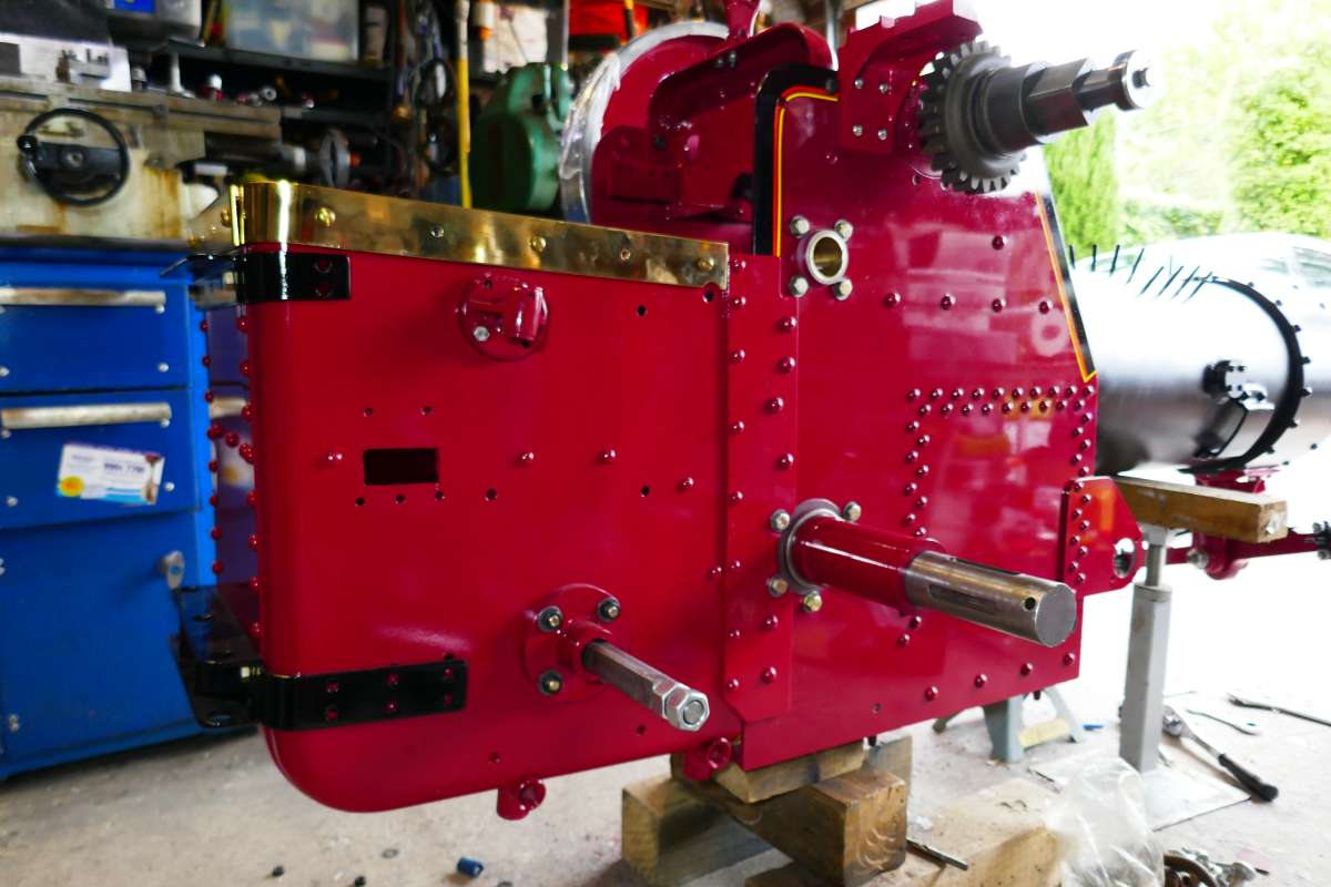

      If the rivets are only for show, a simple method is to shorten them so they just protrude thru to the rear (unseen) side, rest the head on a suitable formed anvil and peen it over with a hammer.
      This is a photo of the rivets on my traction engine. The LH side is the tender/water tank and the RH side the horn plates.
      None of the rivets have been fitted with a press. Most are only aesthetics and for show and have been welded on the rear side. The rivets that are joining the tender and horn plates are threaded like a bolt and have a nut on the rear side, allowing the tender to be removed.

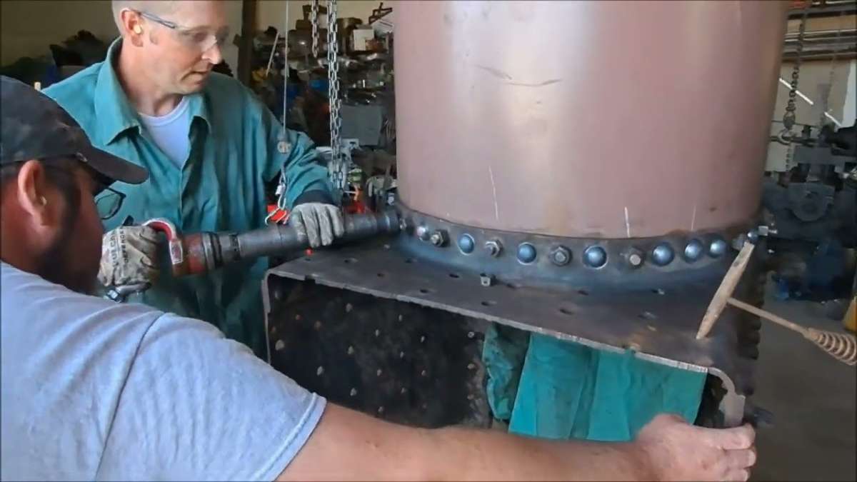

        If you are heating small rivits they are best done by heating the end in situe then you don’t loose much time getting the snap into place. Best a 2 man job so as the heat source is removed the other person can get in quickly to form the rivit.
        https://web.archive.org/web/20180831185932im_/http://fowlermodels.nl/index_bestanden/image2733.jpg
        Flypress would be the way to go. Do they really need to be iron rivits, would copper do as used for traction engine wheels with aluminium rims.
        SDS+ Hammer and a modified chisel will also make short work of 1/8″ iron rivits

          Jason has brought us into the modern world, WHY didn’t I think of an SDS drill ? The bigger and better ones have rotary stop ! Take an old drill bit and machine the dimple in the end to form the rivet head. I will have to try it, I have a 4Kg SDS. Thanks Jason. Noel
          #870367
            You can leave the rotary on and use it like a rivit spinner.

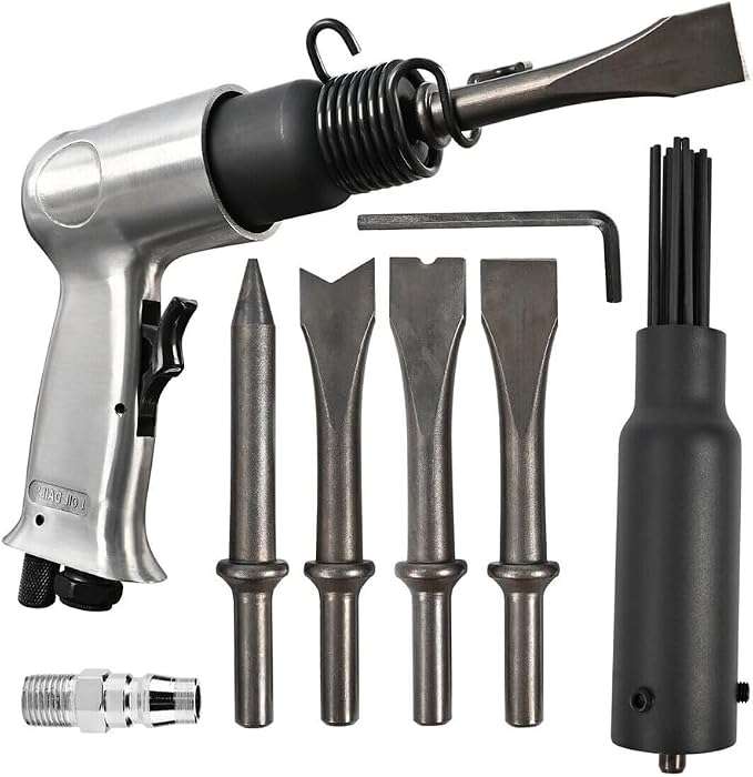

              Full size engines also use a pneumatic impact tool like a small jack hammer with a snap to form the rivet head.  If you have an air compressor,  a small version could be made from an air chisel, available from hardware and car accessory stores.   For little rivets you could also use a nail punch and hammer. (Nail punches are similar to a centre punch but have a recessed hole in the end that goes over the nail head)

                If you are going to use a nail punch you might as well just use a proper snap and hammer
                #870387
                Speedy Builder5
                  @speedybuilder5
                  Paul,  I tried an air chisel, but unlike the proper rivet guns, the distance of travel of the piston can’t be regulated and the snap jumps all over the place. As an apprentice we used plenty of rivet guns setting aluminium and Monel rivets – those guns didn’t jump away from the rivet unless you were very soft handed.
                  #870388
                    I think that is why the SDS method is better, they tend to have more weight behind them so are less likely to be pushed off the rivit.

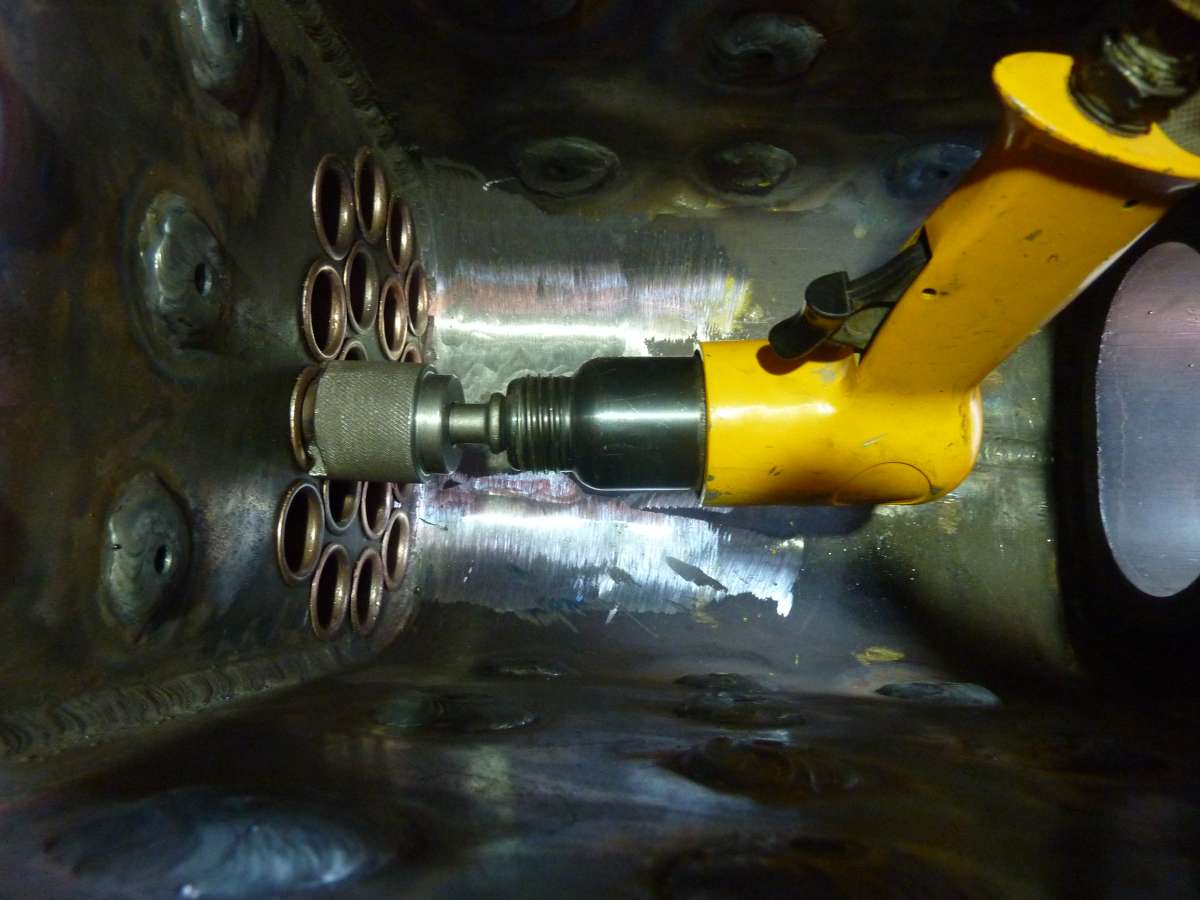

                      Speedy, I agree, they do jump around a bit. Just an idea. What I have used them for is to roll the end of the tubes in the boiler. (this is one of the requirements in the Australian code for model boilers. It helps to prevent corrosion of the ends of the tubes)
                            There is also something called a ‘palm nailer’ which might be suitable for the real small stuff. Milwaukee does a 18v battery operated one if you did not want air-powered.
