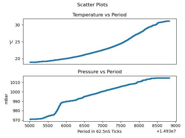

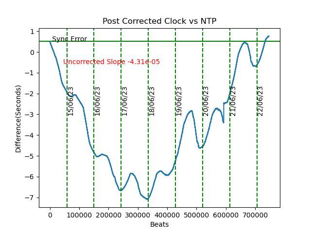

            I confess to procrastination. Fearful of what looking at my iffy clock is doing, I've left it alone for 8 days with compensation switched on. Reason for my lack of moral fibre is I've run out of ideas. I don't mind problems I can solve, but not having a clue about what to try next is demoralising! The forum ought to have a Topic where members suffering the trauma of yet another workshop disaster can go for tea and sympathy.
            Anyway, a short power-cut this morning stopped the clock, so I girded my loins, gritted my teeth, stiffened my lip, thought of England, and downloaded the log.
            Results not too bad. After 8 days my clock was 0.51 seconds fast when the power-cut stopped it. Not truly wonderful because as this graph shows it wandered on the way. The blue line should follow the green line:
            Looks as if the compensation isn't quite right, because the wander shows temperature bumps. I'm not too upset because this new graph shows a reason. It takes the clock longer that I expected to gather enough pressure and temperature data.

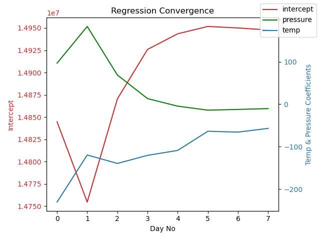

            The graph plots the three factors used to compensate the clock. The red line is the intercept, and the green and red lines are the temperature and pressure coefficients. The three lines should become parallel, and it can be seen that they don't approach that until day 5. And the regression results are wildly wrong during the first 3 days.
            Explains at least part of the wander because the clock can't keep good time until the compensation coefficients are correct.
            Pity the power failed. After 8 days the lines still aren't completely parallel, which means more temperature and pressure data is needed. 746758 samples weren't enough!
            I'm going to restart the clock with the latest coefficients and let it run for as long as possible, thunderstorms permitting, to see if the wandering is reduced. Meanwhile, with morale restored somewhat, I'll make a start on building the vacuum containment.

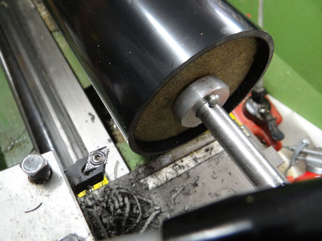

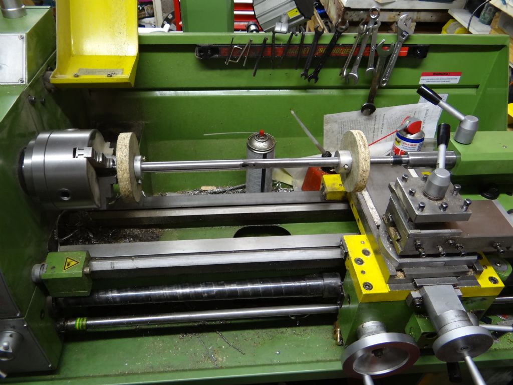

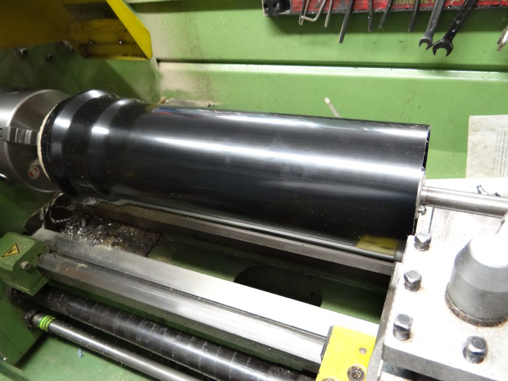

              The vacuum tube (a length of 4" diameter PVC soil pipe) is the biggest item I've turned on my lathe.
              Only needed to put it in the lathe to turn the rough sawn end of the PVC pipe flat, and far more work went into holding the pipe than to cutting it. Apart from being close to the maximum length that will fit my lathe without taking the tailstock off, PVC pipe is bendy, prone to dig-ins, and liable to melt. Needs to be held firmly whilst being attacked with a sharp cutter.
              A sharp carbide insert at low RPM and low depth of cut worked better than HSS. I'm not convinced either is a good choice for turning PVC, but the insert got the job done.
              Took me about 10 hours to design and make a mandrel:
              It's a length of steel gas-pipe with 4 tapped collars holding a pair of chipboard wheels turned to fit the PVC pipe. . One end is held and spun by the 3-jaw, the other is supported by a dead-centre.
              Sod's Law ensured that my live centres are either just too big or just too small to fit gas-pipe, but there's just enough room for the saddle at the PVC pipe end. That was lucky, because I expected to have to take the swarf guard off the lead-screw to get enough travel.
              After all the preparation the actual cut was an anti-climax. The HSS tool was rejected after a couple of minutes of nearly cutting, short pause whilst I switched to carbide, and then the real cut took about 30 seconds.
              A problem I hadn't anticipated was cleaning the pipe. Wiping off attracted a mass of sawdust and cat-hair due to static electricity. The amount of sawdust made me wish I'd worn a mask: the air was still full of dust at least 90 minutes after I'd made the wooden discs.

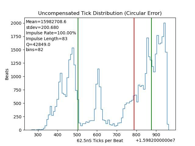

                  SOD: Following the discussion regarding Q in a different recent thread: If you are using this data to compute it, caution would be advised. The distribution is not remotely Gaussian, it's bicameral (or even tricameral?). Therefore, while a calculation of standard deviation is still mathematically possible, I do not think it will be particularly meaningful in the context of a calculation of Q for a system where a normal distribution is expected.
                  My advice would be to verify the accuracy of your calculations of Q using the un-impulsed decay method before torturing yourself trying to understand how it wanders.
                  I also suggest your focus should be on why the distribution is so dramatically non-Gaussian, especially why there are two huge lobes some distance apart. I'd bet you would feel it a breakthrough if you can figure out why.
                  #655821
                    Posted by S K on 09/08/2023 15:40:01:
                    SOD: Following the discussion regarding Q in a different recent thread: If you are using this data to compute it, caution would be advised. The distribution is not remotely Gaussian, …
                    Correct, well spotted. Not sure which test run that distribution came from, but I've had several where the graph isn't normal. The graph indicates a fault, either with the pendulum or the suspension or the IR sensor. Consequently the Q calculation is misleading at best.
                    I tested the first version of the pendulum in many different circumstances, and found it to be sensitive to vibration, temperature, pressure, humidity, impulse power, impulse timing and sunlight. Also, the experimental rod and suspension were capable of much weirdness, such as the rod vibrating and the bob swinging in ellipses.
                    The Improved Pendulum being discussed in this thread fixes all that, I hope! The resulting dataset is a normal distribution, or close to it, so the Q calculation is valid. Assuming I got the sums right that is: I'm terrible at maths!
                    Your observations are much appreciated. I look at the graphs and numbers carefully but it's easy to miss clues and mistakes and jump to wrong conclusions. More eyes-on the better!

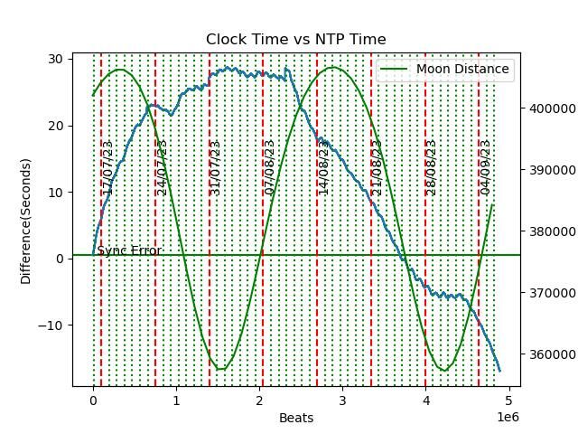

                      An interim progress report, and some clues about what's going wrong/ Maybe.
                      Clock's been running for nearly 53 days and is 16 seconds slow at the moment. The rate is wandering:
                      Looking at myclock vs reality(NTP), I wondered if I was seeing the start of a 40 day cycle. No idea if such a thing exists in nature so I added kilometres from the Moon in a forlorn hope the curves would show an astronomical influence. Nope, and I didn't really expect it to. Don't believe in star signs either.
                      The wander may be due to a different problem. The clock assumes that its pressure and temperature correction factors are both straight-line graphs, i.e. the relationship between period and temperature/pressure is accurately predictable. These graphs aren't straight. Temperature shows a distinct bad news curve and pressure only becomes fairly straight after starting with an anomalous kink:
                      Maybe the sensors are faulty – the device is a clone, not made by Bosch who invented it.

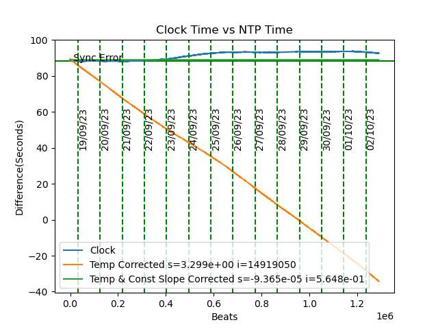

                        Not been idle with my clock.  After moving it to a a dark place to minimise vibration and sunshine, I allowed to run without compensation to see if it’s wandering rate was caused by some sort of compensation error. Appears to be so, but the reason remains unclear.
                        In the graph, the blue line is the uncompensated clock, and if zoomed in on closely, it shows variations due to temperature.   (The graph scale hides detail).
                        The orange line is clock time compensated for temperature only – nearly straight, with slight wiggles due to uncompensated air pressure variations.  The straight line is encouraging, but not that constant down slope. Should be horizontal.  The cause unknown, maybe my shaky maths is missing something.
                        DRIFT
                        Compensating for the constant error hides the problem, and the green line keeps excellent time.  As having the clock apply a second compensation to fix the orange slope is a bodge, I need to understand what root cause is.  At the moment, I’m baffled, yet again!
