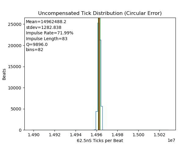

              Good result from last night's run:
              Periods (in 62.5nS ticks): min 14914516.0 mean=14949452.289 max=15017427.0
              dev = 3586.463 ticks
              Clock Mean Period = 0.934341s
              Actual Mean Period = 0:00:00.934465
              std = 0.224us
              Q = 7048
              clockStart = 2023-04-29 20:05:42
              ClockEnd = 2023-04-30 09:18:22.578480
              ActualEnd = 2023-04-30 09:27:20.791752
              ClockRun = 13:12:40.578480 (47560.57848s)
              ActualRun = 13:21:38.791752 (48098.791752s)
              Difference = -538.213s (-1.118975% -11189.746ppm)
              Drift Constant Correction = 10453.0
              The uncompensated clock ran nearly ten minutes slow after 13 hours, but the drift is constant, trivial to compensate, this lovely straight line graph:

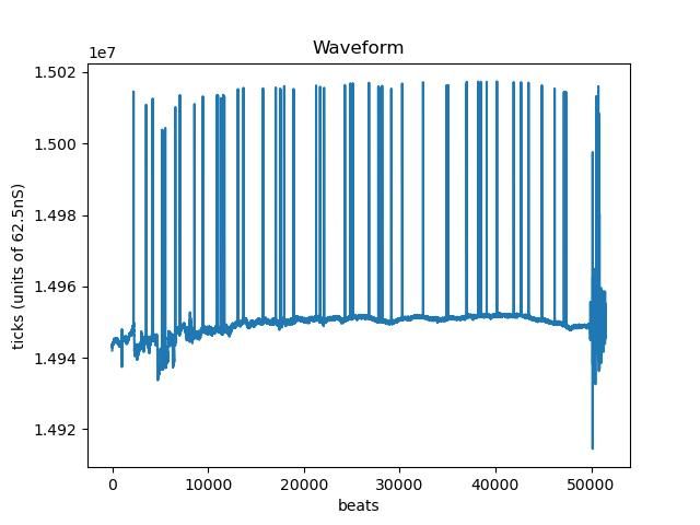

              I've sussed out what's causing the comb on the waveform graph:
              I noticed the comb peaks follow the true waveform and seem to be the same size. They are! The raw data shows they are close to 65536 above normal, 2^16, which happens to be the value added when the program tests for a near miss counter overflow:
              // Correct if just missed an overflow
              if (TIFR1 & bit(TOV1) && pendulumCountAtEventEnd < 128) {
              pendulumOverFlowCount++;
              I copied the code from my hero Nick Gammon, but have always been suspicious of it. I believe it's meant to deal with the counter overflowing at about the same time a pendulum event is received. I shall have to study the datasheet again. Although the comb looks bad, it doesn't matter much in practice. Determined to understand and fix it though.

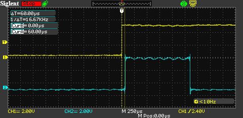

              Another potential cause of noise on the pendulum is under investigation. It's the delay between the microcontroller detecting the bob and firing the electromagnet. I wondered how big the delay is, and if it varies much. This is typical:
              Pendulum in yellow, magnet power in blue. The electromagnet is energised 60 microseconds after the bob breaks the IR beam. My test sample is very small, about 30 example, but the 60uS delay doesn't seem to vary. The main thing that would delay the magnet further is the clock receiving a command just before the beam is broken. Not likely because commands are sent at start of run to configure the clock and shouldn't be necessary after it's set.
              Does anyone know how long a mechanical impulse takes between trigger and energy reaching the pendulum? It's not instantaneous.
              I guess several tens of milliseconds in a Shortt Synchronome where the second pendulum operates a ratchet wheel, that releases a gravity lever dropping a small weight on the pendulum, operating a mechanical electric switch on the way. The switch releases another gravity lever that drops a weight on the first pendulum. Much slower than 60uS I suggest, plus variation due to the switch contacts, inertia and friction.
              However I suppose the delay, whether mechanical or electronic, doesn't matter provided it's always the same-ish.

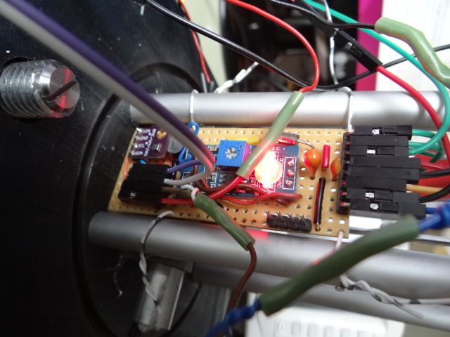

                        Fixing the electronic mistakes took most of Sunday afternoon and didn't work when reconnected to the clock, so lashings of despair. Another silly mistake.
                        I'm not happy with the board – the layout was flawed, before I messed up! Had to mount the pressure/temperature module close to the switching transistor, not far from the cast-iron base, comparator chip, two LEDs, and the electromagnet coil. These the main sources of heat inside the vacuum containment, and may cause trouble.
                        A test run with the pressure/temperature module showed it works, but the log contains a high rate of false break readings, due to the beat counter occasionally triggering on both rising and falling edges. Not sure what causes this. As the input waveform is clean, it may be software: reading the pressure/temperature module, or maybe the extra time spent transmitting their numbers to the raspberryPi (which logs them).
                        Previously I was going to attach the electronics to the sensor chariot. It's easier to tie it to the pillars:
                        Didn't bother to tidy-up the wiring: saving that joy until I have a neat way of getting it through an airtight seal to the microcontroller under the base.

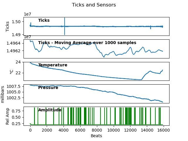

                          Pleased to report, fingers crossed, that I've fixed an intermittent problem that's been annoying me for ages. It's that,rarely and apparently randomly, the clock registered a double beat. The false beat occurred on the FALLING edge of the beam break, when the microcontroller was programmed to repond only to RISING edges. Should be impossible, and I've been chasing all manner of esoteric and unlikely causes – many hours wasted.
                          Seems the actual cause was electrical noise on the input. Microcontroller inputs are vulnerable because they're high-impedance, making it possible for them to pick up glitches on long wires, or even from adjacent pins. The cure is to tie the input either HIGH or LOW with a resistor, about 10kΩ. It stops static and soaks up short spikes. Looking very good so far, zero false triggers in over 12 hours.
                          At the moment I'm running the pendulum uncompensated to determine it's characteristics. Nice straight line on the drift graph, and period only varies up to 80 microseconds per beat, much better than the Mk 1 clock, with a sharp evenly balanced distribution, hurrah!
                          Annoyingly, the good weather is failing to provide the variety of big temperature and air pressure changes needed to calibrate the pendulum: correlations are identified, but not strongly, meaning compensation values based on them won't cover winter and summer confidently.

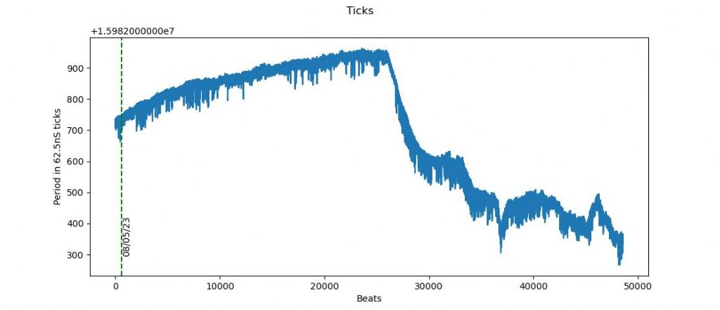

                          The spiky green graph shows something is still wrong with the amplitude code or electronics. (I hoped the resistor would fix it, nope!) Even though the error rate is only 0.5%, and the affect of each error on the pendulum trivial, I want to fix it.
                          Comparing last night's run with actual time this morning showed the the clock should be set to an average period of 0.935266s rather than 0.924012s. Period was set to 0.935266s and the clock reset to UTC this morning. If that works, the clock should run close to UTC, but is still uncompensated. However, weather permitting, it will collect enough tempertature and pressure changes to enable compensation.

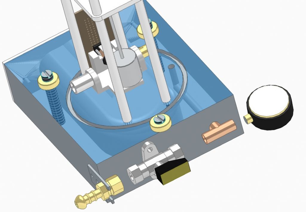

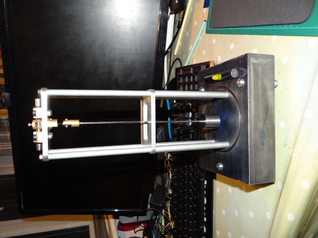

                          Progress is promising enough for me to tackle the vacuum containment problem, difficult enough for it to be worth it's own thread. The parts needed to plumb it have started to arrive.
                          First attempt at plumbing was this:
                          Rubber hose from vacuum pump attaches to a nozzle connected to a valve, connected to T-coupler. Vacuum gauge on the end. Unfortunately, this configuration requires a ⌀ 6-8mm hole 100mm deep to be drilled accurately straight into the block. If it drifts, there's a high risk it will break out into the lower cavity.

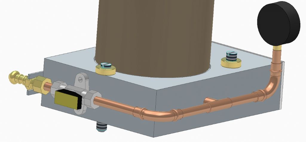

                          Second attempt avoids the need for deep drilling, but more pipe and joints. The vacuum gauge can be upright at the front:
                          The more I think about how to contain the vacuum, the more difficult is seems. I'm after a deep vacuum, and yonks ago Roger Atkinson said of my Edwardes EB3A pump "Specification seems to be 26" Hg / 133mB", about 86% vacuum. Not bad for a home clock, but ideally the vacuum has to be held steady for years. The container holds about 2 litres of nothing, so a leak of only 1cc air per day is cause for concern.
                          Leaks are less worrying if the pump is in poor condition and can't get that low a vacuum, but then the clock won't achieve it's best.

                              This morning's results are disappointing – looks like drift correction isn't working, possible because I 'improved' the code. The slope after correction last night is much the same.
                              The sharp drop down to zero before midnight is me resetting the clock to UTC. The 1 second leap this morning, right of graph, was due to cat jumping on the table. Cats and clocks aren't a happy combination.

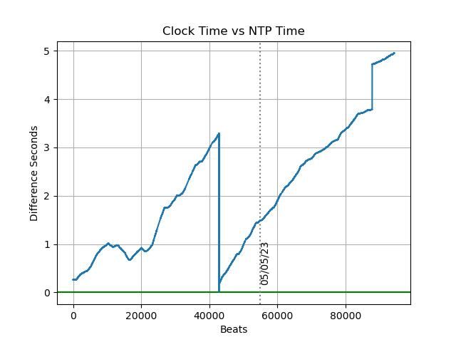

                                My dining table being a poor platform, I moved the clock to a solid window-sill and have left it running to see how it performs undisturbed.
                                Meanwhile, I thought it would be useful to test the clock's software and measurement system with a perfect pendulum. The closest I can get to perfect pendulum is extremely good – it's the seconds pulse output of a GPS module, accurate within about 45nS.
                                I connected GPS pulses to my clock's pendulum input to see:
                                • how stable the microcontroller's ceramic resonator is, not expecting much.
                                • how well the clock beaten with a perfect pendulum keeps time compared with NTP.
                                • how much the transfer time over USB from clock to Raspberry Pi varies.
                                Stability of the ceramic resonator is poor, varying by about 38 microseconds over 13 hours. Most of the swing is due to temperature change, but stability between cycles is also poor, varying by about 1.23 microseconds on each beat. The nominal frequency of the resonator is 16MHz, its mean frequency in this run was 15.982708MHz
                                The weak performance of the resonator also shows up in the dispersion graph below. The graph should be a bell curve symmetric about the mean, and it's mangled. As the GPS pulse is near perfect, the mangling is caused by the resonator mismeasuring it, rather like checking gauge blocks with a 6" rule.

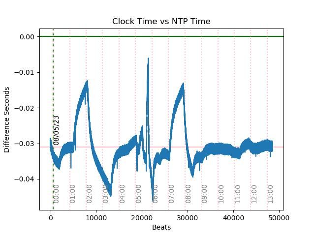

                                In this run the clock finished at 2023-05-08 13:19:00.0 whilst NTP reported 2023-05-08 13:19:00.031074, an error of 31.1mS Actually better than that because the synchronisation error (setting the Clock to NTP) was wrong by 0.030496s, making the actual error at the end of 578 microseconds.
                                However, graphing clock against NTP shows NTP bounces about!
                                Although NTP is never more than 30mS wrong, and is mostly closer, the graph shows each measurement varies by about 2.5mS. Part of the jitter is due to variations in transfer time – how long it takes the clock to resister a beat, assemble logging data, put the data on the line, and then for the Raspberry Pi to receive, decode and timestamp the data. More work needed, but transfer time appears to be fairly constant.
                                In short, although the clock and measurement system both work correctly, hurrah, feeding them a near perfect pendulum shows plenty of room for improvement! If my pendulum runs really well in a vacuum, I may find the measurement system needs to be updated. Fairly obvious steps include GPS disciplining NTP on the Raspberry Pi, and registering beats by signalling the event from clock to Raspberry with IO pins rather than USB serial.

                                      Yes, NTP over the internet, a deep subject in itself! How vague internet time is considered to be is relative! It's much better than most clocks.
                                      The protocol works in a hierarchy, where Stratum 0 is a server connected directly to an atomic clock. These update a large number of nearby Stratum 1 servers, which in turn update Stratum 2 servers, which update more distant Stratum 3 servers on the internet. Each level is less accurate than the one above, but the protocol minimises this by constantly exchanging network latency timings to decide which of many servers are currently providing the most accurate time; the system automatically adapts to network performance.
                                      Typically, an NTP time server on the internet available to Joe Public, is better than 10mS of UTC.
                                      Accuracy suffers when connected to an ADSL consumer like me, but should still always be within 100mS of UTC. In my case, a further loss of accuracy occurs because my Raspberry Pi logger is WiFi connected. However, despite that, the results show the Pi's notion of UTC during the test was always within 30mS of GPS UTC. This is better than almost all clocks.
                                      On boot Raspberry Lnux calls pool.ntp.org to get a list of NTP servers in the UK, and then runs an algorithm to select the best (which is usually the geographically nearest). Plenty of choice – there are 193 NTP servers available in the UK this morning. I might do temporarily better by selecting one manually, but allowing the system to adapt automatically does better in the long run. (Unless I happen to be sharing a building with a Stratum 1 server.)
                                      It's possible to connect a GPS module to a Raspberry Pi and synchronise it to GPS UTC. In effect this eliminates network variability by promoting the Pi to Stratum 1-ish level. A GPS synchronised Pi keeps time within about 1mS of UTC. I may have to do this upgrade.
                                      The operating system and how it's configured make a difference too. Bog standard Windows is a worse timekeeper than Linux and MacOS, because Windows corrects the computer's internal clock from NTP less often. Internal clocks are rarely awful, but the best are noticeably worse than a quartz wristwatch. Microsoft letting the clock drift doesn't matter for ordinary purposes, but it does in this application. If I was using Windows I'd reconfigure it to synchronise with NTP more often.
                                      Am I getting the very best from what I have? Very doubtful – keep the suggestions coming!

                                                    Have you tried running your own NTP server on your local network..??
                                                    This would give a lot less jitter (due to using the greater internet..)
                                                    Seems to be fairly easily done on a Raspberry Pi
                                                    https://www.satsignal.eu/ntp/Raspberry-Pi-NTP.html
                                                    is just one of many google hits on the subject….
                                                    I hope that I haven't sent you down another rabbit hole!!
