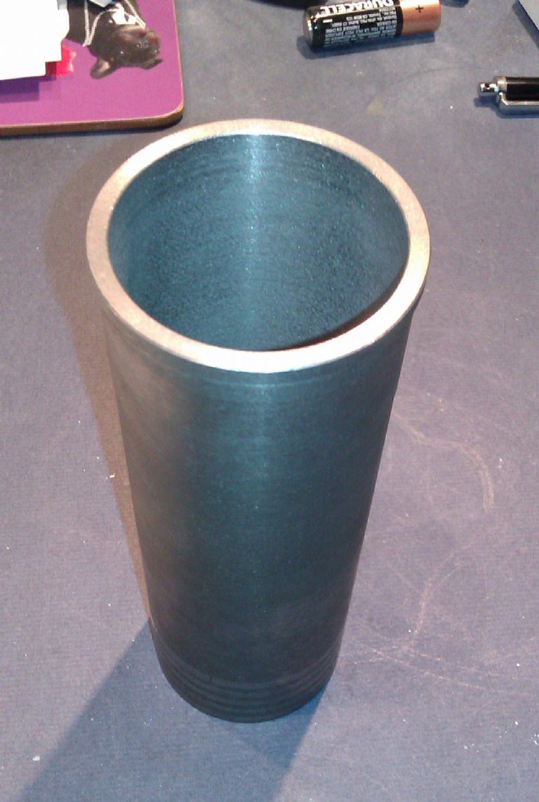

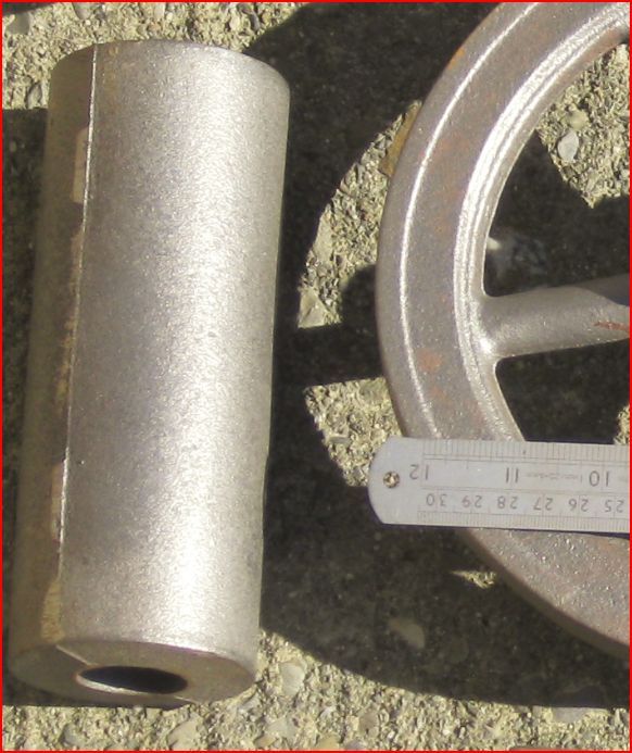

        For a bit of Sunday afternoon fun as you may have seen in the "What did you do" thread I have been machining the cylinder liner for the ball hopper Monitor. This is supplied as a cored casting approx 2.75dia x 7" long with approx 1.25" core.
        This is the finished item, 1.808" average OD, 1.625" ID and 5.25" long
        So who wants to take a stab at what percentage ended up as swarf? and for a bonus point the initial and final weights. No prizes except the fact everyone will think you are a know it allsmile p
        J

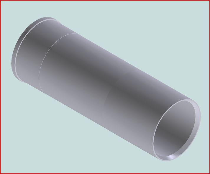

              For 'typical' cast iron, I get it at 3.905kg for the starting weight and 0.307kg finished weight.
              Swarf is -92.138
              EDIT. I'm cheating too – my result is straight out of ViaCAD disgust

                          Three entries and three different winners.
                          Percentage was 92.3% so Andrew was closest with 92.15%
                          Weight of original was 3870g so Blowlamp was closest with 3905g
                          Final weight was 298g so so Neil was closest with 300g.
                          Neil it would have been better if they just supplied a length of 50mm CI bar plus it would have been nicer iron as this was quite grainy and hard.
