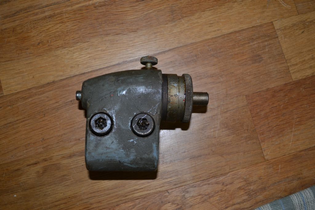

        unknown2.jpgI would appreciate any help in identifying what this fitting is – it looks like it fits onto the bed of a lathe, and I thought it was a mini-tailstock of some kind. However, when searching using similar terms I could not find any similar image, neither could I find information which would identify it.
        Thank you for any help.
        Cheers

          Its a micrometer stop that goes before the saddle near the headstock and stops the sadlle at a point set by the rod sticking out

                Micrometer saddle stops like this were/are available for a wide range of lathes. Boxford use one similar to this, which looks as though it clamps onto a 'V' shaped bedway, but the Boxford ones I have seen are smaller, having only one clamp bolt where this has two. Maybe a different version.    Perhaps from a Colchester?

                            I reckon it’s from a Harrison L5 or 5A – it looks very familiar !

                                Hi, definitely a saddle/carrage stop, there is a photo of a Boxford one in this **LINK** the little knerled screw at the top is for locking the rod in position once it is set.
                                I would think it would work on any lathe that would accomodate the V or could be modified like the one in John's photo.

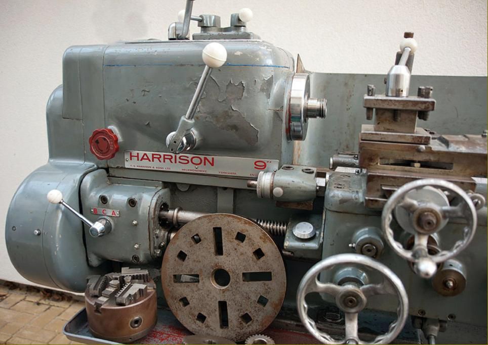

                                #162889
                                Rai Liiv
                                  @railiiv91730
                                  Hi there
                                  Well! I have finally found it! It is a Harrison micrometer carriage stop and the photo, taken from the site http://www.lathes.co.uk/ and many thanks to them, is specifically on a Harrison L5. I have it on EBay at the moment and I thought it was some kind of mini tailstock that could be fitted to the main bed somehow. Ah! Well. All's well that ends well!
                                  The link to the page is here – http://www.lathes.co.uk/harrison/page19.html – for more photos.
                                  Many thanks to all those who gave time.
                                  Cheers
                                  Rai
