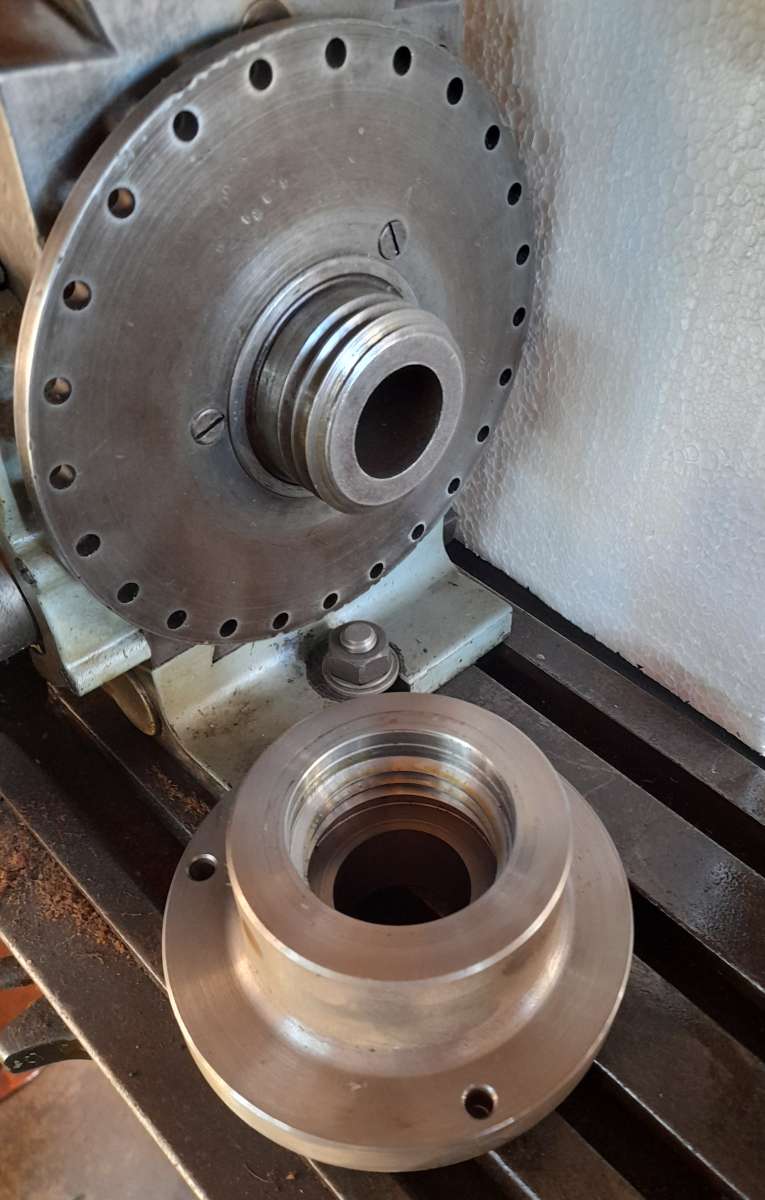

      I have a threaded back plate for lathe that is looking for a new home. It came on a 6″ Pratt 4 jaw independent chuck that I bought off eBay a few years ago.
      It appears to be a 2″ x 4 TPI 60 degree thread. It could be 6mm, it is hard to get my short thread gauge in and to see at the same time.
      The plain register is 2-1/16″ (if it’s imperial).
      Any ideas as to what lathe this make/model lathe it would fit?

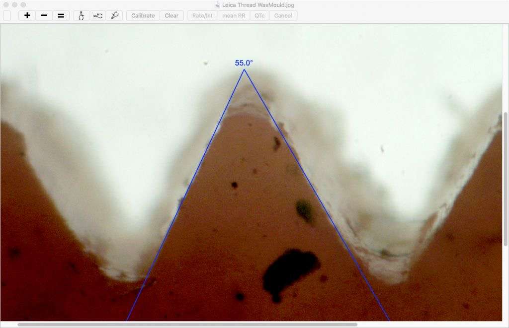

            As I have stated repeatedly … it is a simple matter to take a wax impression from a thread, and [at the scale being discussed] it  should be a trivial task to distinguish between the Whitworth and Unified thread-forms

                      There is a possibility that it is not from a lathe, some dividing heads have threads.
                      I will ask about it on the Home Shop Machinist forum over the other side of the pond.
                      #841468
                      Andrew Crow
                        @andrewcrow91475
                        That’s not a bad guess “old mart” if I recall my Brown & Sharp dividing head spindle has a large diameter very coarse thread. I will check it in the morning as I have to remove the adaptor plate which I made so I can take a chuck off the lathe and bolt it straight to the D/head.

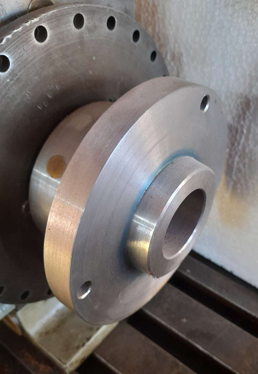

                              <p style=”text-align: left;”>Hello Mark, I think “old mart” has probably got the right idea, although not the same as my Brown & Sharp, having just measured it as 2.5 diameter × 4.5 tpi and almost certainly of American National form.</p>
                              Because of the awkwardness of it,  I made an adaptor to suit the chucks and face plate I used on my old Colchester Student (also with an adaptor to suit a D1 spindle taper) so I could transfer between the two  without disturbing the job.
