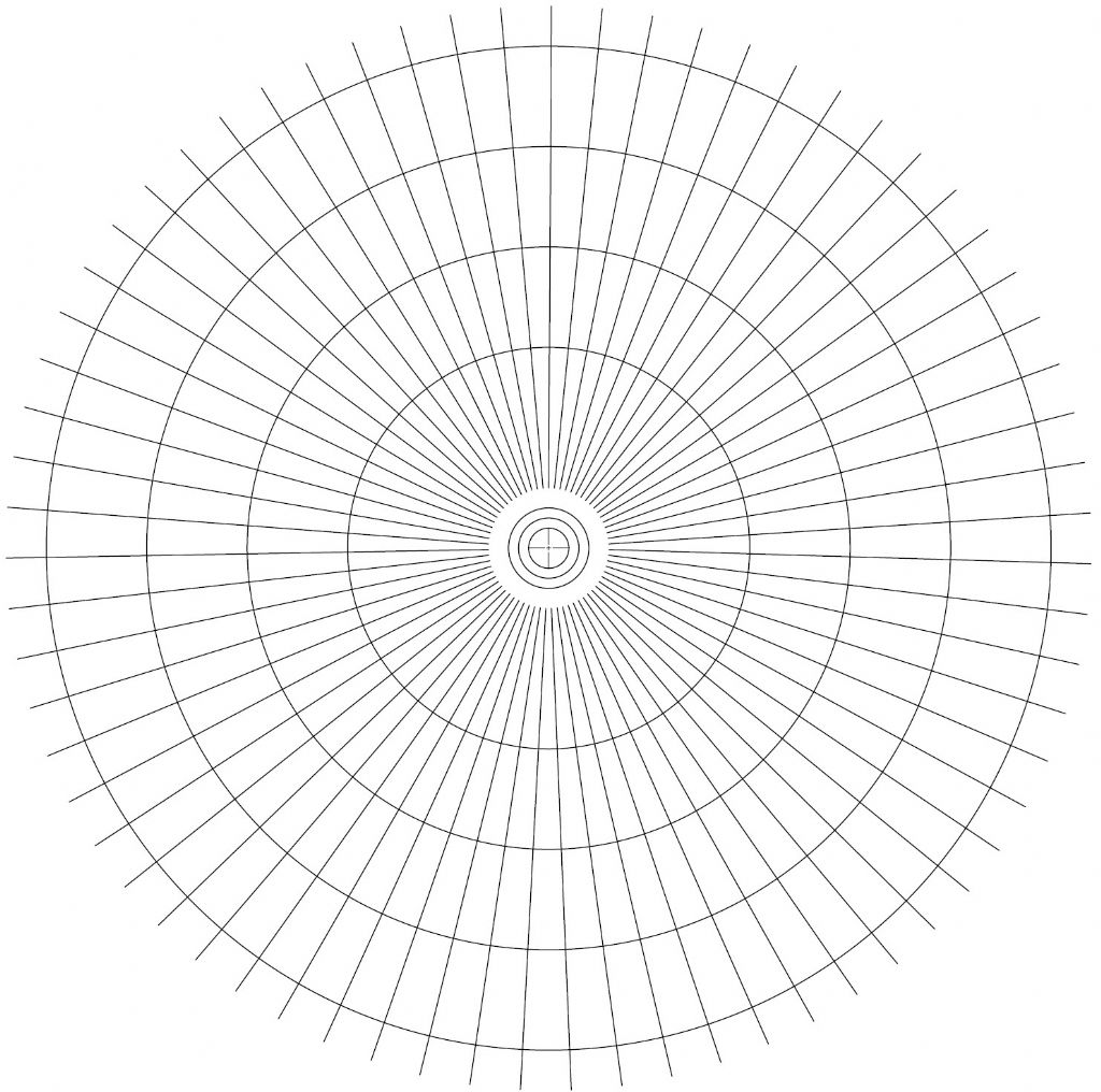

                        Hi All
                        Use CAD to make a template!
                        Even if you cant use Cad download Draftsight or any reasonable CAD program that can accurately draw a circular array and copy a radial line around a center point. Just learn to do this operation not hard.
                        If you really need accuracy get it printed on a large sheet of paper at a copy center. as big as you can manage. Then attach it to your work and use it as a template.
                        I would be happy to make a PDF of one with the required number of divisions if any member wants one.
                        The accuracy of the printed image is very good Most printers these days print at 600 dots per inch or better.
                        Regards
                        The image below has 67 divisions
                        Edited By John McNamara on 14/06/2016 14:26:29

                            Printer resolution (dots per inch) might be getting better but that does not necessarily mean they are the same size in X and Y.

                              When thinking about using a paper printout the I was reminded of the dividing engine of old.
                              It relied on a very large wheel to reduce the error when dividing smaller diameters, Hence the suggestion in my previous post to use as large a sheet of paper as possible. if say the piece of paper was A0 plotter paper (841 x 1189 mm) it would be easy to draw an 800mm circle of marks on it. If your mill or drill press has a throat of 400mm you could mount the part to be drilled on a disc of say MDF with a decent metal bearing in the centre to rotate it on. you would also need a firmly attached datum point attached to the frame to align the marks on the disk to, ideally with a magnifier to help alignment. I would simply tape the sheet on without adhesive.
                              Assuming the desired circle to be engraved or machined was around 150mm there would be a 5 fold reduction in error with an 800mm diameter disk. The disk could be reduced to fit your particular machine.
                              The lineweight of cad lines can be set .05 – .1mm is typically the finest available, with reasonable magnification it should be possible to center on the lines anyway. There is no need to worry about the resolution of the printer varying between the x and y direction the C software will adjust for this.
                              I guess the last consideration is the paper itself It can move with changes in moisture, probably not a major issue however for the finest work you could print on Mylar sheet, The downside being cost, plain paper black and white A0 plan prints are inexpensive **LINK** (I have no conection with them) less than a pound. Mylar will add to the cost…. a few of pounds more. For a one off quick use I would not bother.

                                  An 800mm circle divided into 5000 will have divisions 0.5027mm apart easily resolved with the eye for someone with reasonable eyesight. With a magnifier a fraction of that. maybe two thousandths of an inch = .0508mm
                                  That's 50 thousand divisions.
                                  We will never need that many divisions, we will only print the divisions we need, it does however give us some perspective into the method.
                                  The work piece marks or cuts being of a much lessor radius increases the accuracy, it is much greater dividing the error by 5
                                  Pretty accurate for a piece of paper!
                                  No special plates or worms or even a dividing head or rotary table for that matter. A disk with an accurate centre bearing fitted is all that is needed. For a few pence to print the paper we have made a very accurate template.
                                  Most rotary tables and dividing heads exhibit various accumulated errors, they have bearings, worms, gears, selector arms, slip fit in hole sliding pins. and other sources of error.
                                  The method proposed has only one bearing and the print errors to contend with. It would be interesting to do a direct comparison.
