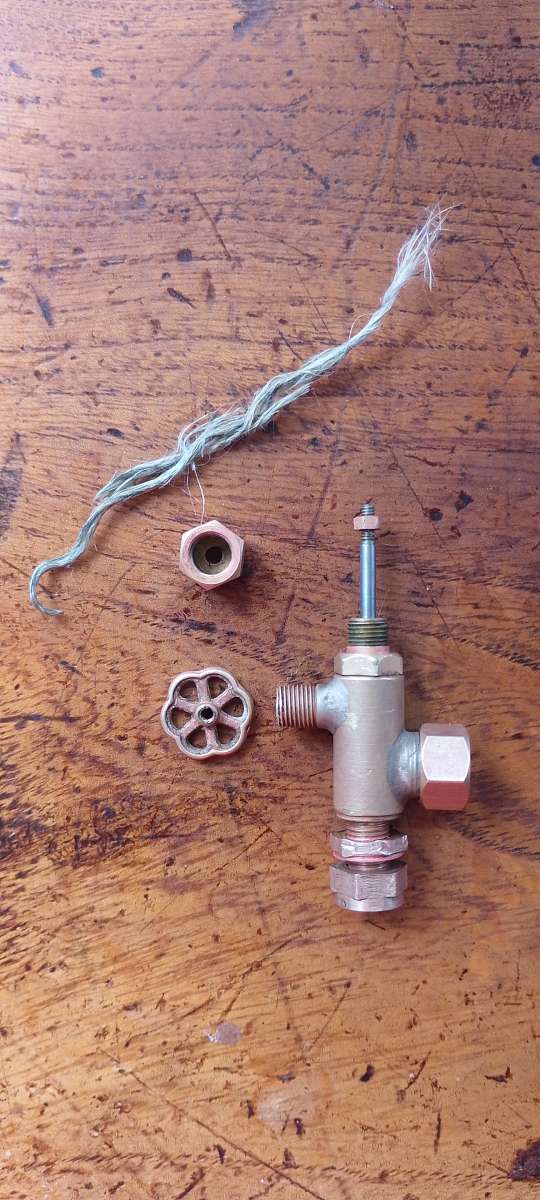

      IMG_20260514_113824I am in the process of putting my boiler back on the loco having just had it tested at Western Steam. I thought I would give all the boiler fittings a good clean before reattaching them to the boiler. On checking the seal in the valve I was surprised to see that a rubber seal had not been used and instead some sort of fibre was used. Does this need to be replaced with a rubber seal or could I just use ptf tape. I also need to replace the gauge glass but this is 4.5mm and I can only find 4 or 5 mm glass. Replies would much be appreciated.

          Graphited string is the traditional material. It works so why change it

            yes stick with the string rubber at elevated temps is not good

              Graphited string as Duncan says, if string is too thick, split the strands apart and use them. Buy a chunk and keep as come in handy for next time.

                  Synthetic rubber O-rings work in these fittings. They are of ‘Neoprene’ or ‘Viton’ but I’m not sure off-hand which is the better here.
                  Do not use PTFE tape on boiler fittings. It shreds and the slivers can make mischief in clack-valves, injectors and gauge-glasses.
