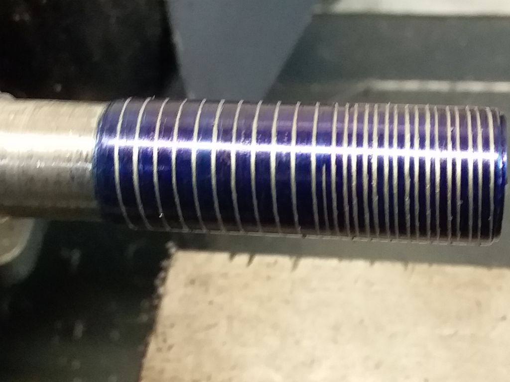

                Hopper
                  @hopper
                  Posted by Martin Connelly on 06/02/2022 08:32:03:
                  For short lengths of thread keeping the half nuts closed is not too bad. For a long length of thread you can release the half nuts and move the carriage back in multiples of 5" (127mm) to pick up the correct position on the leadscrew. Your thread dial indicator engagement point will be different for each successive pass. There is a risk of getting the distance wrong if you do not have a good method of ensuring you move the correct distance. Best if the leadscrew is stopped before the half nuts are disengaged otherwise you have to reverse just enough to go back to the thread dial mark that was being used then make the 5" move. A DRO will help as you can set the zero point before moving back….
                  Martin C
                  Well I just had to try this method on my imperial Myford ML7 because it sounds too good to be true — and it does not work, as above pic shows. Lathe change gears were set up to cut a 2mm pitch thread with an 8tpi leadscrew. Carriage movement was measured with dial indicator to be exactly 2mm per one revolution of the chuck. Lathe was stopped at the end of the first pass before disengaging halfnuts and carriage was moved by a carefully measured 5.000 inches and halfnuts re-engaged then lathe started and second pass taken.
                  First pass is visible at the left. Second pass, after using the above method resulted in the double thread on the right hand portion.
                  And I can not see mathematically any way that this method could possibly work. You stop the lathe, disengage the half nuts then move the carriage 5.000 inches or 127.00 mm to the right and re-engage the halfnuts. That would work ok on a 1mm pitch threads. You are re-engaging the halfnuts 127 full pitches away from the starting point. All good.
                  But on a 2mm pitch thread, 127 mm is halfway between two pitches. It needs to either engage at 126mm from the original disengagement point, or 128mm, which would be 63 and 64 pitches respectively. (But of course the halfnuts will not engage at these two points because they are each 1mm out of line with the thread on the leadscrew. )
                  And it does not work mathematically for any other metric thread pitch either. They all work out to oddball measurements, none of them 127mm. As 127 is a prime number, the only pitch that divides into it without getting into fractions of a pitch, is 1mm. It does not work for any other pitch, as far as I can see.
                  Edited By Hopper on 10/02/2022 11:02:32
                  #584871
                  Hopper
                    @hopper
                    OK, so on further thought: If winding the carriage back 5" works for a 1mm pitch, then winding back 10" would work for a 2mm pitch thread, ie 10" = 254mm = 127 full threads at 2mm pitch. And on the same principle, 15" (= 381mm = 127 x3) would work for a 3mm pitch.
                    But what about 1.5mm and 1.75mm pitches etc? Hmm further thought required. As Curly from the Three Stooges said, I tried thinking about it but nothing is happening.
                    Edited By Hopper on 10/02/2022 12:09:32
                    Edited By Hopper on 10/02/2022 12:13:01
                    #584874
                    Anonymous
                      Mathematically the number needed is the least common factor of 127 and a multiple of the metric pitch to make it an integer.
                      For 1.5mm pitch it is 2×1.5×127 = 381 = 15"
                      Andrew
                      Edited By Andrew Johnston on 10/02/2022 12:18:08
                      #584881
                      Hopper
                        @hopper
                        Aha. Thank you. I can see that. Basically half a 3mm pitch so the same 15" point.
                        So I guess .75mm pitch would also be 15". As in 4 x 0.75 x 127 = 381 = 15"?
                        And for .5mm pitch you could use 127mm/5" because it would equal 254 threads.
                        But what about 1.25 and 1.75? I'm thinking 1.25 x 4 x 127 = 635mm = 25", which is probably off the end of the Myford bed someplace!
                        Going the other way, 0.8 x 5 x 127 = 508 = 20". h
                        Could be handy for long jobs for sure. I think I will have to write them all down on a chart though. i will never remember the calculations by the time I ever need to use it!
                        And from my own faffing around in the shed this afternoon, I reckon one could use the thread indicator dial to measure off the carriage movement, rather than wrestling with a digital caliper as I did. One full turn of the TDI dial is two inches on a Myford. (16 tooth gear engaged with a 8tpi leadscrew). So to move five inches, it was a matter of use #1 on the dial for the first pass, then wind back two turns plus a half to get 5", so the #3 on the dial is lined up with the mark. 10 inches would be a matter of five full turns of the dial etc. As long as the halfnuts engage with the stationary leadscrew at that number,you are ready to go. Neat!
                        Edited By Hopper on 10/02/2022 13:48:16
