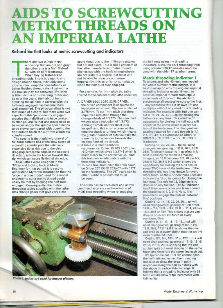

                                                    This is the article i referred to in the the posting at 05/02/2022 22:11:28.
                                                    Using this method allows the motor to remain running ,the spindle
                                                    can be left turning ,the half nut are dis-engaged at the end of the
                                                    pass the carriage returned to the start position ready for the next pass.
                                                    To get the best use from this a true 127 gear for metric conversion
                                                    must be used.
                                                    The article is worth reading and covers all of the points the OP
                                                    asked for.
                                                    I use the same 127/60 tooth gears as in the article,here is
                                                    the change wheel list for all the metric pitches.

                                                      Hello John,
                                                      I was blown away when I read your message. This was exactly what I was looking for. With the engine always running, disengage the lead screw at the end of the thread, return the carriage quickly backwards and engage the lead screw again. Two things remain to be clarified:
                                                      1 the number of teeth that the thread dial indicator gear has and how many notches it has on the dial; Also what module does it have for milling teeth.
                                                      2 I have the Norton box on the lathe; how should i adjust it?
                                                      Regards, Franco
