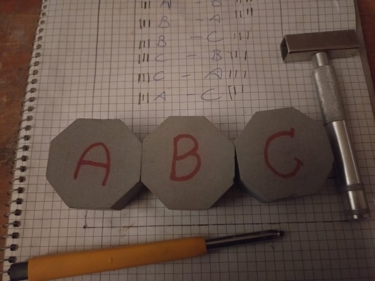

      This project went quicker than anticipated. I figured I should have a set of flat stones in the shop, so I cut out 3 octagonal stones from a cheap two-sided sharpening stone on the water jet (sorry, no pics). I thought I would spend the Christmas holiday lapping them together, but I ended up finishing both sides in an evening.
      This video describes the lapping process: https://www.youtube.com/watch?v=6emh90BexpE

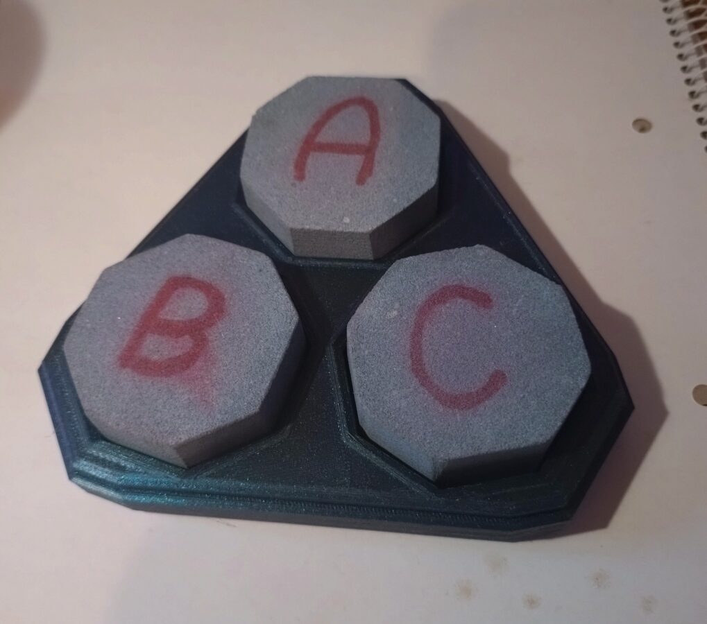

      And of course a 3D printed box to round off everything

        And don’t worry, you can use a hacksaw if you don’t have a water jet. The teeth will of course full in seconds, but it wil still cut. Diamond hones are great for roughing in very uneven surfaces, I also used a coarse diamond wheel dresser to refine the sides.

              The method is usually linked to Joseph Whitworth, but I can’t believe that nobody figured this out before him. I mean, they’d been grinding lenses for centuries at that point. But I also see a lot of people conflating the Whitworth method of scraping with this lapping technique. And while the logic is the same the execution is somewhat different since lapping alters both surfaces at once.

                      @Will: I can’t judge grain shape or anything, but it certainly feels reasonably sharp with dry lapping. Wet had more of a dulling effect. They will of course quickly clog from stoning metal dry, but a quick lap against another stone cleans that up. That suggests that the best way to keep them is to use all three and just keep them lapped against each other with random use and cleaning.
                      I should stress that my stones are fairly soft. I don’t have have any data on it, it’s just a two-grit no-brand aluminium oxide sharpening stone. But a hack saw will cut it even when the teeth are worn completely away, just to illustrate how soft the binder is. It might not work the same with harder stones.
