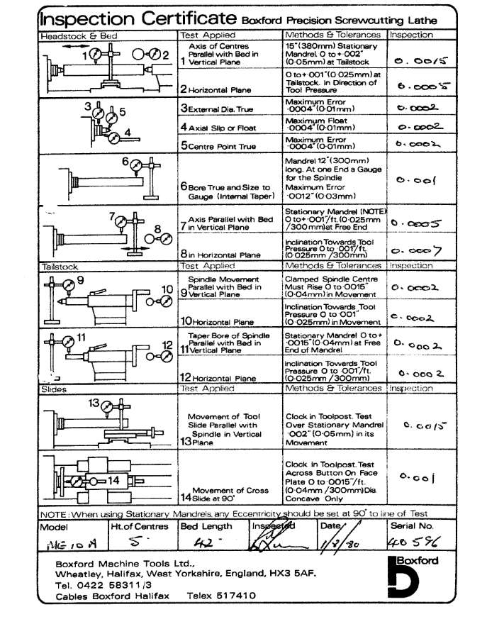

      Hello guys
      I have recently upgraded my lathe from a Mk2 Boxford AUD to a Mk3 AUD. The reason for this is that the new one has a few advantages such as the metric gearbox, longer bed and increased centre height. It is also in much better condition.
      Anyway, the one concern I had when making the swap was that the new one might not be as accurate as the old one. I was hopeful but didn’t know what to expect, after some testing I am gobsmacked! But not because it’s bad, but because it far exceeded my hopes.
      Before I tell you the numbers, I would like to ask, what would you guys expect for spindle runout at the register and face? What would you expect for backplate repeatability? After removing and reinstalling the chuck? Etc etc. Bearing in mind the lathe is over 45 years old.
      I’m very curious. Because it’s often said. “Don’t buy an old lathe”.

              #838276
                As far as I know no-one on this this forum has ever said, “don’t buy an old lathe”.   They have said “Condition is everything”, because it’s the machines’ history that matters, not who made it, the number of features, or how old it is.  Old lathes have had longer to be knocked about than new ones, and they don’t come with a warranty.   Ideally test them before buying, not after!
                This certificate might help. Though for Boxford’s somewhat cheaper ME10, I’d expect an AUD to be similar.
                Screenshot From 2026-02-18 17-25-39
                #838303
                Hollowpoint
                  @hollowpoint
                  Thank you. That certainly helps! 🙂
                  Mine spindle far exceeds the maximum error. So I expect that either it has had minimal use or perhaps it has been rebuilt. My spindle error is less than 2 microns on both the face and register! I am very very happy with that!
                  I have also now machined two backplates and tested the repeatability. Again almost unmeasurably low numbers.
                  I think I will now do more of the tests shown above and do a sort of belated test certificate. Just for my own reference of course.
                  Not that any of it matters really, it is far more accurate than I could ever be. It was just the initial “that’s too good to be true” moment that had me questioning my methods.
