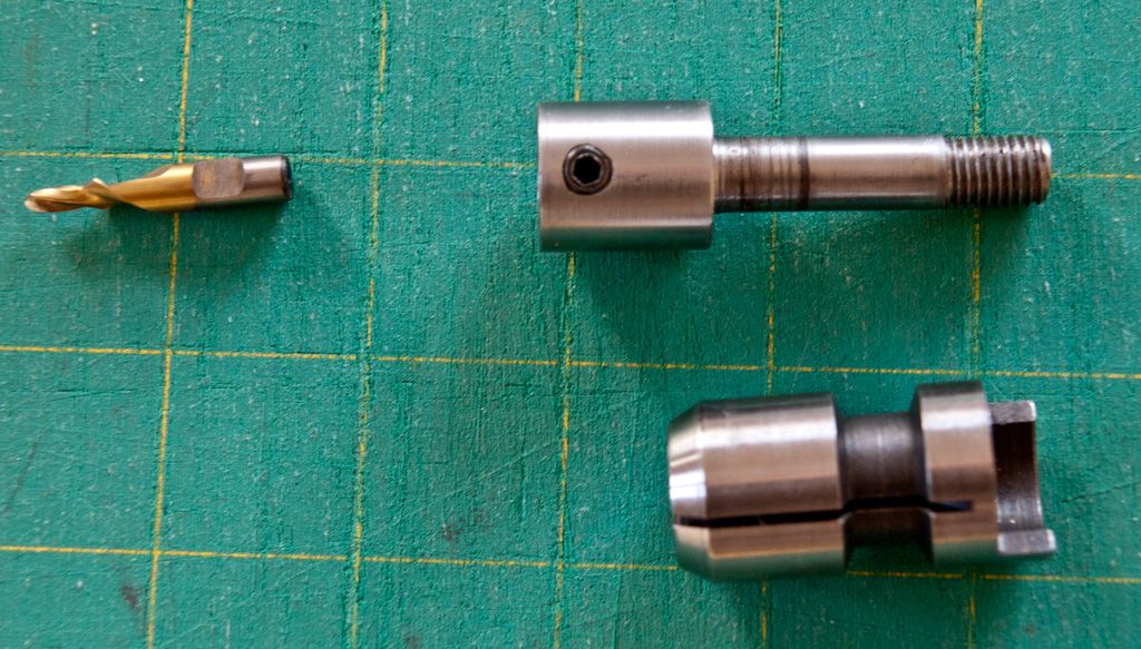

                      #84718
                      NJH
                        @njh
                        Hi Alan
                        Here are a couple of pictures of an adapter I made to fit mini mills in a Pozilock screwed collet. It works well.
                        Quick to make.
                        Yes you really need to be careful with those small cutters – I too know from experience!
                        Regards
                        Norman

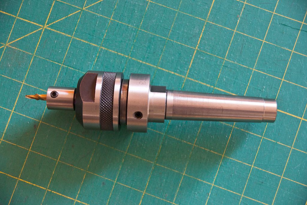

                        #84719
                        Nobby
                          @nobby
                          Hi Ian & Guys
                          They are hard I sliced them of using an elastic wheel on a surface grinder when I was at work. With the same wheel ground a screwdriver slot on the other side.Here is some of the cutter holders I made to screw on my mill drill. Am I drifting away from the thread again
                          Nobby
                          Nobby
