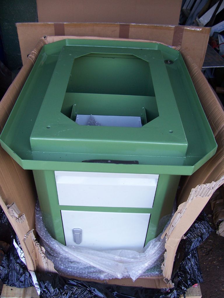

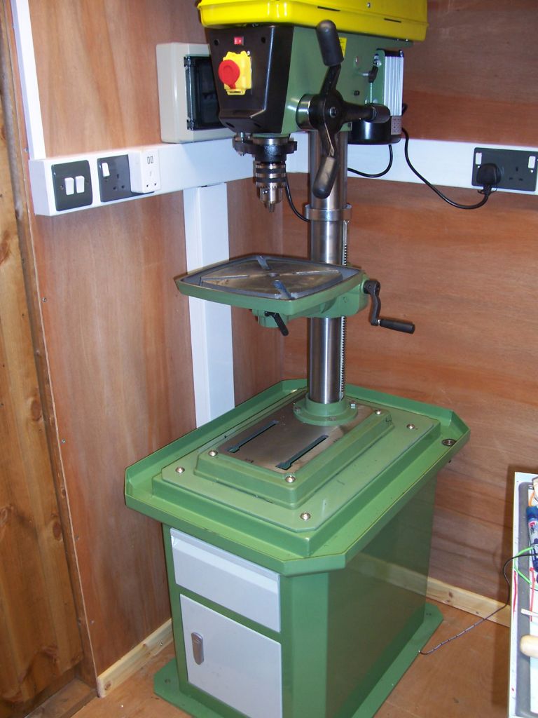

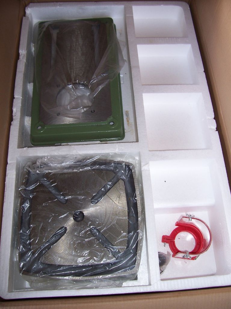

        A couple of years ago I bought an SB12 benchtop drill from Warco, A good drill for the price but I wasn't sure which bench it was supposed to fit.
        Lifting it on to my bench meant that the point of any drill and the swarf flying from it was directly in line with my eyes. That was a no go so the thinking cap had to be looked out!
        I didn't want to build a smaller bench so with faithful measuring tape in hand I came to the conclusion that perhaps a milling machine stand would work.

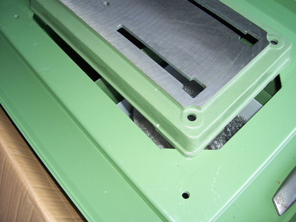

        So it was back to Warco to buy a 3240 milling machine stand. This was not cheap but it was the correct height and had various drawers and a cupboard etc, with a proper splash tray.

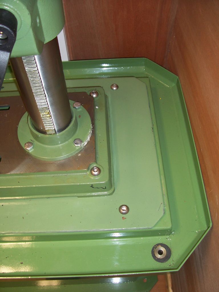

        The various holes did not of course line up and there were bits of thin air around but a trip down the road to my local fabrication shop produced from the back of the guillotine a suitable bit of 10mm plate. A couple of trims in the guillotine had that sorted and I came home as happy as anything.
        A bit of measuring and marking some tapped and clearance holes then a coat of primer and proper Warco green top-coat, delivered in the drawer of the stand. meant it was all ready to bolt together.
        This modification has produced a drill as good as, indeed better than any industrial machine I have used for the last almost 40 years after I fitted a 3 phase motor and an inverter.

          Nice plinth Alistair.
          I had exactly the same issue but I went the other route i.e., I knocked one together from wood, plywood, plenty of screws and some spare MDF. It is now at a much safer height. The other major point for me was to bring the table and work piece low enough to get a good view of where the end of the drill is going.

                Definitely a tidy job Alistair, would a pillar drill where you can usually adjust the height of the head to get the working height to your taste have made life a bit simpler? Very neat solution though with the bonus of storage.

                    Thanks for the positive comments but my main workshop is not nearly as tidy as that one, which is my CNC Mill and Lathe, computer and more technical bits shop.
                    I have Harrison lathe and a Bridgeport mill in my main shed and the reason I bought the drill was that if I just wanted a hole drilled in something then I had to leave the CNC shed, go down some garden steps and along a 40 toot path just to find I had to set up the Bridgeport to put a hole in something! This was OK on a fine summer evening but when it was cold and wintry then it got annoying.
                    I forgot to say that I have recently fitted a digital speed read-out to the drill which reads directly from the spindle so I can still change speed using the belts and get the speed exactly what I want with the VFD inverter.
