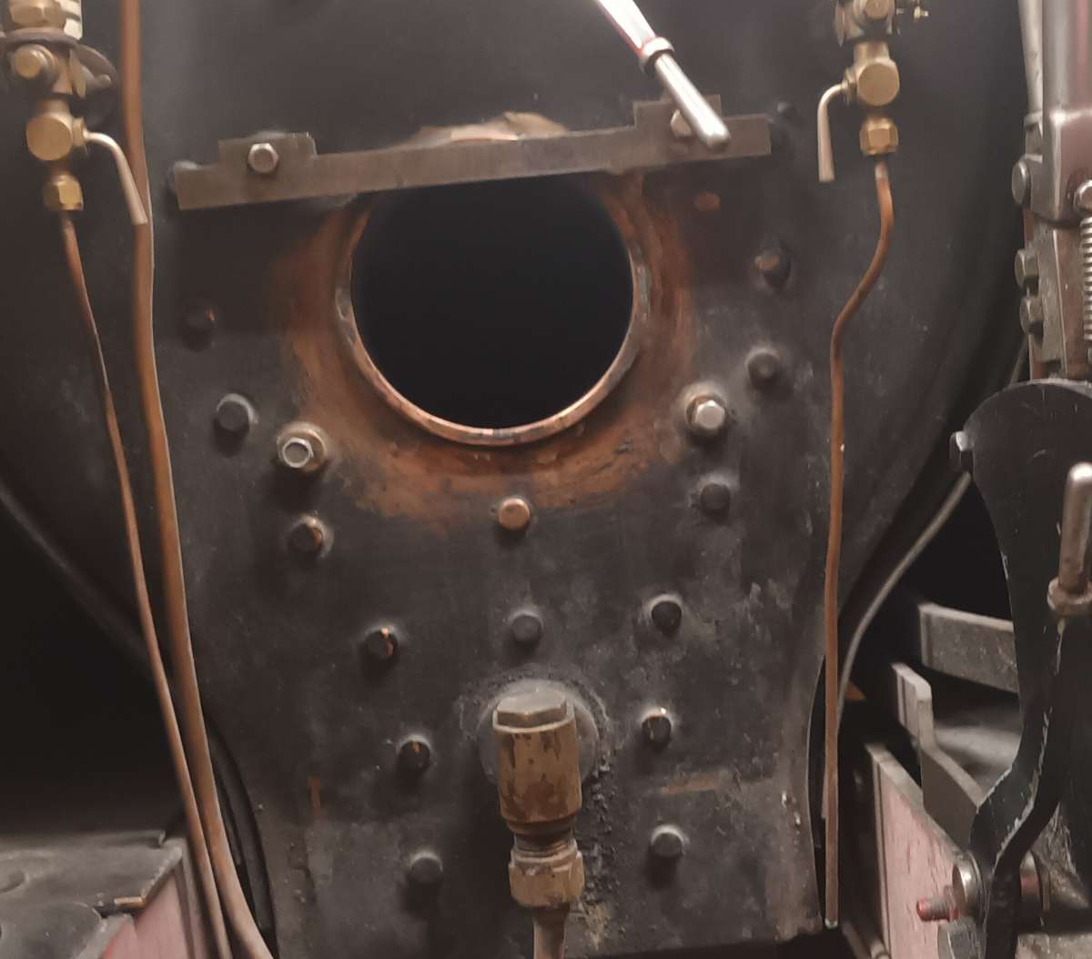

      Hi. I have recently acquired a Winson/Modelworks 45xx in 7&1/4. Silver soldered copper boiler.
      https://www.stationroadsteam.com/7-14-inch-gauge-gwr-45xx-4-6-2t-stock-code-13011/

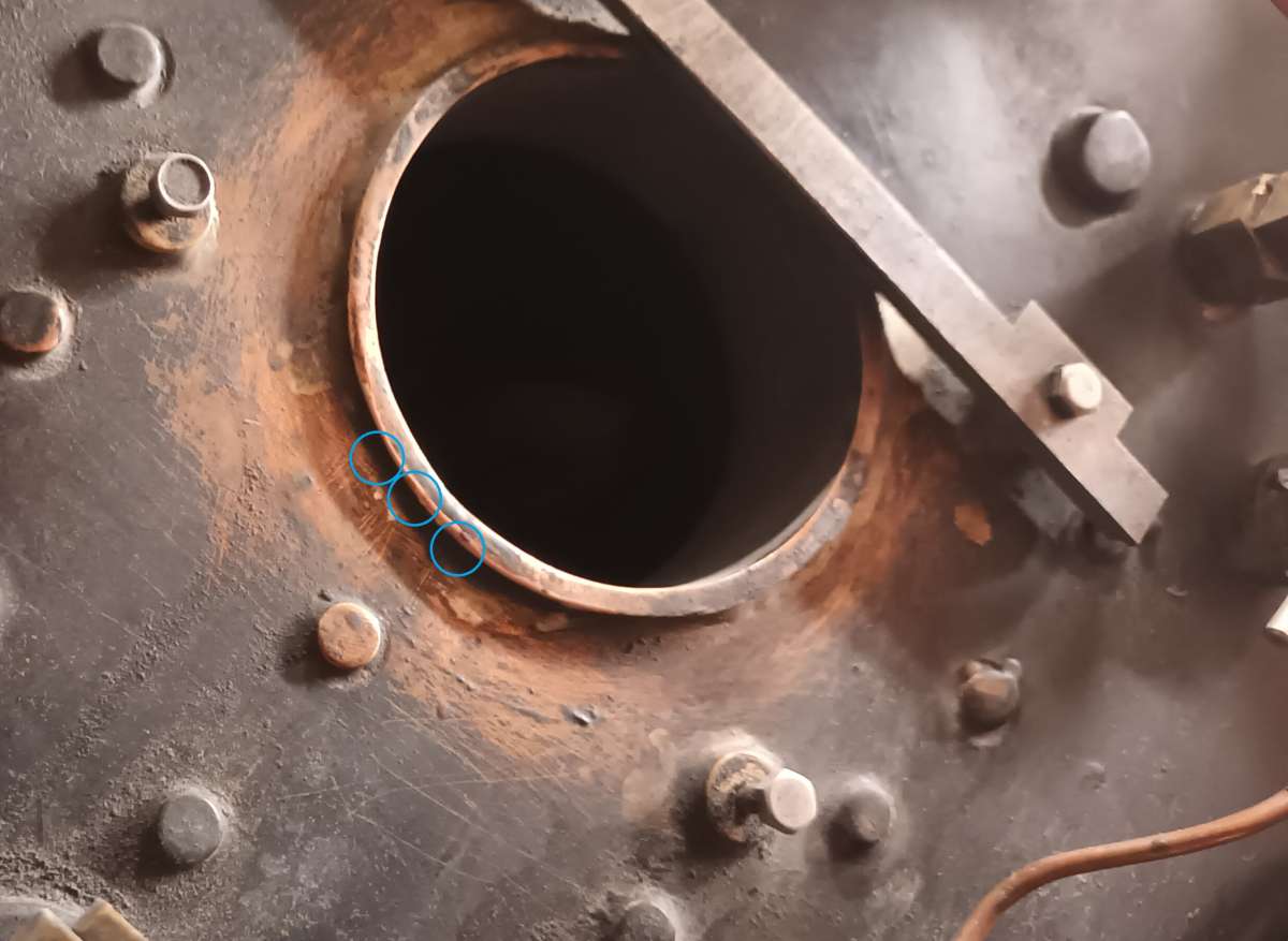

      Having done a hydraulic test on it myself, there are 3 small pinhole leaks around the fire hole door which do not close up when under steam. Silver soldering is pretty much out of the question as I would most likely end up chasing holes around rather than fixing them, not to mention the heat required for such a boiler would be immense. I’ve had three other suggestions, Tig welding, Comsol and punching the joint with a round ended punch to spread out the metal and close the gap. The holes are between the copper and the solder joint so punching could well work and I wouldn’t lose anything by trying that first. Comsol should work in theory. It depends on the temperatures a bit. Tig welding is something I have not done but has the same issues as silver soldering to my knowledge.

      Nigel Graham 2
        @nigelgraham2
        I doubt TIG welding would work. Welding copper properly demands “de-oxidised” quality copper, and anyway the silver-solder would contaminate the weld.
        Comsol ought be satisfactory if you can get it into the joint, but your friendly local boiler-inspector might be wary of it. He or she might wonder about the state of the rest of the joint.
        If the locomotive has not been run much, worn piston-rings seem rather unlikely, but silicon O-rings may be “weaker” than iron ones. Such rings should of course be of a grade suitable for reciprocating seals. Or one was damaged in its installation.
        I’d investigate the valves first as requiring less dismantling for inspection.
        Leaky surfaces apart, the main source of possible blow-by with a slide-valve is the valve unable to “float” properly in its mounting arrangement on the spindle. Either by excessive tightness, or a design flaw. So once you’ve lifted the covers, test for that float first.
        I add the latter reason having encountered a Winston’s Kit steam-wagon that had no way of stopping it, we discovered due to a design weakness compounded by poor manufacturing, of its slide-valve regulator!

          Some people have had success with loctite290 in similar situations. As long as the joint is structurally sound this will seal any tiny pinholes. Google ‘steam boiler leak loctite 290’.

            It’s a Modelworks so almost anything is possible ! I would be tempted to try caulking first IF the rest of the joint is sound. The best advice is to speak to your boiler inspector but not all boiler inspectors have the same views on how a job should be done or what they will accept.
            3 leaks in a small area calls into question the soundness of the joint overall.
            TIG welding would be out of the question.
            Good luck.  Noel.

                      In the cool light of day I now see the 3 little circles !  After VERY careful cleaning up, use a flux and comsol. A good fillet will form in this location. Plenty of heat will be needed even for comsol at this point, you’ll know when it’s hot enough as the solder will flow and wet the surface. It may well have passed a 2xWP test with flux plugging the holes, these have now dissolved. The cause was quite possibly insufficient heat and or (it’s Modelworks remember) insufficient silver solder. Good luck.  Noel.

                        I’ve spoken to almost everyone with experience of steam engines in my local club, including our boiler inspectors. Of course, every one of them gave different answers. Only one person suggested tig welding. I will take whatever advise they give me with a grain of salt in future.
                        Caulking is as I thought, is probably the best first thing to try as nothing is really lost if it doesn’t work. It was also suggested as a first option by the better of our boiler inspectors along with Comsol if that doesn’t work. I hadn’t really thought of loctite. The two I’m seeing for that are 290 and 648. 648 being a thicker liquid so would be harder to get into the joint.
                        The joint appears to be structurally sound. Ive had it up to 1.5xWP 2 times for about ten minutes or so each time and once a bit nearer to 2xWP. There were no other leaks on the boiler itself and the 3 leaks around the firehole door did not get any worse.

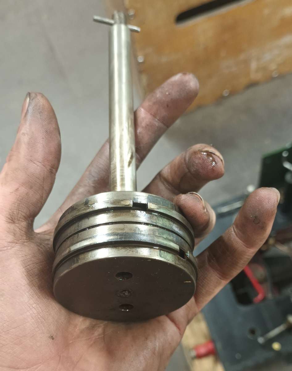

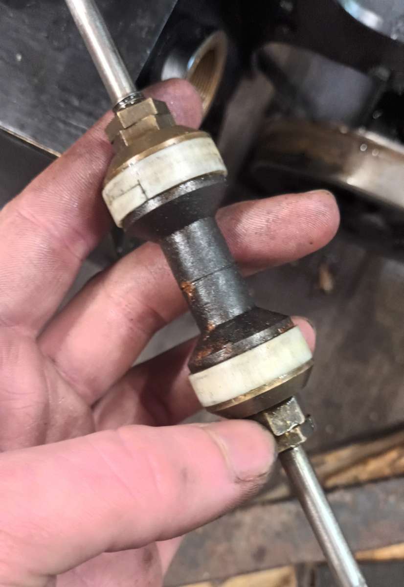

                                I decided to work on the blow by issue first as I can do that without moving the engine. The engine does turn over but needs about 40psi to even start turning its wheels and I had to open the regulator pretty far as well. I wasn’t getting enough air to keep it running though unfortunately. There was air leaking out of the cylinder end caps as it would appear that the gaskets have perished. There was also air blowing by the left piston and quite badly at that. The piston itself isn’t a bad fit but I had it out anyway.
                                20260503_123212
                                The rings are cast iron by the looks of it which is good. However, the rings were completely stuck in with very small amounts of rust. I did manage to prise them open and get them free and then promptly put some oil on and moved the rings about to get it in to prevent that happening again. I would assume then that that was the problem and why it was blowing by. I cannot yet test it as I did unfortunately find that the piston valves were also blowing air very badly. It was not difficult to see why if I’m honest. They were both a rattle fit in the holes. No good. Having taken them out, I was quite surprised to see what seems to be nylon.
                                20260503_113615
                                I didn’t really play around with them like I did the cast iron ones so it may be that they are just stuck in. I’ll have a look tomorrow but that may well not be the case. It might just be me but I’ve never actually come across nylon rings before so I’ve no idea how good they are. That is assuming that they are in fact nylon. If the rings turn out to be scrap, what would be a good replacement?

                                  The piston valve rings or packing should be .PTFE.  Noel.

                                    As Noel says – PTFE not Nylon for piston-rings and rod seals.

                                          On the subject of steam. The boiler is likely scrap. There was an attempt with a lower temperature silver solder which cracked when cooling. It was quite a sizeable crack too. The gap between the ring and the backplate seems quite large. 2/3mm roughly. Comsol was tried and also failed as the silver solder attempt cracked quite a few of the stay joints whilst not sealing the ring crack properly. I don’t think it’s worth any more material or time.

                                              As regards your piston valves they are as already stated most likely PTFE, which once used on steam will let by when run on air, but when tried on steam the PTFE expands and forms a good seal. Try a search on PTFE piston valves and have a look at John Baguleys excellent website where he has used them in a couple of rebuilds. With PTFE valve rings on steam there is a small blow by when the regulator is first opened that seals itself in a few seconds once the rings have warmed up.
