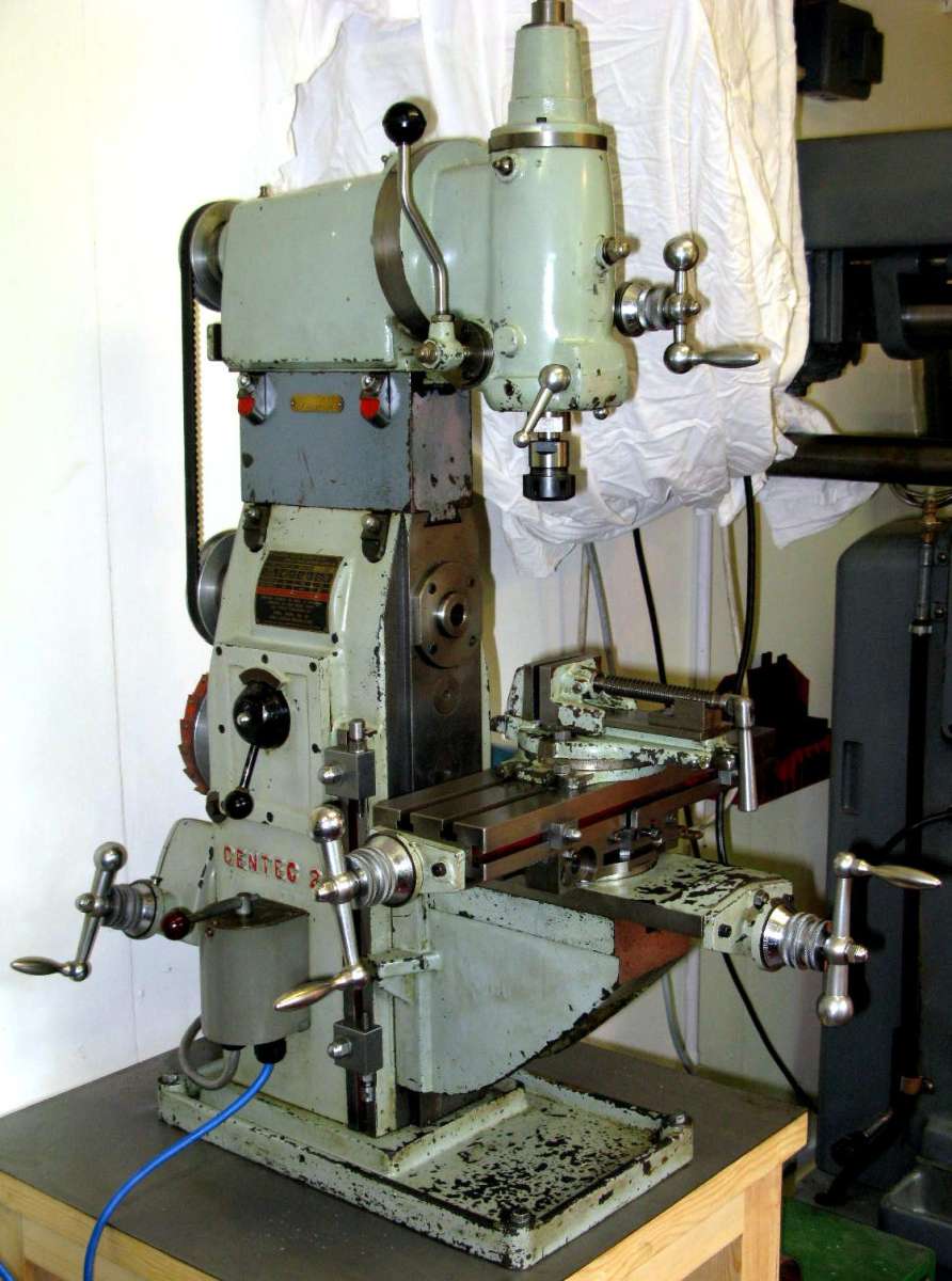

        What about a Centec 2A if you can find one?

            I’ve always thought they were a very nice looking machine for a smaller workshop. And being a proper knee mill would be much preferable to imported machines of a similar size.

              I was keen on a Centec 2A once. Then I saw one close up. There is practically no daylight between the spindle nose and the table unless you get one with a raising block. See picture above and mark where the tool tip will be without the raising block in place! And… wtf thought it was a good idea to have the knee lift round the back of the machine? I guess it was the past, they did things differently then.
              Ended up with a TwinMill instead, simple, solid, but very basic also slightly short of toolspace, but not as short as the 2A. The worst issue is the table traverse is on the right side only, with the leadscrew not extending through the left side. This has complicated fitting a motor drive.
              The smaller VBA Beaver Mill might be worth considering. Almost secured one once, but by the time I’d finished umming and ahing it had gone.
              The Senior E type never appealed to me due to the ‘spaghetti’ width column, but perhaps E type owners with lived experience may wish to make a rebuttal!

                  Blimey! That’s my old Centec in my old workshop, must be from around 2010 or so  has Elliott Omnimill just visible behind it. must be from the photo’s used on the Lathes website when I sold it. Not a bad little mill and it was in very good condition, but I remember finding it annoyingly noisy on the higher speed ranges with all that gearing (I was using it for long periods at high speeds earning my living with it) . Sold both the Centec and Omnimill and bought a Bridgeport which was more suited to the larger work I was doing at the time, bought back a few memories though!
                  PS the Omnimill was a very versatile machine. but quite a bit bigger footprint than the Centec. At the time the riser block cost more than I paid for the mill!
