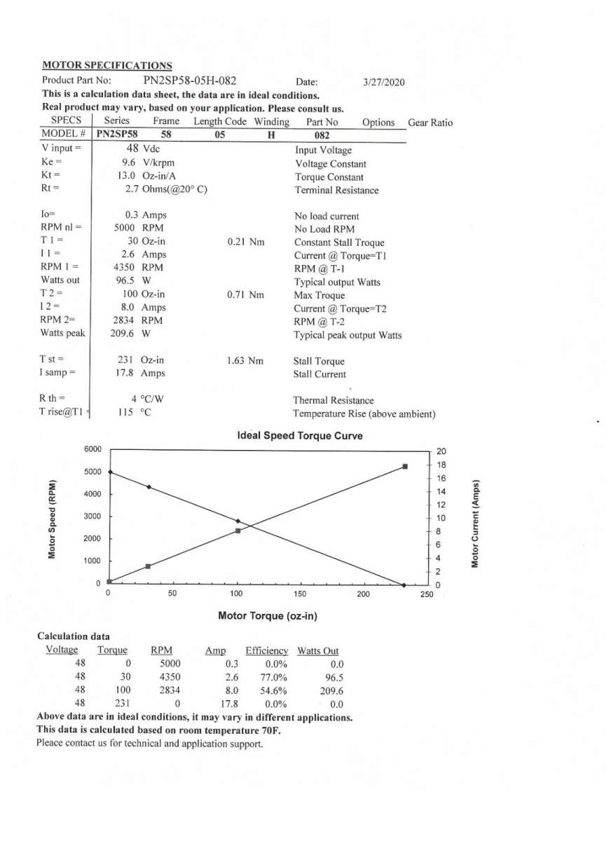

      I’m looking for a DC motor for my watchmakers and found this Torkmotion motor and spec. list. It lists RPM nl = 5000 RPM,  followed by RPM 1= 4350 and RPM 2 = 2834 RPM and the torque and power is different for each RPM. If I wanted to use it at RPM 2, so it will provide 209.6W, does the RPM have to be set at that speed using motor controller?
      And, I’ve tried attaching a jpeg of the spec sheet by dragging the file into the attachment area and it shows up below, but when I do a preview it’s not visible. What am I doing wrong?torikmotion 48V

        Not sure what you will be turning on a watchmakers lathe that will need 209 watts of motor power.
        You are misreading the spec sheet. At 48v with no load that motor will run at 5000 rpm. As the torque load on the motor increases from zero the speed will fall, and the current drawn increase. RPM 1 and RPM 2 are simply data points on the manufacturers (theoretical and ideal) load speed curve at 48V. Without more detail it’s impossible to say how the torque speed cure will shift as you reduce the voltage.
        For a watchmakers lathe motor that you want to run at say 3000rpm max, a 100w 3000rpm motor will be more than adequate. Something like this .
        PS the seller of that motor on Ebay rates it at 96W not 209. 209 Watts is the power consumption when the torque drags its speed down to RPM2. Given that at T1 the spec sheet says the temperature will rise to 115C above ambient, at RPM2 its probably going to glow red hot!!

          The Torkmotion motor is a servomotor. While it will work it’s not optimal. The one linked by Peter is a better choice.
            True of all electric motors.  Though related torque and power aren’t the same thing.   For a given motor and load, the relationship is best expressed as a graph.  Your table gives a partial view.
            The figure that matters is Typical Output Power, with the sweet spot occurring at 4350rpm, and a load of 0.1Nm, when the power is 96.5W.   This is a 100W motor, intended to run at Ambient + 115°C.
            However, the motor has a peak output of 209.6W with an exceptionally heavy load of 0.71Nm.   This the power output if you hammer it, which should only be done briefly.  The motor draws 8A in, way over the typical 2.6A, and will soon overheat.   If you really want to burn it out, the table says a load of 1.63Nm will stall the motor, drawing 17.8A at zero RPM, with most the power turning into heat.  Don’t stall the motor and leave it cooking.
            The numbers mean the motor is flexible enough to run a small watchmakers lathe.  It will:
            • take light high speed cuts at 5000rpm.  Not deep heavy cuts.
            • perform best at 4350rpm, 96.5W, perhaps a little underpowered, but not unreasonably so for watchmaking.  The Cowells 90 lathes have a 125W motor @ 4000rpm – similar.    Sherline smaller from memory.
            • Cope with brief overloads, able to take heavy deep cuts of short duration.  Don’t overdo it because the motor will get hot, and it might stress  the speed controller and PSU,
            Much depends on the pattern of work.   My lathe, not watchmaking, tends to work not too hard in short bursts.  I take fairly heavy cuts, deliverately not pushing the machine to the limit, and then the motor cools down whilst I have a think, reset the job or change the cutter.  The average power is low compared with the peak.  Others take long protracted deep cuts at high feed rates in order to shape a large lump of metal quickly. That’s much more stressful on the motor because the average power is persistently high, and a heavy handed operator in a hurry risks burning out a hobby motor and controller.
            I perceive watchmakers doing genteel precision work, not hacking metal for hours on end?
            Yes, but don’t for the reasons above.   Set the RPM to whatever you like, and take sensible cuts that don’t overload the motor.  I listen to mine, the cut should be applied such that the motor is heard to take up the load, without sounding unhappy.  If 210W is persistently required, buy a bigger motor!  Or a bigger lathe.

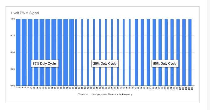

                                            A linear controller, such as a rheostat, changes the voltage in a way a multimeter can read.  The meter, and operator, doesn’t have to cope with complications like RMS (sine waves), or PWM (Pulse Width Modulation).
                                            Apart from being easy to understand and measure, linear controllers have few advantages.   The motor develops power proportional to the amps it gets, and the amps are proportional to the volts, which are constrained by the controller.   Unfortunately, dropping the voltage very wastefully converts electricity into unwanted heat, and dropping the voltage slugs the motor, reducing torque.  Not good.
                                            Pulse Width Modulation is much better:
                                            • Speed is controlled by altering the time amps are available to the motor rather than throttling the amplitude of the current by altering the voltage. Instead,  DC is chopped electronically into ‘n’ slices per second, so the motor gets the average.  The duty cycle is anything between 0% (OFF) and 100% (Flat Out).
                                            • As each slice is either fully ON, or fully OFF, the controller wastes very little energy.
                                            • The performance of the motor is improved considerably at low speeds because all the amps from the power supply are available to the motor for the duration of each pulse.  More torque.
                                            This graph shows an example PWM waveform.
                                            Screenshot From 2026-01-28 07-28-42
                                            Not many multimeters can measure RMS, and few have the electronics needed to measure frequency and duty cycle, essential to make sense of PWM.   A Fluke 77 is the wrong tool.  An oscilloscope is needed; it displays the waveform allowing the peak voltage, pulse width and duty cycle to be measured.
