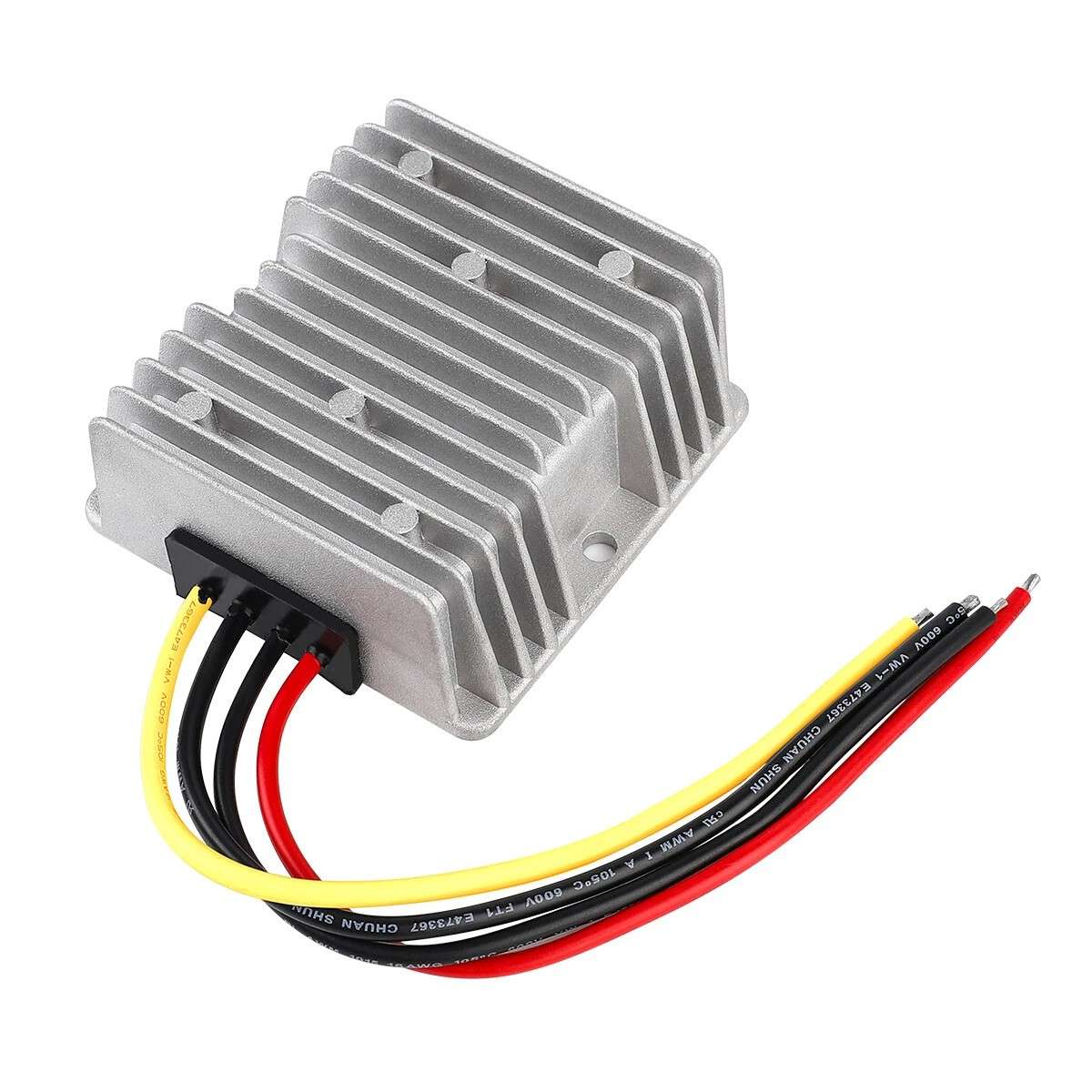

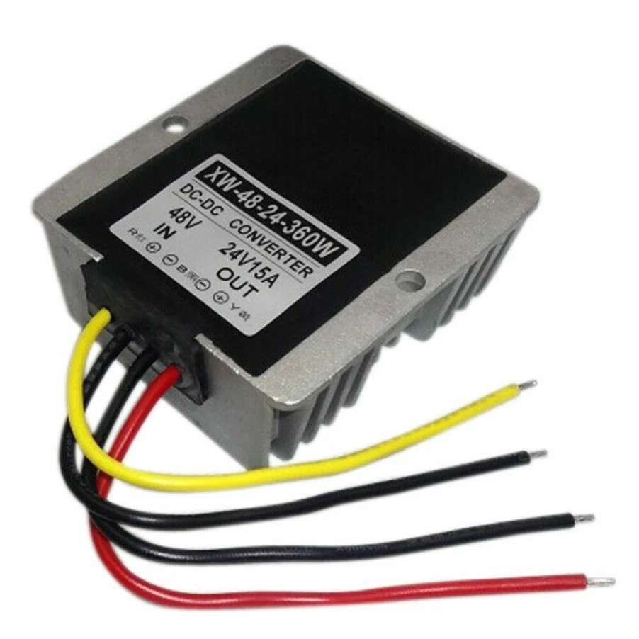

      Is anyone using a step down converter like the attached type? And are they considered reliable and long lasting?s-l1600s-l1600

      Robert Atkinson 2
        @robertatkinson2
        Not used one of those, I generally do my own. Difficult to comment on a no-name generic unit.
        What is your application?
        Robert.

          I have a 48V dc power supply and a 24V brushed DC motor. I’ve read that that combination can make the motor run hot and possibly lead other problems.

              If the DC-DC converter is producing smooth 24 volts DC, then the motor will not get any hotter than it will get when working from any other smooth 24 volts DC supply.
              The DC-DC converter may get rather hot. The fins on its case indicate that it probably needs air to be able to freely circulate around it.
              You should consider whether the motor’s inrush current may damage the DC-DC converter.
                    Connected directly it would burn out the motor.
                    One cure is to drop the voltage from 48V to 24V with a rheostat or hefty resistor.   Both get very hot.
                    • A rheostat is a wire-wound adjustable resistor, large and expensive.  Can be adjusted for best results, but, unless you have one already, don’t bother!  Old-fashioned, hard to find, and pricey,
                    • A fixed resistor, or resistor bank, can be substituted for a rheostat, but the size of the resistor has to be calculated as described by John, not everyone’s cup of tea!   Cost depends on the size of the motor – how many amps does it consume? Likely to be pricey, and will need a DIY box and wiring up.   Not recommended.
                    Much better to drop the voltage with a Buck Converter of the type asked about.   The technology is well established and efficient.  They produce much less heat.   The unit shown is an IP sealed automotive type where the box is also the heatsink.  Cheap because they are used in huge numbers in everything from tread-mills to lorries.  The unit is almost plug-and-play, just wire it in as per instructions.  Necessary to match it to the motor:  how many amps (or watts)?   Important not to plug a 10A converter into a 20A motor!   But, OK to run a 10A motor on a 20A converter, which will run cooler because it has a bigger heatsink.  Heat is the enemy of electronics.
                    Never had a buck converter go wrong, but I’ve not used one of the type in this question.  Impossible to say anything meaningful about reliability because it’s a generic type, and no doubt some are “too cheap”. But they get reasonable reviews and the internet isn’t full of failure reports.  Cheap enough to be considered consumable and easily replaced, so stop worrying!
                    May I ask a fundamental question?  Why drive a 24V motor from a 48V power supply?  It’s poor engineering, a electrical mismatch that creates an avoidable problem!   Fixing it with a buck converter adds complexity and is more to go wrong.
                    Why not replace the 48V PSU with an inexpensive 24V PSU?  They are in the same price range.
