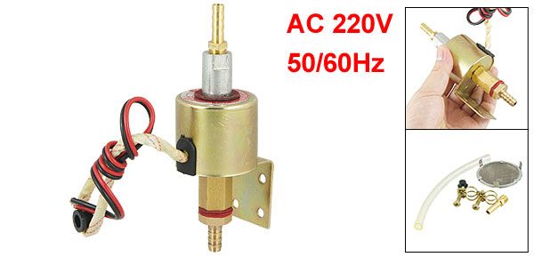

        Just taken delivery of an inexpensive coolant pump complete with strainer and fittings which was advertised on e-bay for $24.56 inc postage to Australia from Hong Kong. Took about 10 days for delivery. But the pump failed to work (open circuit on the power cable). A return message to the company was answered straight away and a replacement sent which works well. Excellent waranty service!
        Initial tests with water: Pumps about 1ltre/minute at 1m head height. Also sucks water with 900mm hose connected to inlet.

          Is it a non rotary type of pump? If it is a shuttle type of magnetic pump, let us know how you get on with minute swarf particles. It might be an idea to put some form of a magnet between the filter and pump to collect magnetic particles. What sort of delivery rate do you get at say 1 meter head. Will it 'self prime' and at what height. Seems like an interesting low cost pump. Keep us up to date please.

              I am sceptcal about the statement "Ideal for transferring abrasive chemicals and corrosive liquids e.g acids, adhesives, coolants, liquid metal." It looks likes parts are made of brass which is not very corrosion resistant. The only metal I know that is liquid at room temperature is mercury and I think that would dissolve the brass parts. (I can't imagine anyone wanting to pump mercury anyway.) The fact that I do not believe its corrosion resitance makes me not trust the claim to be abrasive resistant.

                  Not sure if it is a rotary type of pump or not. Suspect it is not as it produces a vibratory sound. From my first test, it will self prime vertically with a 900mm suction hose and deliver approx. 1 litre/min.
                  I plan to incorporafe a magretic filter and a strainer to collect swarf in the coolant. Would also prefer a low voltage pump but will ensure that wiring is protected. Also have earth leakage protection on the power circuit in case of electrical failure.

                    OK your pumps are probably specifically designed units. Would you take a chance on a unit ( specified as 220v not 240v) from an unknown ebay seller in Hong Kong? I must say too that the construction, from the picture, does not give me confidence. I hope for Paul's sake that it's OK but 220/240 volts, unknown quality /safety standards, liquids and metalwork don't fit well together for me.
