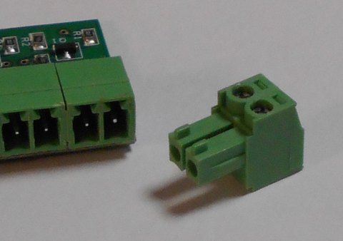

                  #460561
                  Frances IoM
                    @francesiom58905
                    I have the following connector system on some small audio interfaces which would work well the male plugs (8mm wide) have small screw fixtures for the wires – however I don't know the manufacturer
                    #460630
                    Kiwi Bloke
                      @kiwibloke62605
                      It's not clear just how easily adaptable or 'professional', or well-shielded you'd like the system to be. A red and black (if it's a d.c. system) 'ring main' could be run around the area and broken into using el-cheapo 'chocolate-block' screw terminal connectors for spurs to lamps or other devices. If it's got to be a pluggable system, 4mm banana plugs? (I guess I'm a bit tight, but I like cheap-but-effective solutions.)
                      #460634
                      Dave Daniels
                        @davedaniels93256
                        Posted by Frances IoM on 28/03/2020 20:28:25:
                        Colour looks a bit like Camdenboss.
                        The O.P. might look here to see if there is anything suitable.
                        ttps://cpc.farnell.com/w/c/cable-leads-connectors/connectors/pcb-connectors/pcb-terminal-blocks/pluggable-terminal-block-headers-sockets/prl/results?brand=camdenboss&pageSize=100
                        D.
