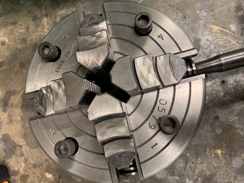

        Did a little messing around in the shop tonight, learning about how the ML10 lathe works, as I am a complete newb with this. Learning a ton quite quickly though!
        I went through the misc parts which came with the unit. Unfortunately, it seems as though the 4 jaw chuck, which was included with the lathe, is missing its backing plate. Is the chuck still usable (ie, would I be able to source a backing plate for it)?

          Yes, they are available. ML10 has a standard spindle thread – I think, but you better check that!
          OR you could make your own – if you have a faceplate. Lots of experience in plain turning and internal thread cutting. Setting up a pitch circle diameter and drilling and tapping the mounting holes.

            They aren’t specifically machined per the chuck, when they are made? Meaning I could get a replacement somewhere?

              They come as a blank of various diameters to suit different chucks, ready machined and thread to fit on the lathes spindle. Then you machine it up to fit your chuck.

                Hi Jeremy, maybe you can enquire at Myford Cat.
