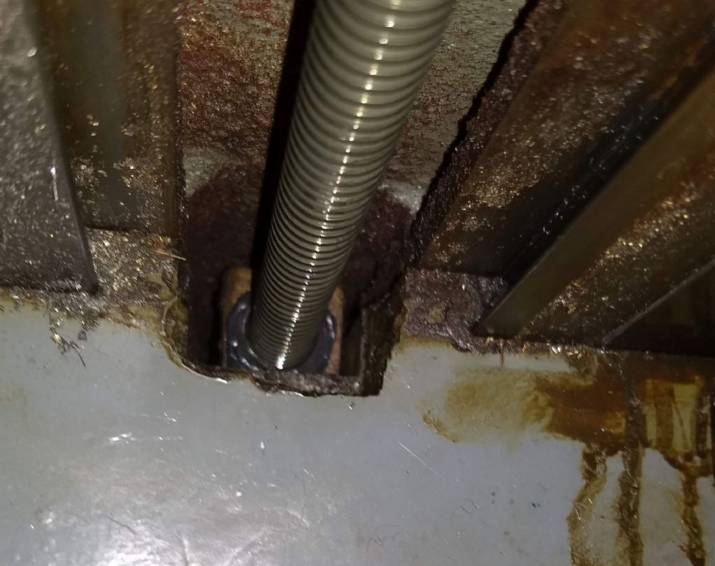

          #531275
          Dave Halford
            @davehalford22513
            Its in full view under the table on the righthand side and only held on by the big nut.
            #531316
            not done it yet
              @notdoneityet
              My y axis nut is dead central and hidden from view.

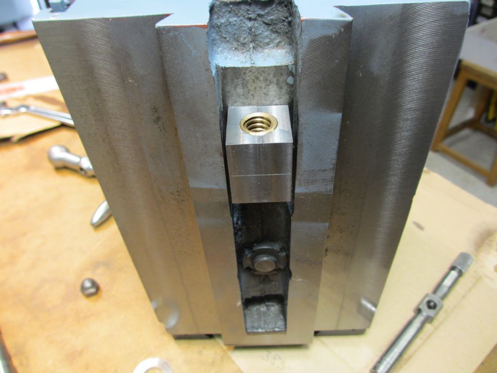

                #531346
                Gary Wooding
                  @garywooding25363
                  I've never taken it out, but here's a photo of my Y-axis leadscrew nut. The clearance round the nut seems promising.
                  #531414
                  jason evans
                    @jasonevans10206
                    cheers. there does seem a bit of room in there. is the brass nut just a push fit in the hole it locates in. cant imagine it is rigid.
                    #531418
                    Gary Wooding
                      @garywooding25363
                      Posted by jason evans on 03/03/2021 12:50:17:
                      I really don't know.

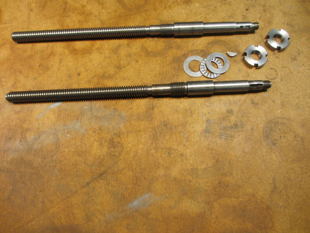

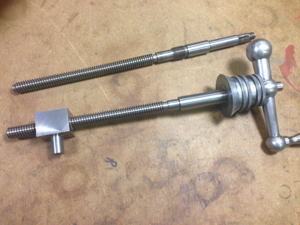

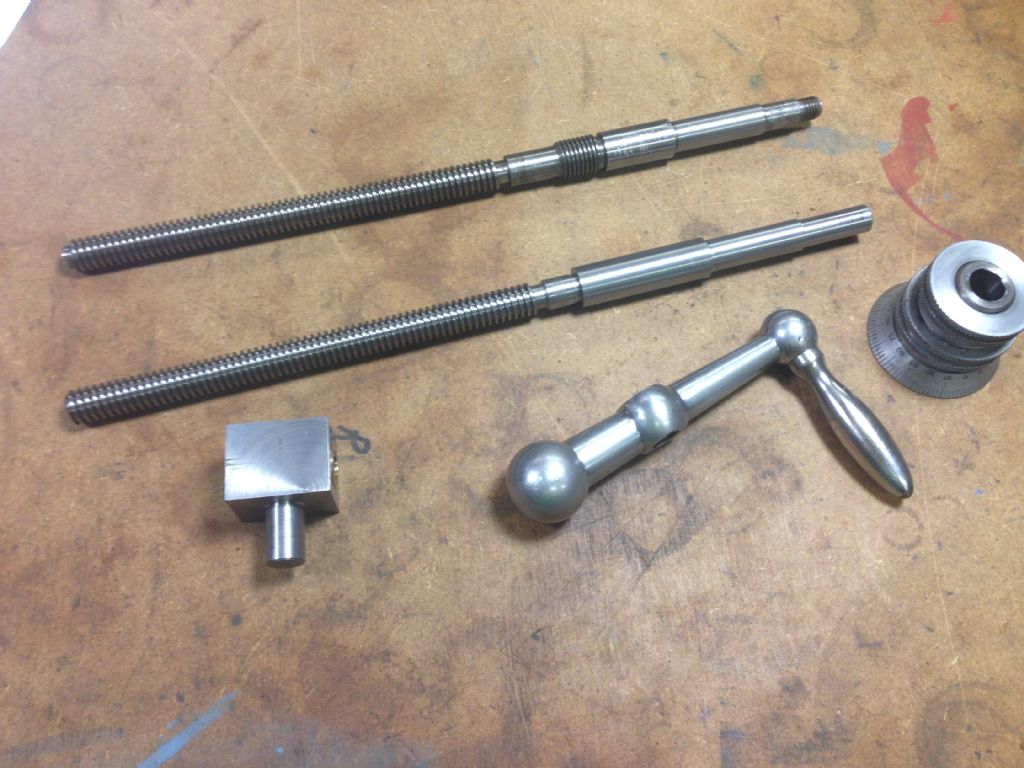

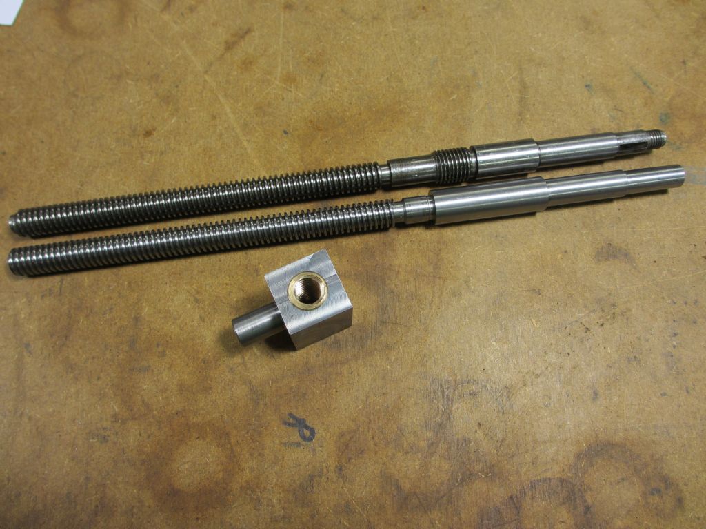

                      #531460
                      T.B
                        @t-b-2
                        I ended up making a new screw and nut for the Y axis when I refurbished my Centec 2B.
                        I was too tight to make the whole nut from bronze so pressed a piece into a steel body.
                        From memory the original nut was a light press fit in the knee casting
                        Edited By T.B on 03/03/2021 15:51:10
                        Edited By T.B on 03/03/2021 15:53:08
                        Edited By T.B on 03/03/2021 17:17:30
                        #531477
                        jason evans
                          @jasonevans10206
                          Excellent thanks for the pics. Just what I needed 👍🏻
