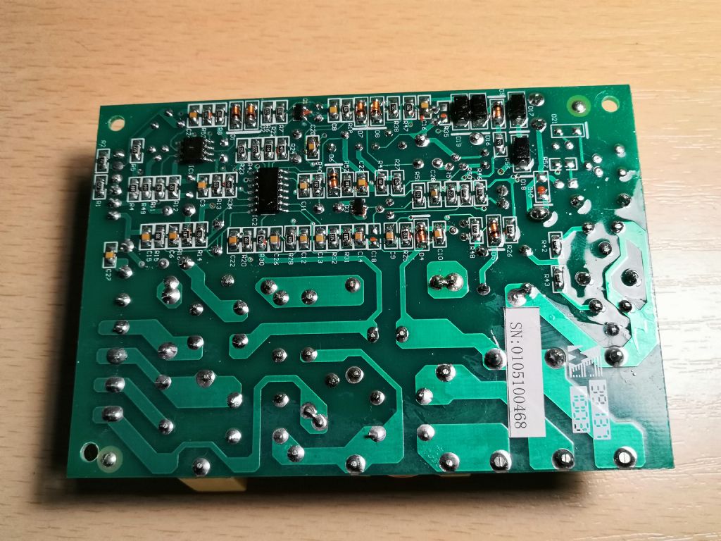

      Hi guys. I need some help. Again 🙄
      My little C0 lathe keeps blowing fuses. Ive had it apart and tested all the usual suspects with the multimeter. Potentiometer, stop switch, microswitch etc and they all seem fine.
      I deduced it has to be the control board so I removed it and wired it up without the motor to test. The board is blowing the fuse in the plug.
      I've inspected the board and it visually looks fine. No burnt out components or anything . I'm thinking there must be a short somewhere? At this point I've kinda run out of expertise and talent. What should I be looking for? What should I test. Is there any common things to check?
      Any help, as always is appreciated.

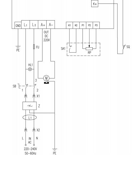

              Unfortunately the manual does not seem to list the mains cable on either the exploded diagram or the parts list but this image suggests the suppression components in the mains lead might repay investigation. The mains lead appears to plug into them and they plug via the switch, lamp and fuse into the control board while the earth wire is directly connected to the motor. Interestingly the fuse appears to be in the neutral line??

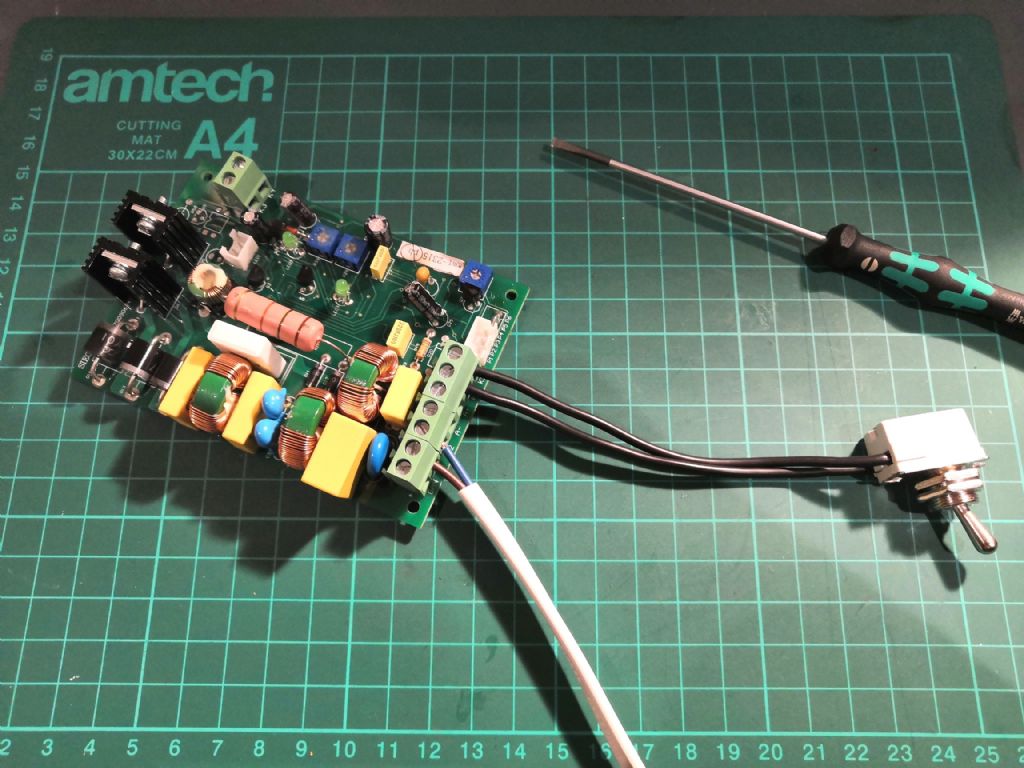

                Guys, I wired the control board up as below with a different power cord and switch and also using the potentiometer from the lathe (not in picture) to try to eliminate any possibility it could be anything other than the control board. The 3a fuse in the plug tripped immediately.

                  No direct experience of this lathe, but my recommendation would be to check high powered active components first. I.e. diodes and transistors. Not sure if replacement components are easily available though. Not cheap but the complete PCB is available from Arc Euro. Probably the simplest option.

                    I can see bad joints on both side of board ,one on the diode near orange capacitor and one on the other side near serial number.I would think the diodes are shorted and blowing the fuse.
                    I do not mean to be rude ,but if you’re not fully competent with working at mains voltage ,take it to somebody who is.
                    You have to consider the whole board to be at mains potential.
                    Maurice

                      Maurice – Not sure what you mean by bad joints? They all look fine to my untrained eye?

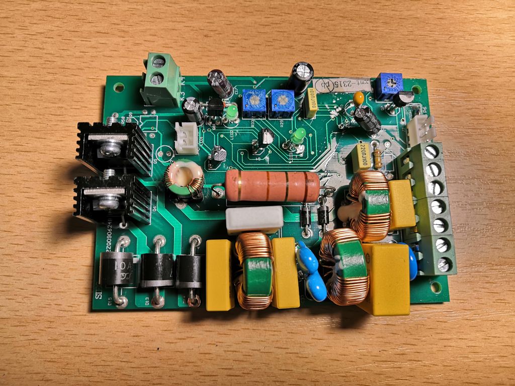

                      I've just been checking a few components with the multimeter. One of the large diodes (bottom left of 1st picture) is giving continuity both ways. With the positive and negatives reversed. That can't be right? Probably need to remove it from the board and check again?

                        You need to disconnect one end of each diode from the board to test them properly as you could get a reading across another component on the board.

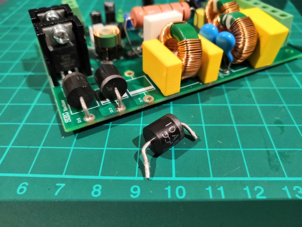

                            Well I unsoldered the diode I suspected was faulty and it is indeed shorted.
                            Now just need to find the correct replacements. The diode reads 10A6 where is the best place to buy these?

                              The diode is 1000v piv rated at 6Amps….try Ebay….

                                I would check the other two diodes as well … in fact I would replace all three!

                                  I stand to be corrected, but I think you will find that the 10A6 rectifying diode is rated at 10 Amps and 600 volts.

                                            This board uses 2 scr's and 2 diodes in a fw bridge configuration….
                                            #505037
                                            Les Jones 1
                                              @lesjones1
                                              I suggest that you also check the two TO220 devices which I suspect are SCRs. I think they form a controlled bridge with two of the three diodes. The output of this bridge will feed the motor. The third diode probably powers the control circuit that controls the phase of the trigger pulses to the SCR gates. The small toroidal transformer near the heatsinks will provide isolation between the control circuit and the SCR gates. If one of the SCRs is short circuit and it is not replaced one or both of the diodes that are part of the bridge will be destroyed again when power is re applied.
                                              Les.

                                                  The most likely failure mode for SCRs is anode to cathode short circuit. Looking at at the devices the way they are mounted on the heat sink and with the pins facing down the centre pin is normally the anode and the left hand pin is the cathode. This is the layout for most SCRs in TO200 packages. It would be a good idea to confirm this by looking for the datasheet for the devices used on your board. you can normally find the datasheet using Google or other search engines. Just do a resistance test between anode and cathode with both polarities. Both readings should show over range on your meter. (Or at least a very high resistance.) If they are short circuit you will get a reading of almost zero ohms in both directions.

                                                    Tested the SCR things and they where fine. The diodes arrived today and I fitted them this afternoon. Everything is now working again. So I am a very happy bunny, and I saved a hundred quid! 😁😁👍
