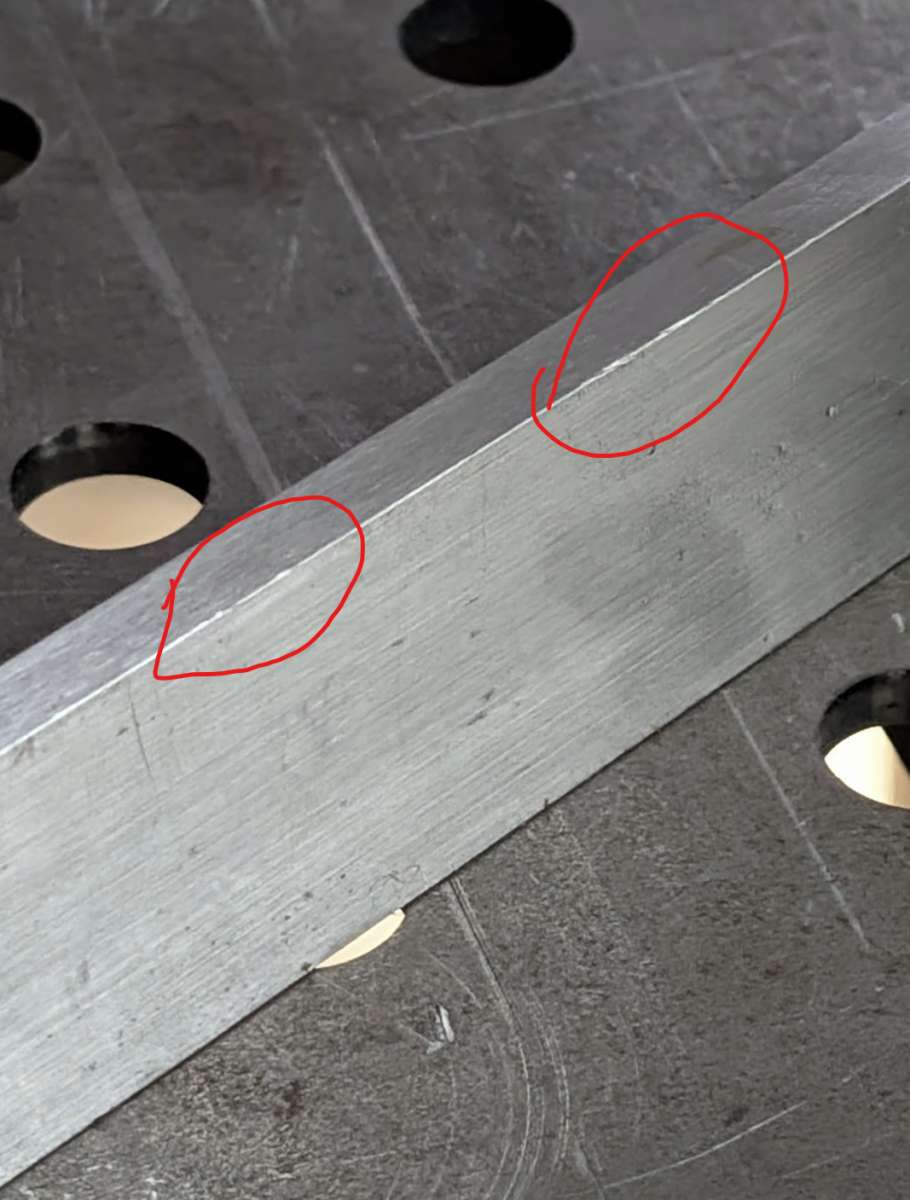

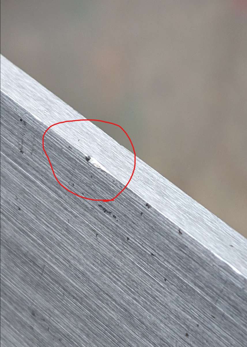

      I picked up a 1943 Moore & Wright straight edge last week. It was still in the wax paper and covered in oil. Upon cleaning it, I can feel a few small surface imperfections along its edge. I’ve tried to show them in the images below. I’m guessing this will affect its ability to measure a straight edge, and I was wondering what the best method is to remove these?
      Screenshot 2025-12-01 091019 Screenshot 2025-12-01 091050

        600 wet or dry paper on a piece of flat material (metal) Do no more than is necessary, test it against a piece of glass. Noel.

          Thanks Noel, this is 2ft in length so not sure i have anything that long and flat as a reference surface. i was hoping not to ruin the lovely ground surfaces, but i think this is probably the best approach.

            On thisdesignedthat Said:
            I was hoping not to ruin the lovely ground surfaces
            Do some tests on a piece of steel scrap with different grits of abrasive paper. Pick the grit that most closely approximates the existing scratches on the piece.

              I find that an Ezelap or equivalent diamond lap (600 or 1200 grit) is the best way to stone off burrs. You can stop precisely when you reach the undamaged flat surface.

                  +1 for EzeLap.  It is remarkably difficult to stone significant amounts off a ground surface.

                      Umm, the pictures aren’t clear, but looks to me as if the dings are on one side, possibly the inner side of a bevel where they don’t matter.  If so, “if it ain’t bust don’t fix it“.
                      Stoning a straight-edge is a good way of ruining it. So practice on something you don’t care about first!

                        This isn’t a beveled straight edge, just a rectangular straight edge so those edges are in contact with the surface i want to measure
                        Yep, i agree, it was a bit of an impulse buy but i’ve learned my lesson with this one, even if it’s in wax paper and looks to be unused its not worth the risk with this type of measuring equipment. I paid £60 for it so not that much of an issue. But I see you can get something like the Kinex Precision Straight Edge 1000 mm (Made with an accuracy of 0.033 mm to 1 meter, according to DIN 874) for £100 off Amazon which i know i could return immediately if theres any issues

                          If you carefully rub the dings with a diamond hone they will quickly get flush with the neighbouring surface. And you might remove a few microns of material but for the kind of things you use a straight edge for that’s quite immaterial.  Certainly wouldn’t easily remove 33 microns which is the accuracy on the one you quote.  If you’re concerned, measure adjacent to the ding with a micrometer before and after – I bet you’d not notice any difference.  I have tried lapping off significant amounts and it’s really hard!

                            Yes, what John Haine is saying – I think – you only have to address the bits where bruising has raised metal – these only have to be taken slightly below the ‘good’ surfaces, as ‘locally as possible – leave the rest of it alone.

                              Not a lot further to say, but in a case like this I find a small drop of thin oil will make the lap float over the flat surface, but the sharp projections will penetrate the oil film and be abraded. Of course there is a degree of technique about it, but you quickly get the measure of it. I find the lap configuration below best for exact control.
                              As to whether to use oil or water, oil can sometimes soften the adhesive attaching the diamond coated metal foil, whereas I have found the use of water as lube can result in rust unless dried very carefully afterwards. Neither horse suited to the course?

                                It’s suboptimal being content with just taking away any protrusion from the dings, but preferable to regrinding/stoning the whole reference surface and ending up with a worse outcome, which I know I would with the equipment I have at my disposal if the straight edge had any pretensions to accuracy in the first place.
                                A slight amount of unevenness on one side in a couple of neighbouring spots won’t matter for most purposes as long as the vast majority of the reference edge itself is still flat and uninterfered with. The presence of the smoothed off dings may require you to use feeler gauges more often in some circumstances to corroborate what you think your eyes are seeing.

                                              From the pictures the burrs are so small that removing them will do no harm. I use mine for checking cylinder heads Etc, we’re not really talking microns here. whilst having an optical flat may be nice is it needed ? Noel.
