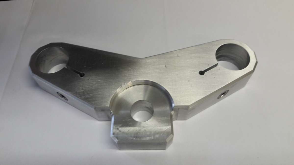

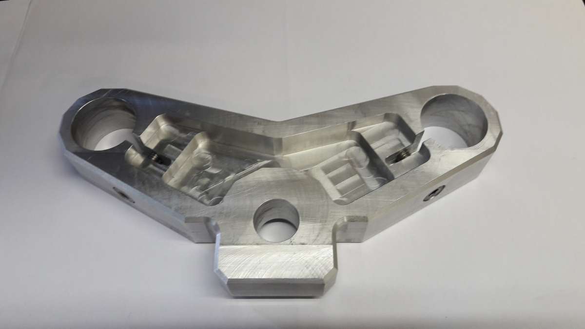

                            I made yokes for my Triton a few years ago, for the clamp on the bottom yoke rather than a slitting saw I used a 5mm long series slot drill.
                            Food for thought perhaps?
                            All done on manual machines.
                            20171126_104647
                            20171126_104630

                                  andy198712
                                    @andy198712
                                    Very nice work Phil!
                                    yes very interesting…. I have seen that method of clamping a lot on classics which is what mine is going on… but it felt a bit wrong?
                                    What I mean is it’s not on modern bikes but was all the rage?!
                                    pros are that it’s very clean and looks good.
                                    does it clamp aswell? What clearance did you give your bores?
                                    my forks are 43mm so I’ve bored my holes to 43mm
                                    and my stem 25mm
                                    cheers!

                                            Phil Lingham
                                              @phillingham79132
                                              and my stem 25mm
                                              cheers!
                                              Andy
                                              The clamping is absolutely fine, but that’s why I relieved the thickness under the clamping screws to allow a little more flex.
                                              I can’t remember exactly what clearance I gave but I actually done the boring in the lathe as I didn’t posses a boring head at that time. I used a fork tube as a gauge and bored to the minimum clearance to allow a sliding fit so they could be assembled.
                                              My stem is 13/16″ to match the original Norton Roadholder top nut, 7/8″ into the bottom yoke.  The top yoke is bored 25.4 again to match the original top nut.
                                              Not shown in the photo but there is a 3mm wide slot to clamp the stem into the bottom yoke with a 3mm deep undercut in the stem so that the clamp screw also acts as a cotter.  The slot was made with a slitting saw – to answer the original question mine are all 1″ bore and 4″ diameter.
                                              Out of interest what are yours going on?
                                              Phil

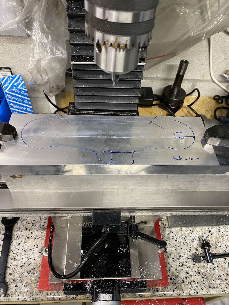

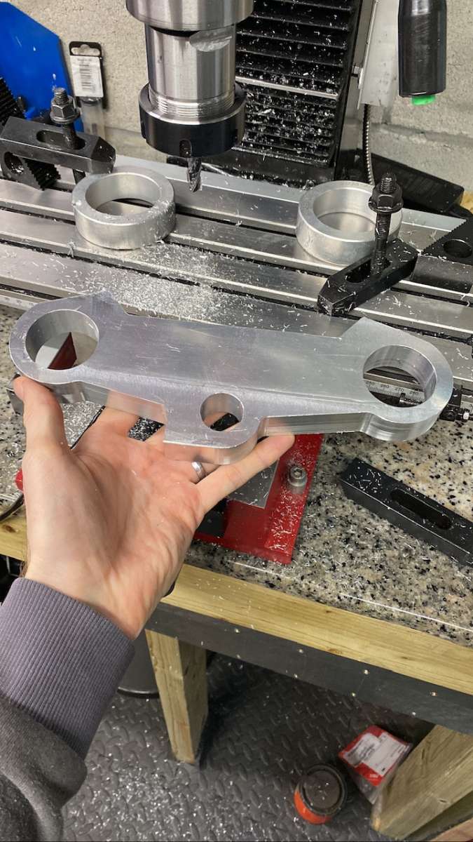

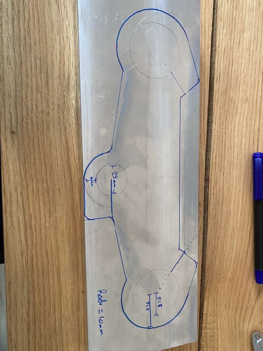

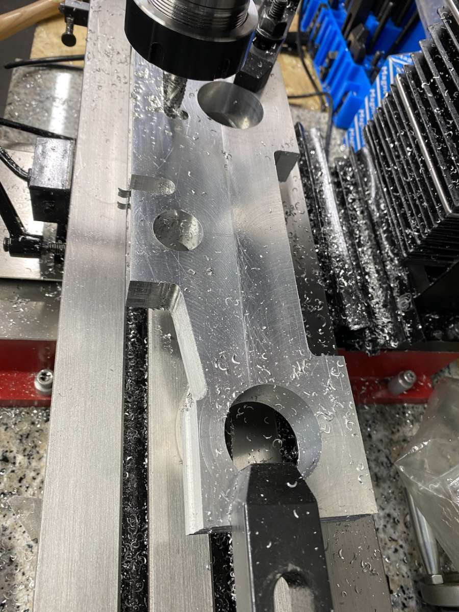

                                                  andy198712
                                                    @andy198712
                                                    On Phil Lingham Said:
                                                    and my stem 25mm
                                                    cheers!
                                                    Andy
                                                    Phil
                                                    Cheers Phil, nicely done!
                                                    so my top yoke is 25mm and my bottom is going to be 50mm
                                                    not started the bottom yet, but I clamped them together and drilled the 3 pilot holes so those will be aligned to each other. That 50mm part will take some milling!
                                                    been using a rougher/ripper 10mm endmill and it’s been going through it like butter with full width, 5mm DOC. That impressed me!
                                                    so this going on my BSA Bantam… I know I know….
                                                    its to fit 2000 Yamaha R6 forks, a Honda CB550/750 hub and twin disc brakes off the R6….. as you do
