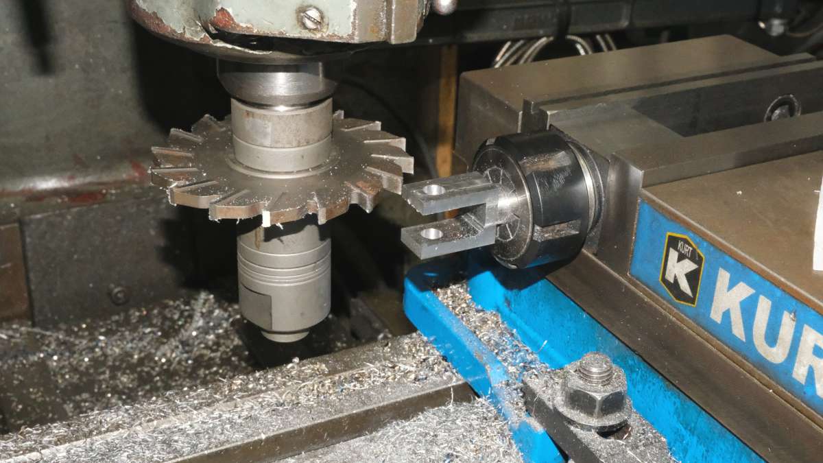

                        Metric slitting saws equals metric arbor, imperial slitting saws equals imperial arbor. Most of my slitting saws are imperial so I use 1″ and 1-1/4″ arbors on the horizontal mill. For deep cuts with slitting saws I prefer to use the horizontal mill as I’ve found slitting saws on the vertical mill go walkies with deeper cuts. Slitting saws on the vertical mill are limited to shallow cuts, such as slotting screw heads.
                        For the vertical mill I have a 1″ diameter R8 slitting saw arbor. I’ve never felt the need for other sizes. While slitting saws on the vertical mill are mostly limited to shallow cuts, with care larger cutters can be used:
                        Slot Finishing
                        The slot was roughed out using an endmill and the side and face cutter only used to bring the slot to final width and create the sharp internal corners.
                        Julie

                                          The picture of Julie Ann’s vertical mill has a cutter in the arbor that I would not regard as a slitting saw at all, but more associated with horizontal mills, and would have to have a key.
