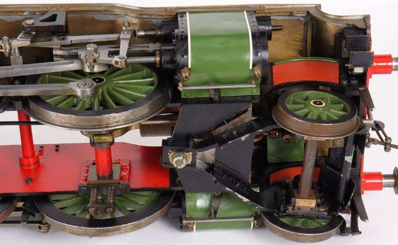

                  Not being a Loco man I had to go and find some images of a Bantum Cock.
                  https://www.stationroadsteam.com/3-12-inch-gauge-bantam-cock-2-6-0–stock-code-11684/
                  I can’t see anything there that could not be bent with a basic bench vice and adjustable spanner.
                  The frames look flat. The bogies are not particularly wide and do not have tight 90deg bends so nothing special needed unless I’m missing something? If there is can yu post a pic of the drawing.

                    #849950
                      bogie

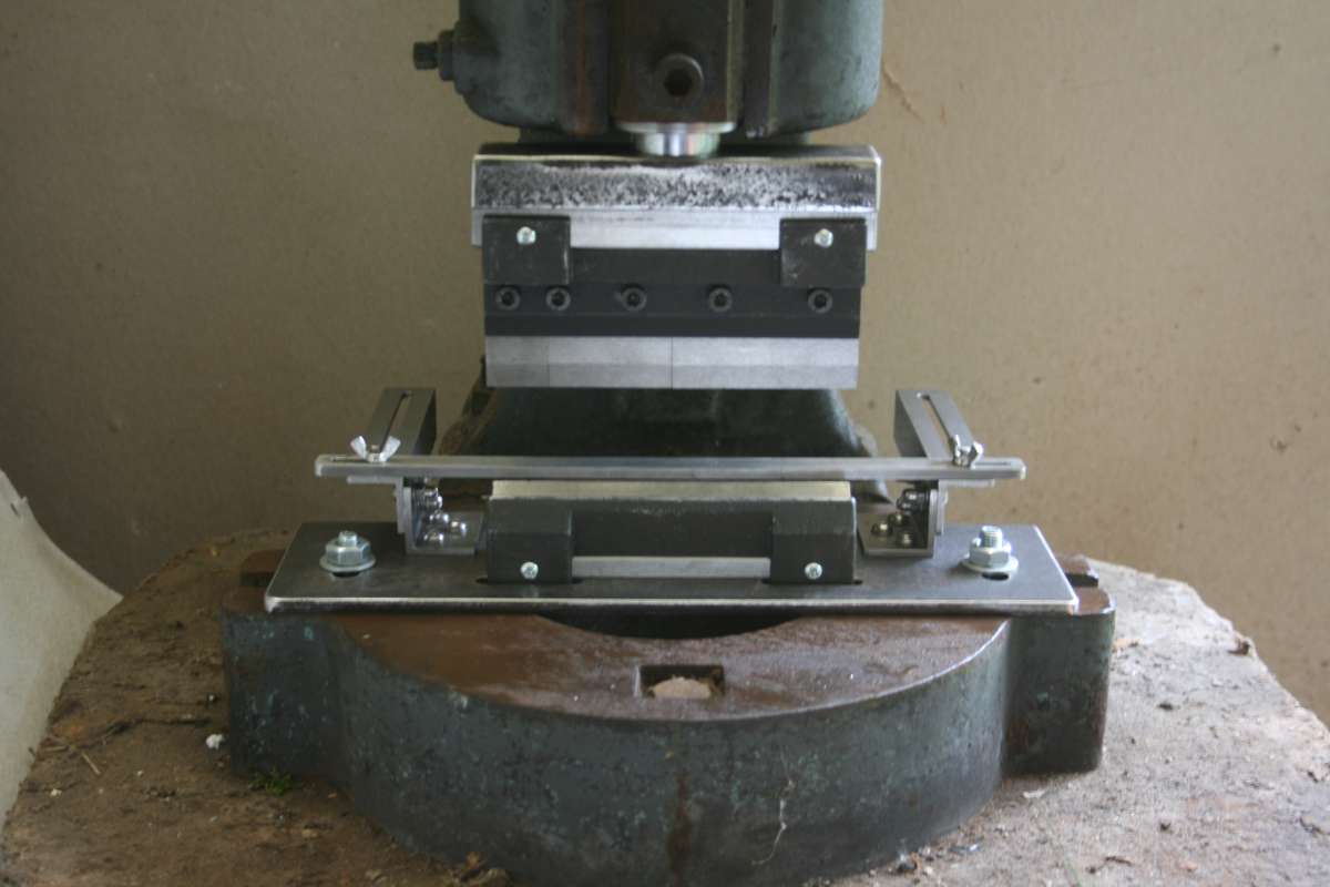

                      Nicholas Farr
                        @nicholasfarr14254
                        There are plans for a home made bender similar to a Miracle bender, that was a free plan in issue 18 of MEW, which is in the tools section the Workshop tag in the blue bar above. Free Plan : A Metal Bender I used one of these in my last day job, and I guess a previous employee made it, and that worked fairly well, but not as good as a real Miricale bender.
                        Regards Nick.

                          Hi JasonB, Ah! Yes, thanks for the photo.
                          Regards Nick.

                              Looks like the heftiest piece of bending in this loco is the frame around the rear pony-axle as per drawings posted by Nicholas Farr above
                              I have successfully bent similar frame-pieces in 3mm steel using JasonB’s method posted immediately above this post.   It just needs patience, care, and an element of naked aggression sometimes combined with a relatively heavy hammer!   But then, I am a ‘punk engineer’.
                              I also have one of  those bending ‘brakes’ that fits in a vice’s jaws and that works too, but really needs a somewhat hefty vice for easy bending.
                              Note however, that this builder has avoided the bending completely by constructing a rivetted or bolted right-angled box by combining flats & angle.  So, more than one-way of skinning this particular cat.  If you are hesitant maybe worth considering this as a solution if only in the short(ish)-term which could be replaced later when you have more confidence?
                              Thanks to Station Road Steam archive for the pics.

                                #849972
                                Nicholas Farr
                                  @nicholasfarr14254
                                  Hi Phil, yes those that you can use in a vice are quite handy, but I’ve rarely used mine in a vice, but I have made provisions for using them in my Fly press.
                                  IMG_1127
                                  Regards Nick.

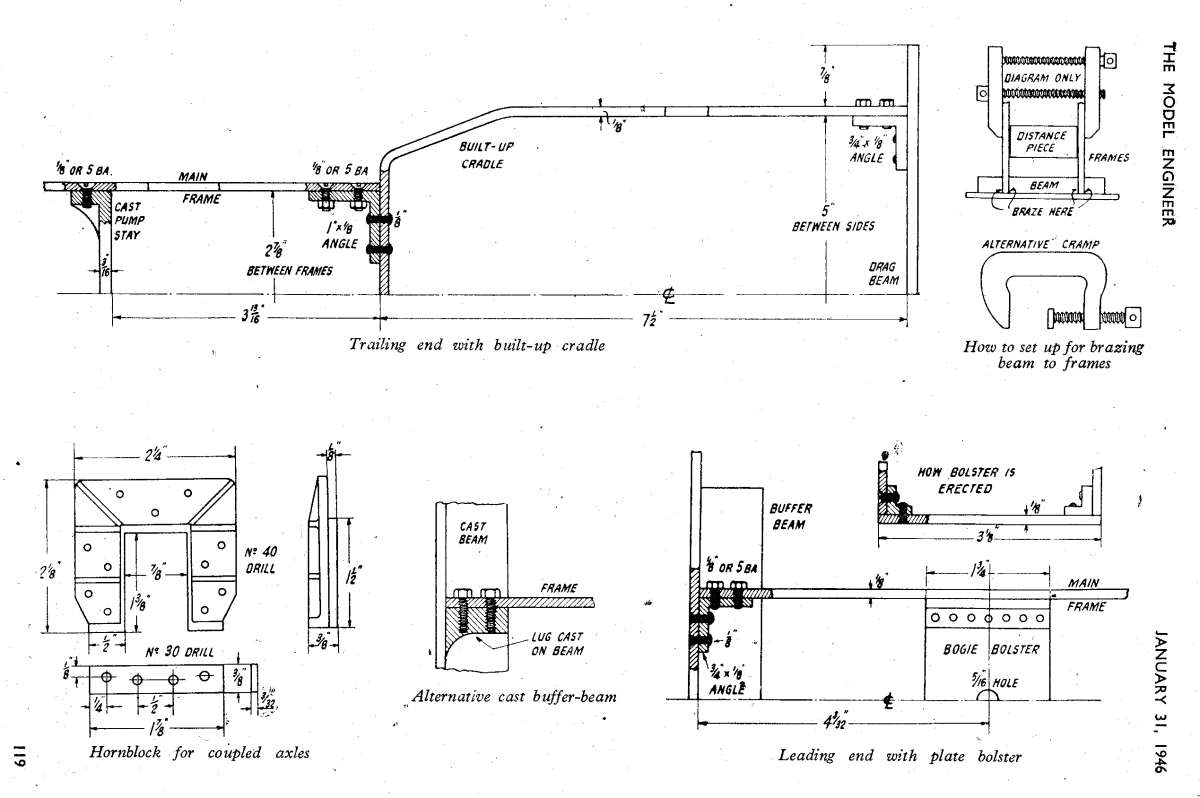

                                    I’ve had a chance to look at the drawing for this trailing frame now to see the elevation, which is a maximum of  2 7/16 inches (62mm) and  “a piece of metal is needed measuring 16 1/2 inches by 2 1/2 inches”
                                    I would suggest 3mm x 70mm CR4 as being modern equivalent, though imperial is still available in ER32B.  Unless you are going to get something sheared to size.
                                    CR4 is (relatively) ‘easy’ to bend and 3mm x 70mm well within the scope of amateur unsophisticated bending with the use of a few formers.  I wouldn’t over-think this exercise, LBSC disposes of it in a single sentence: “The piece is then very carefully bent to the shape shown in the plan of the frames; to make certain that it is true and square use a piece of 5/8 inch square bar in the frames.”
                                    (Explanatory note: the 5/8″ sq bar is placed in the axlebox cutouts to ensure that they are square to each-other across the resultant frame.)
                                    Maybe get a couple or so lengths say around 450mm long and ‘have a go’, starting from the middle and working outwards.  I would use some alloy or steel formers to assist in the bending.   The steel is (relatively) cheap and experimentation will soon show the way; don’t forget that LBSC was writing for constructors who had nothing like the sophisticated workshops considered ‘normal’ (or even ‘essential’) today.  JasonB’s post of 28th May at 06:56 above is pertinent!!

                                      #850000
                                        On Bazyle Said:
                                        Are you following the build instructions in ME? Typically they would give details of the necessary methods, but if not some other build series might help.
                                        This was LBSC, reprinted in ME in about 2012-13, (previously published in a different mag).
                                        The ‘trailing cradle’ was supposed to be a casting but:
                                        temp
                                        So in typically LBSC fashion “the piece is then very carefully bent to the shape shown on the plan”.
                                        His section on the pony truck doesn’t even mention bending it, only that a ‘casting may become available’ for the pony truck.
                                        Build series were a lot shorter back in those days!
