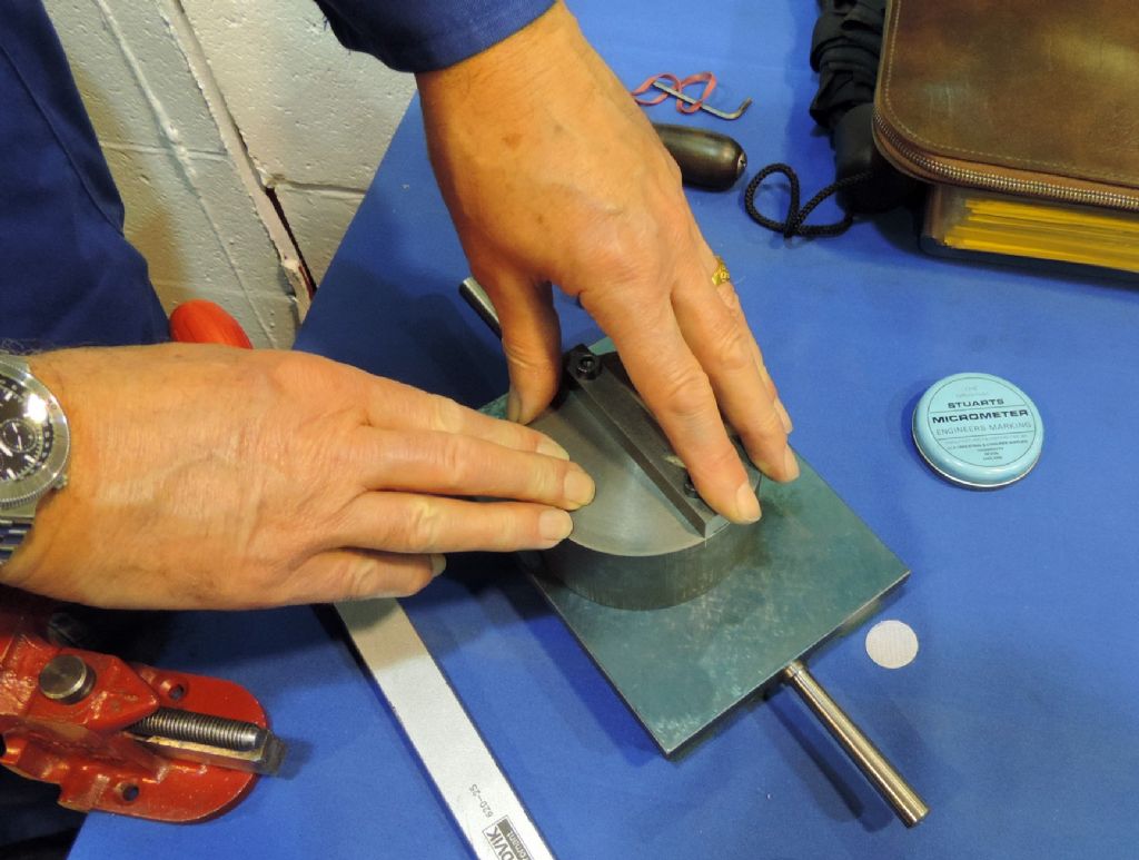

                                                      Posted by AlanW on 13/02/2016 12:01:51:
                                                      Any volunteers for a presentation at the engineering exhibitions? It would probably draw more interest than some subjects that have featured.
                                                      At the last Model Engineer Exhibition Neal Reid was demonstrating scraping (and letting punters have a go) on the SMEE stand.
