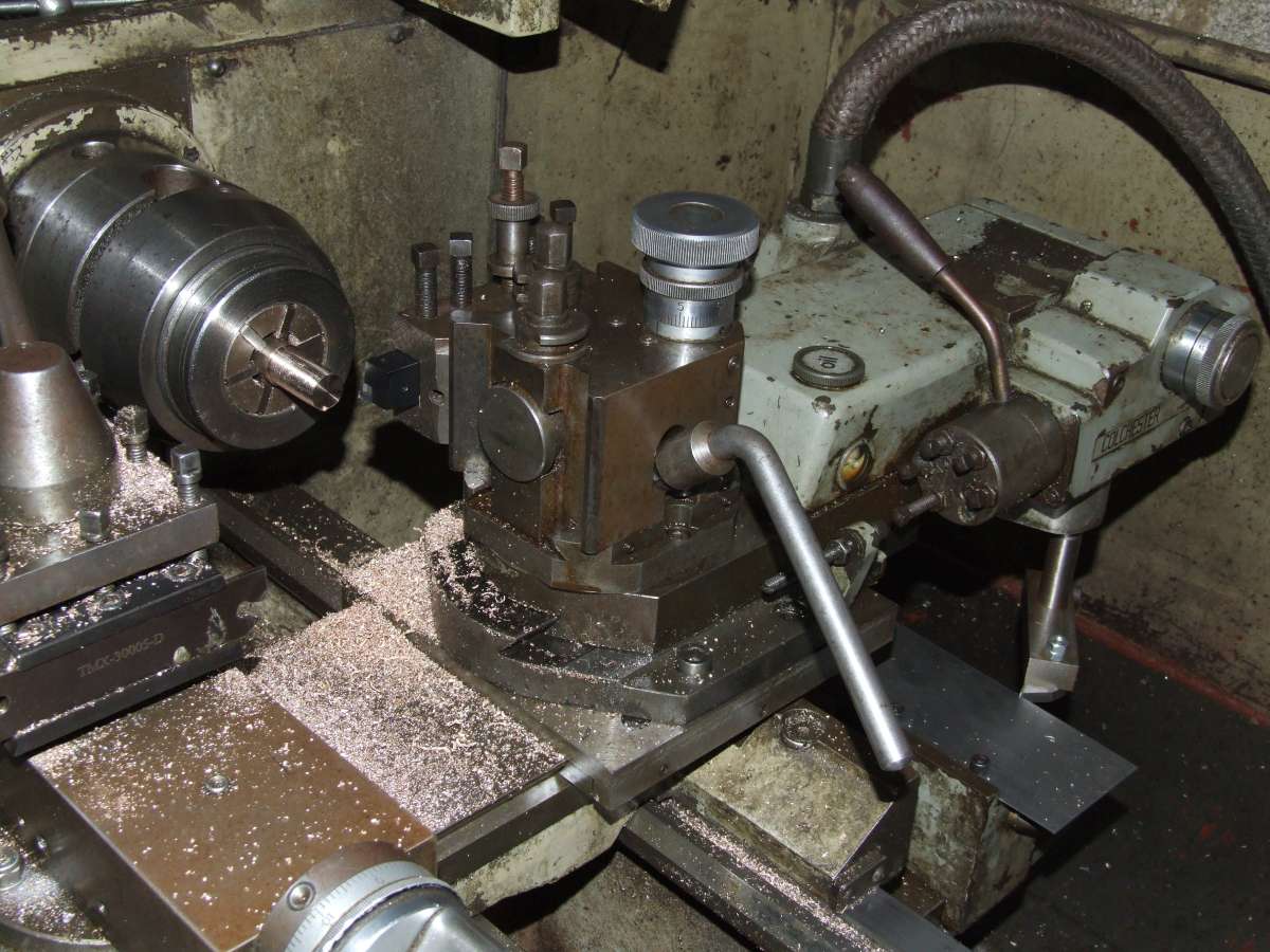

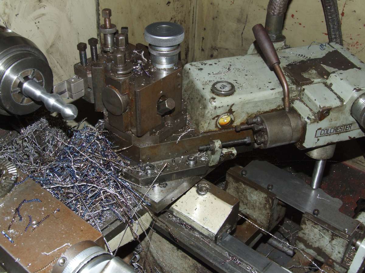

                  Picking up on one point, when using a hydraulic copy unit the stylus and tool shape must be identical or the workpiece will not exactly mirror the template or master part. The shape of the stylus will reflect the shape of the part. While a round stylus, and tool, are often used sharp internal corners would mean that a rhombic stylus/tool would be needed.
                  Hydraulic copy units are mostly set at an angle other than perpendicular to the work axis as otherwise a face perpendicular to the work axis would need an infinite feedrate from the copy unit. Due to the tool movement geometry a hydraulic copy unit cannot produce perpendicular leading and trailing faces on the same pass.
                  Here is a picture of a hydraulic copy unit at work cutting a valve coupling rod for my traction engines with a 3mm diameter tool and stylus:
                  2016_08130029

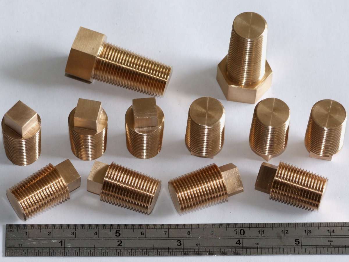

                  Screwcutting 3/8″ BSPT blowdown plugs, note the 55 degree stylus to match the tool profile:
                  2020_05010014
                  The finished blowdown plugs:
                  BSPT_Blowdown_Plugs

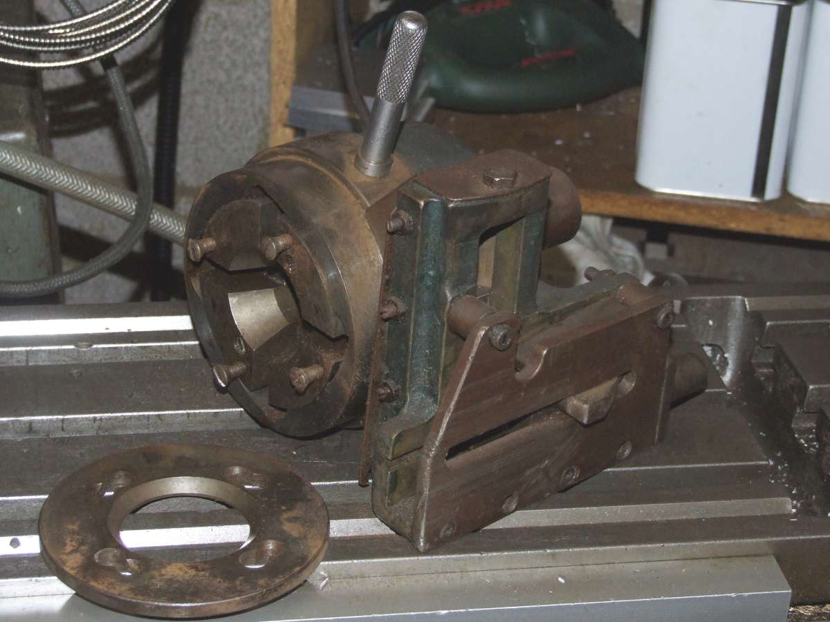

                              Of course commercially tapered threads wouldn’t be single pointed. So does anyone know what this is:
                              2017_05150015
                              For the record I do know what it is, but suspect I will never use it.
                              Julie

                                I see. No need to apologize for good habits, I just wondered if I had misunderstood something. Which I did at first, I got the image of a serrated guide plate for threads stuck in my head and I couldn’t figure out how that would work  🙂
                                I’m guessing the thingamajiggy is a self opening die head, we have something similar at work but I’ve never tried using it. It takes a fair amount of setup so it’s only needed for large series.
                                #828389

                                  Julie –
                                  I’d say a die-head but by which maker and for what machine I would not know. Perhaps Coventry: the basic outline suggests that?
                                  I don’t recognise the base assembly and can’t think what that protruding (link?) does, and I wonder if it’s actually a “special” add-on, not part of the original tool. Perhaps this die-head was used on something other than a large centre- or capstan- lathe?

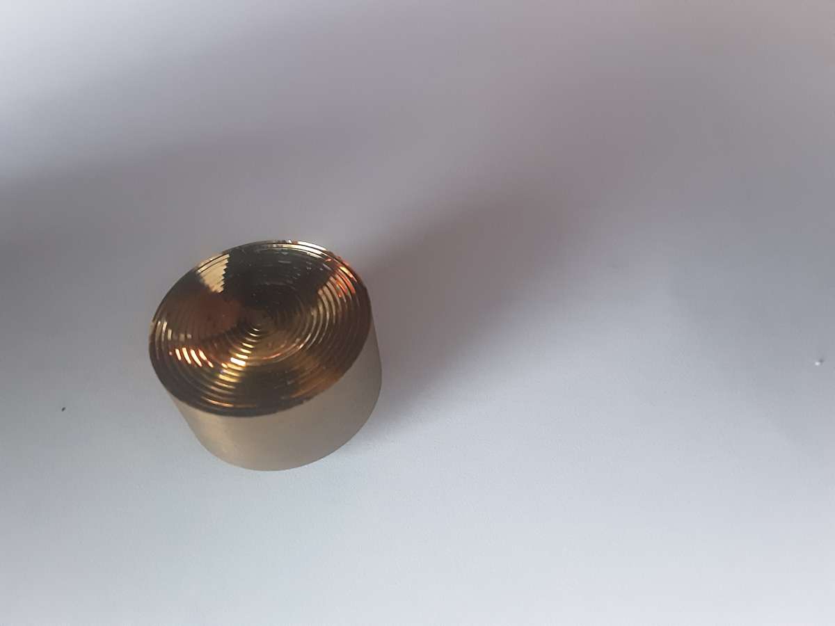

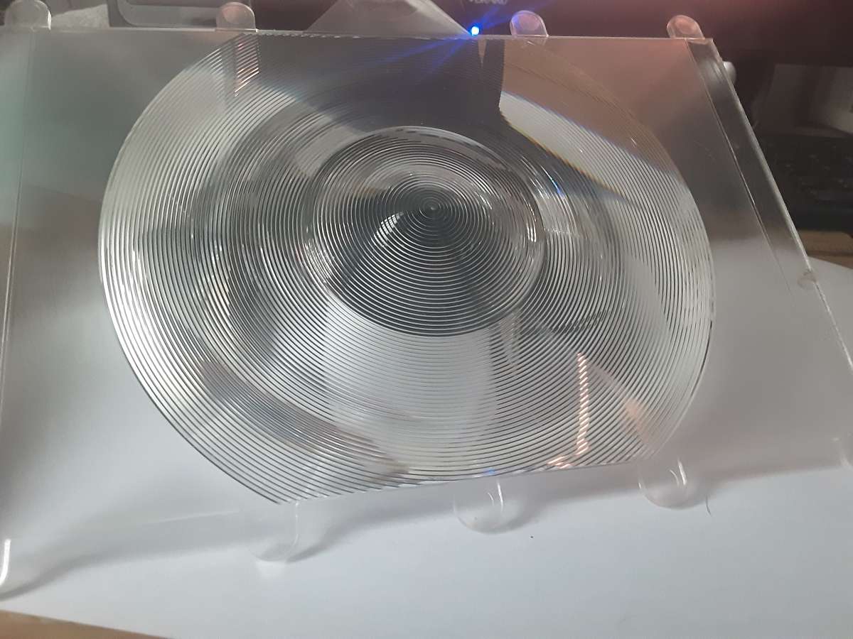

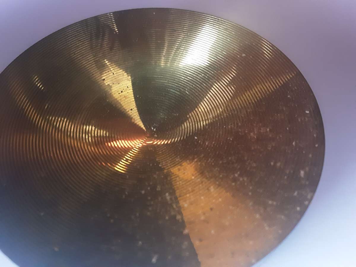

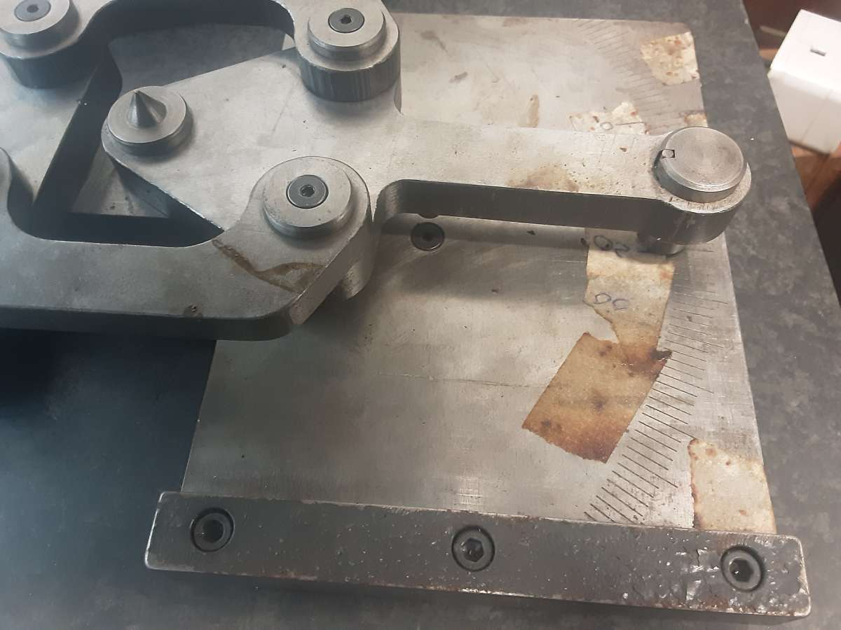

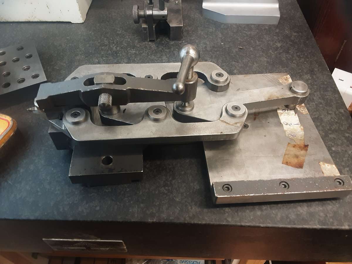

                                    I’m not sure this will be of interest.
                                    20251211_11474220251211_11525720251211_11553220251211_11555620251211_115644About 40 years ago I designed and made this attachment for machining prototype Fresnel mould tool inserts.
                                    The inspiration for the design came from a radius dressing attachment which came with a large cylindrical grinder newly purchased by the company.
                                    It works  by transferring the point of rotation into free air in front of the fixture, to cut the Fresnel prism angles the point of the tool is set on the centre of rotation,  this means the angle of the tool can be altered without its position moving in the Z or X axis, the attachment also  has a built-in sine bar at the rear for accuracy.
                                    The majority of the lens made were based on a 1mm radial pitch, the centre portion  being simple Dioptric prisms ( every prism having a different angle and simple refraction) and at a point where the efficiency had decrease to a level the prisms changed to Catadioptrics ( light enters one face on the prism is refracted and then gets reflected off the other face of the prism and  exits the face of the lens) , each prism having two different angles.
                                    All this to capture and control light from a bulb and turn it into a parallel beam.
                                    To prove the concept worked the original tools were made from H S S steel but then tools were manufactured from natural  diamonds ( not any use for jewelry as they were brown!)
                                    It really wasn’t possible to polish the machined surfaces because the accuracy would have been  lost. The diamond tools produced, combined with a air bearing and turbine driven spindle a surface finish that our Talysurf gave meaningless results.
                                    To turn the prototype lens into production tool inserts, the lenses were Nickel plated for days until the desired thickness and then built up with copper plate to thickness of about 15 mm, the lens was removed and the plated copy was machined to fit the tool.
                                    To cut a radius the tool would be positioned either forward of centre ,concave radius or rearward of centre to produce a convex radius.
