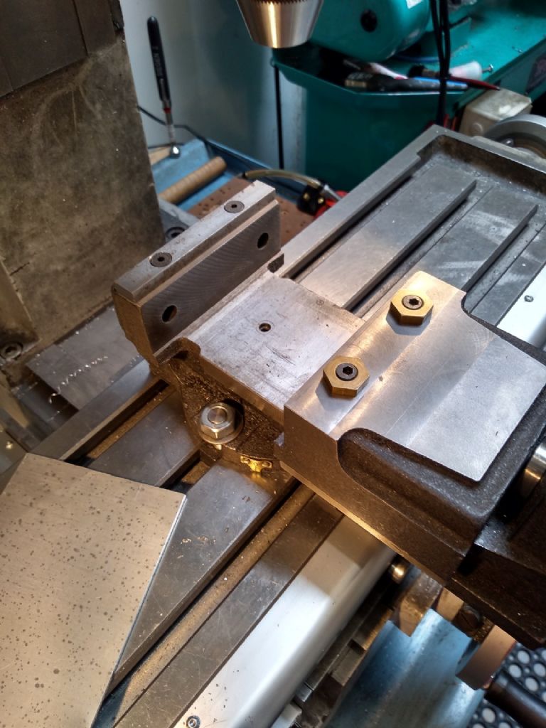

      For some time I've been wondering about a quick way to clamp thin material to mill the edges, or drill odd holes. Finally got round to making some simple mods to my standard machine vice.
      I unbolted the standard ground steel jaws, milled a tiny amount off both the top surfaces at the same setting so they are co-planar. A 12 x 6 mm MS strip is bolted on the top of the fixed jaw, set back 3 mm to form a step. Two M6 tapped holes in the top of the moving jaw to take two of the moving bits of my Mite-E-Bite clamps that came with the small CNC mill. Simple matter to adjust the moving jaw so the MTB clamps are close to the edge of the plate then use the latter to do the clamping. This way only the strip at the back needs to be parallel to the X-feed.

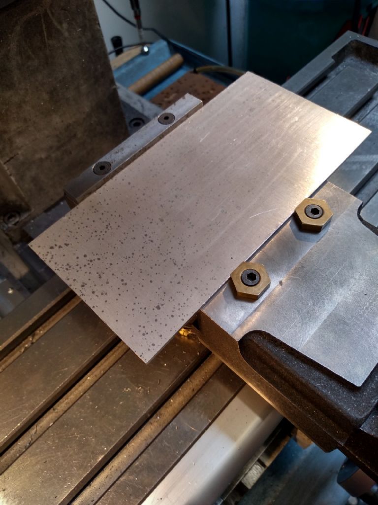

      Here's a bit of plate destined to be a panel for an electronics enclosure clamped ready for one side to be squared off.

            As the top of the moving jaw is machined flat, you could drill and tap some extra holes for the Mite-E-Bites further back to hold larger plates. You would have to remember to avoid drilling the vice by mistake.

              That's the plan, when required.

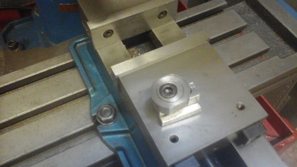

                              I made these clamps recently that also work on the eccentric principle. Feels strange that they work so well, but they certainly do – the clamping force is huge and the friction in the eccentric stops them lifting when tightened.

                                      Hi Bazyle – for the eccentric screw I used M10 cap heads turned down to 13.5mm with a 1mm eccentricity (at Centre line). They are parallel.

                                        Is the location of the maximum eccentricity relative to the thread important in getting the thing to lock?
                                        #482707
                                        Fatgadgi
                                          @fatgadgi
                                          Hi John – no, the head of the screw doesn’t actually clamp in the downwards direction, just uses friction.
