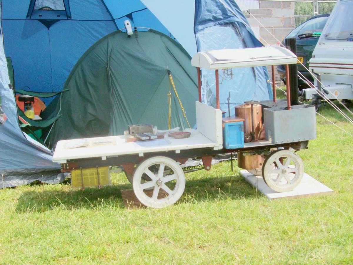

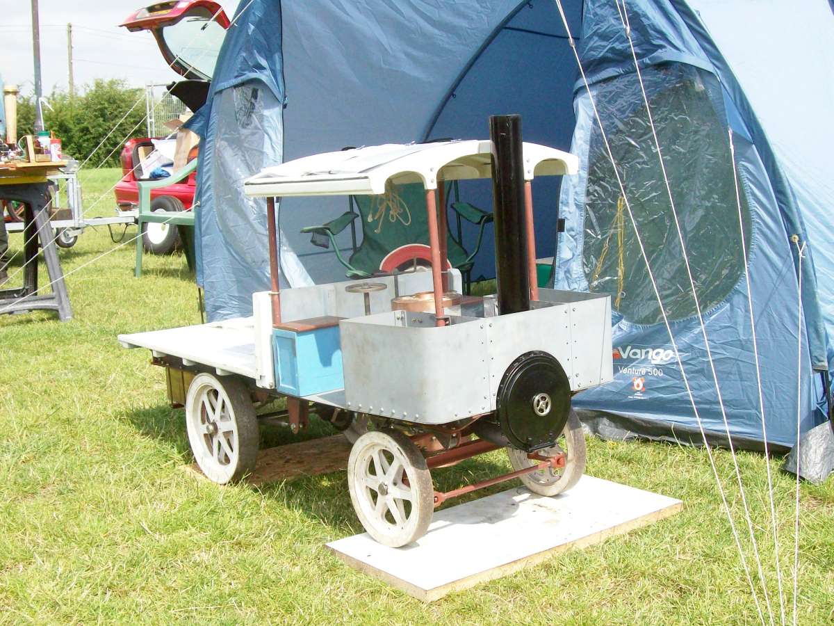

      This is the vehicle exhibited some years ago, with one workshop move (house included) in between; with little to show extra since apart from various engine components, boiler fittings and a lot of re-making. Yes the chimney is faithful to original! I copied the canopy, apparently an optional-extra, from the history-magazine photograph that “inspired” my whole madness – last Century.
      The engine stands behind the boiler, between the seats, with as much below as above the chassis top.
      The whole model is about five feet long by two wide.

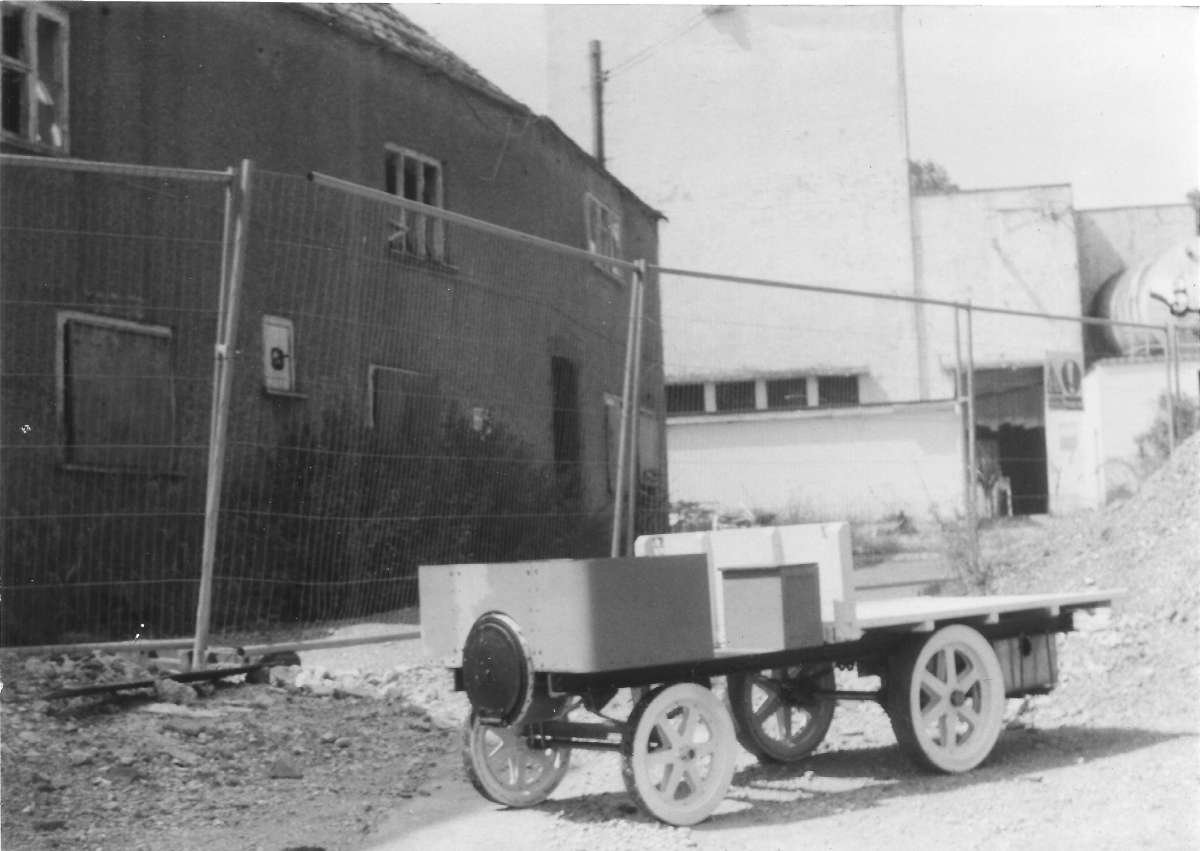

                In my photograph below, she poses at an earlier stage outside the sad ruins of her ancestral home in Bourton, North Dorset; and merely yards from where the originals posed for theirs. The building on the left is in some shots. The site is now a housing-estate, I believe.
                When I embarked on the “learning” hardly anyone had heard of E.S. Hindley & Sons and their wide range of products, including several years of building steam-wagons. There are a few preserved Hindley stationary engines and other bits and pieces, but no wagons.
                Since then a member of Taunton MES has built the same thing to about the same scale, in a fraction of the time I have taken: a miniature Hindley “Light Delivery Van”(LDV). I saw it on static display but not in steam.
                Further still, the professional preservation-engineer Richard “Turbo” Vincent has built a full-size replica to commission. I have not been able to view this but I have some photos of it by someone else, taken at the GDSF. Mr. Vincent thought its front wheels may be genuine Hindley: OEM yet!
                I knew both builders had faced the same frustrating lack of detailed information, let alone drawings, of these extinct vehicles. At least the replica photographs answered a few questions.
                I was told someone who joined my own model-engineering society has or had a miniature Hindley, but I never met him. I don’t think he was a regular member nor for long. I have no idea if he had built the wagon, so that would be the second already existing, or if it was the Taunton one.
                By then I had gone so far that it seemed wiser to keep going in my own sweet way, until only a few days ago.
