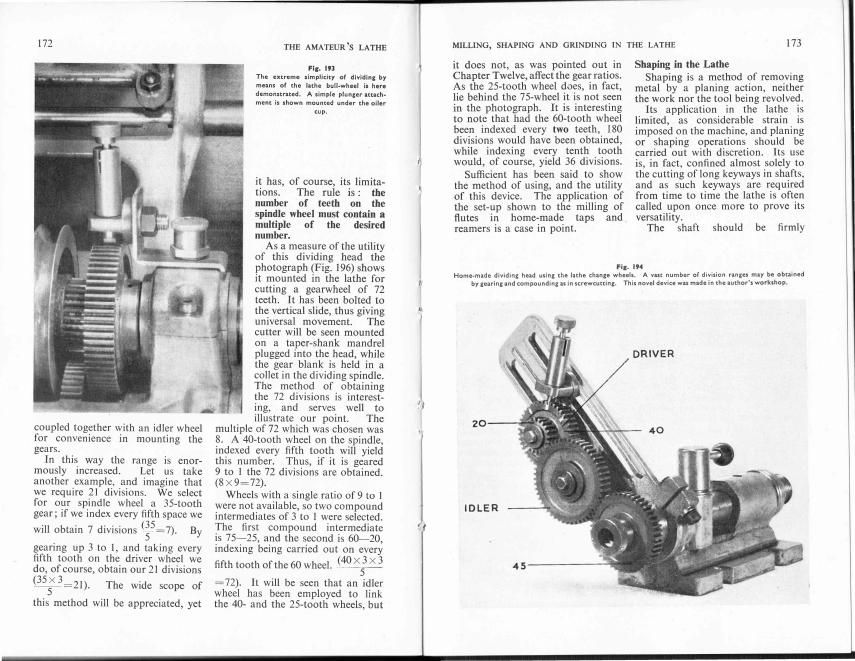

                            It gets worse…
                            I wanted to drill holes or cut teeth for weird tooth numbers with limited gearsets using the banjo/headstock as a division tool and I may have cracked it
                            A 59 tooth gear with 0.0002 error
                            Gearset 20 25 30 35 40 45 46 50 55 60 63 65
                            The first gear, 20, is irrelevant, all that matters is if it's moved 59 times and the compund set moves the final gear, (which in case one is a 46tooth) 59 times AND completes a proper 360 degree revolution then we have a winnah
                            As usual my outputs are jumbled up devil
                            0.999856 n[20.000000] n[30.000000] n[46.000000] n[55.000000] n[46.000000] n[46.000000]
                            Soooo…
                            the 20 is irrelevant, then 46in 30out and 46in 55out to a final spindle cog of 46
                            59 clicks on the detente is (using the 20 or anything you want as an idler)
                            (59/46)*30= 38.478 clicks
                            (38.478/46)*55=46.0066 clicks on a 46.0000 toothed final gear
                            Full results below (edited to two gearsets)
                            0.999856 n[20.000000] n[55.000000] n[46.000000] n[30.000000] n[46.000000] n[46.000000]
                            Might be wrong of course but it's looking good so far
                            Edited By Ady1 on 16/10/2015 16:43:22
                            #208111
                            John Stevenson 1
                              @johnstevenson1
                              How can the PRIME driver be irrelevant ??
                              Idlers yes, drivers and driven, no
                              #208119
                              Ady1
                                @ady1
                                It's a 20 pretending to be a 59
                                It's all kosher, honest guv, on my life.
                                My initial interest was for the Westbury dividing head which fits onto the milling slide/saddle of your lathe
                                The first cog is only an idler in this case, then 2X compound gears and the final spindle gear
                                Can't remember which book it was in… Hemingway do a kit
                                edit:
                                If it is relevant, then swap the 20 for a 46 and do 59 divisions
                                edit2 It wasn't westbury, it was the sparey one I was thinking of, in "the amateurs lathe"
                                Edited By Ady1 on 16/10/2015 17:54:12
