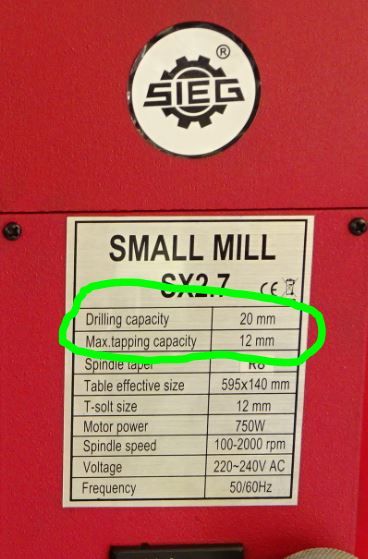

                                                    #453005
                                                      Posted by not done it yet on 19/02/2020 12:03:09:
                                                      Do the purveyors of these machines point this out to prospective purchasers? NO, THEY DON’T! There is inter-company competition to attract the buyers with as much cheap hype as possible, this being just one facet.
                                                      The fact they say "max drilling capacity 16mm" is quite clearly giving the limit of what the machine should be expected to do.
                                                      Other suppliers have ratings such as Craft/hobby/trade or model engineer/engineer and a lot state hobby use only or non production runs etc.
                                                      Sieg know that some people won't read the instructions so also put the max capacity on the front of the mills head, you can't point it out much more obviously than this. Unfortunately there are still those who know better and that is why we tend to get more posts by people with problems with their machines than by those happy with then and that distorts many peoples views of these machines
                                                      I would say Warco list Input to the motor not output from what has been said here over the years.
                                                      Still like to know what lathe you were using?
                                                      And once again I will point out that the WM18 is a mill as you still seem to think it is a lathe.
                                                      Edited By JasonB on 19/02/2020 12:30:30
