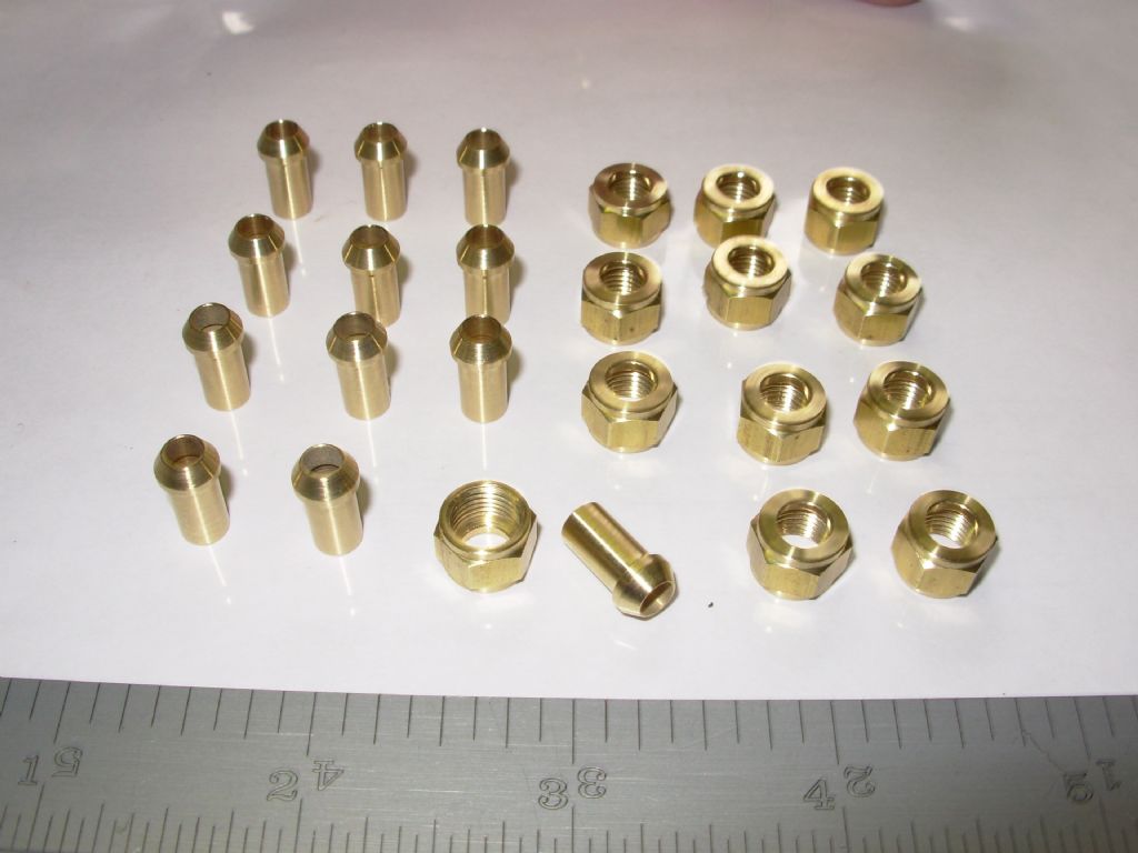

                      #349917
                      David Wasson
                        @davidwasson11489
                        Ricardo,
                        Yes, these sort of "errors" show up all the time. So, you get to decide what size pipe to use and how the fittings will be made to accommodate the pipe. I have made my own "standard" fittings for about four different sizes of pipe. I have made my self a chart for all the different dimensions of these fittings and also make sure I always have a physical sample of each cone and nut. This allows me to check for fit in a particular location. If you have a lathe, and just a little tooling, you will discover that it is actually quicker to make you own fittings than to order them and wait for them to arrive. I also never just make one of an item, I usually make a minimum of four each. Here's the last batch of cones and nuts I made for my loco. These were for 3/16" tube.dscn1402.jpg
