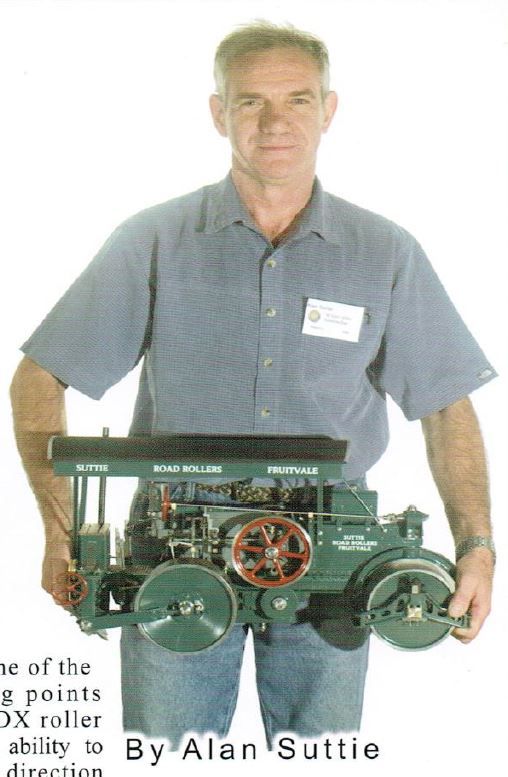

                  Roger, I've not seen one running either in the flesh or on video, it's a model you see very few of, infact you don't see many rollers of any description.
                  The nicest one I have seen was made by Alan Suttie in the US and was the centre fold in an issue of MEB mag a few years back, as you can see it is quite small
